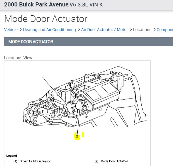

Air does not blow out of center vent
CORKYGEE66
  • 2000 BUICK PARK AVENUE
  • 6 CYL
  • 2WD
  • 120,000 MILES
However, it does blow out from the windshield and from the bottom.
Thursday, June 30th, 2022 AT 1:19 AM
SQM
  • 6,383 POSTS

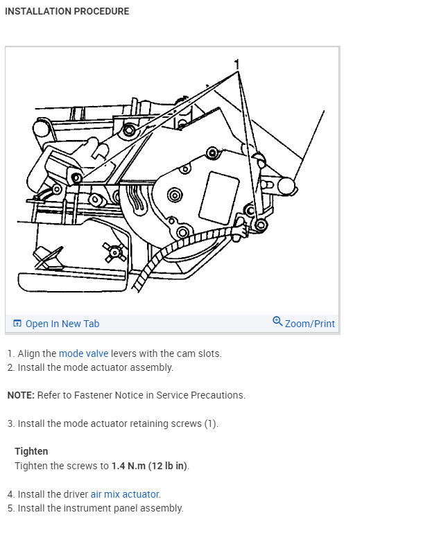

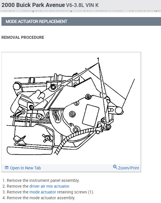

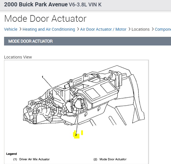

It sounds like you have a faulty mode door actuator.
The mode actuator controls where the air will flow from. It can go bad and get stuck in one position.
The mode door actuator is located on the HVAC box behind the dash.
https://www.2carpros.com/articles/low-or-no-air-flow-from-vents
I have attached diagrams below for your reference.
Let me know of any questions.
