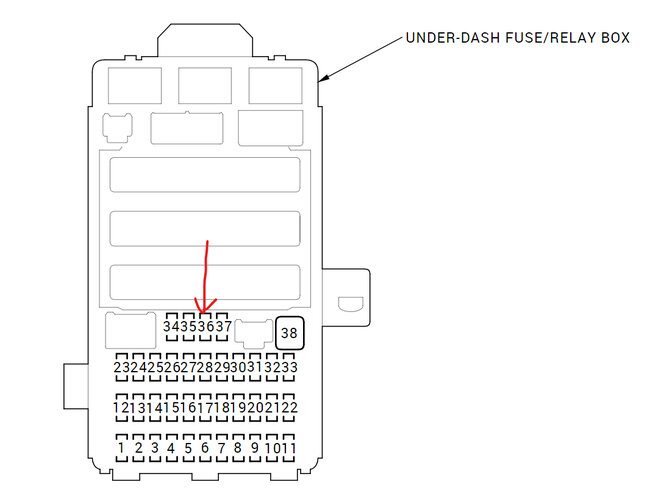

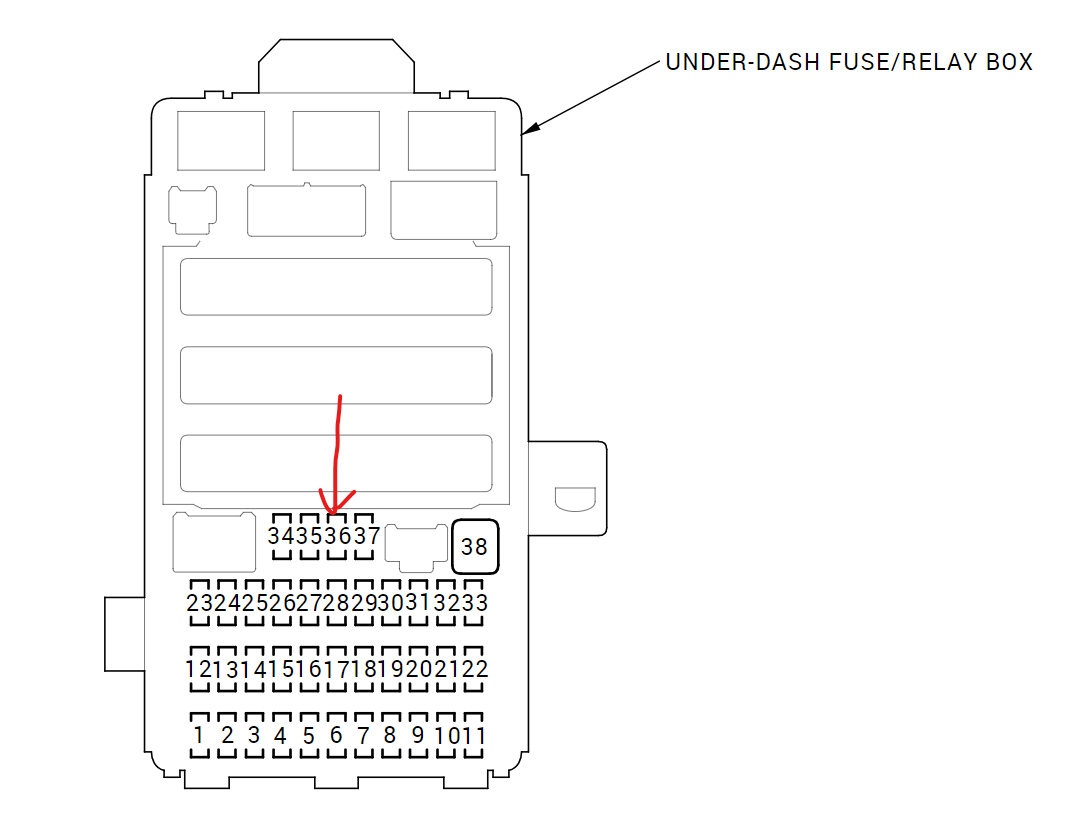

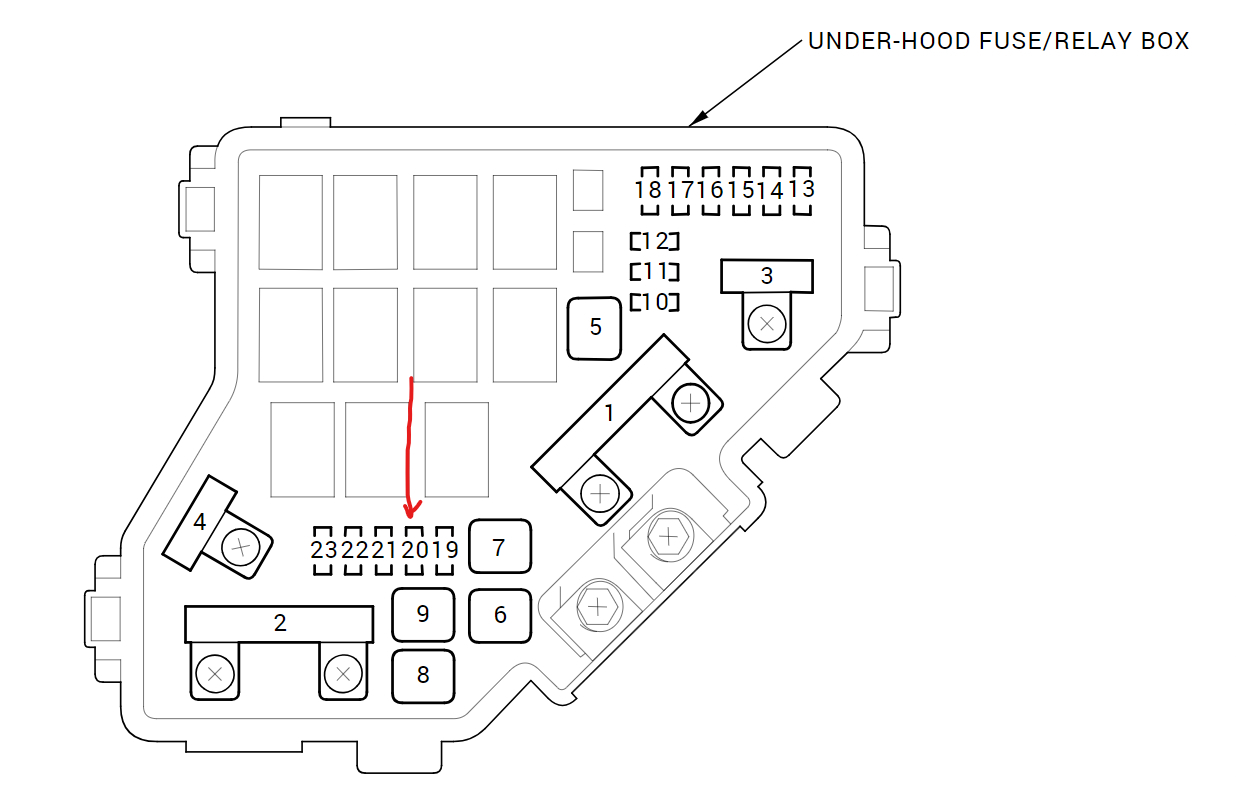

Let's check fuse # 20 7.5-amp fuse in the under-hood fuse panel and fuse #36 in the fuse panel inside the car. Here is a guide that will help and the fuse locations below.
If the system has refrigerant but the compressor is not tuning on, we need to check the red/white wire going to the compressor clutch to test for power while the system is on.
Here is a guide to help:
Be careful working around the engine when it is running.
Please go over this video as well:
https://youtu.be/4UjfQKvrB6Y?si=fG-BVtXS_1BZGV75
Check out the images (below). Let us know how it goes.
