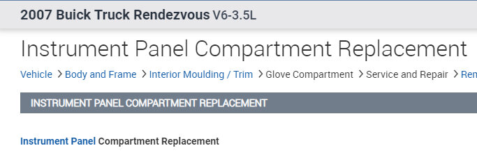

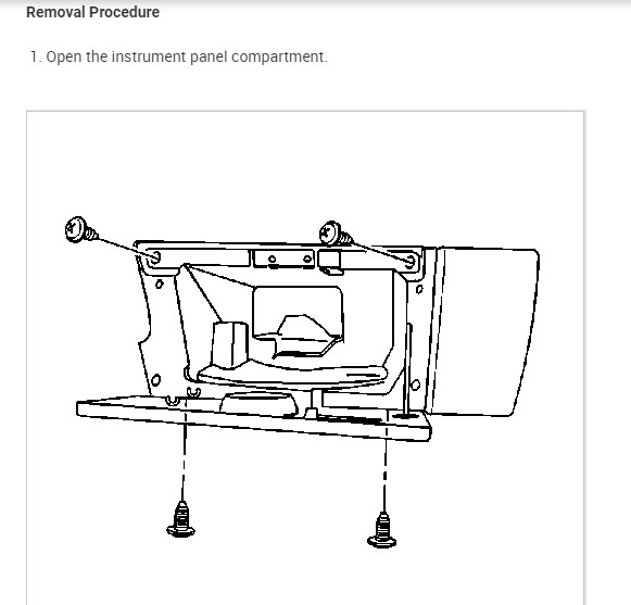

As far as the actuator, there are two. One for the driver's side and one for the passenger's side. Did you lose A/C on both at the same time? That would be odd for both to fail. Also, do you have automatic or manual climate control?
When you have the A/C turned on and the engine running, do you hear the compressor clutch engage (a click)?
As far as the procedure, you should be able to get it by just removing the instrument panel compartment. I attached the directions below.
