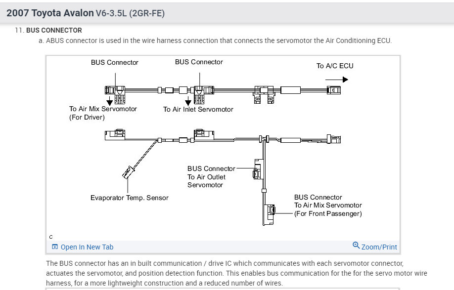

I'm using my friend's car listed above. Two weeks ago, the A/C would not create cold air. When I push the A/C button the green light does not come on. The A/C light comes on when Auto is pushed. It blows hot/warm air on the driver's side and on the passenger's side it is always around 10 degrees below the current air temperature. So, at 90 degrees it's blowing about 80. The gauges show Freon to be normal. I do see the clutch engaging some. Any suggestions?

There are a couple of possibilities. When you say the air temperature is different on the left and right sides, that leads me to think there is an issue with a blend air actuator.

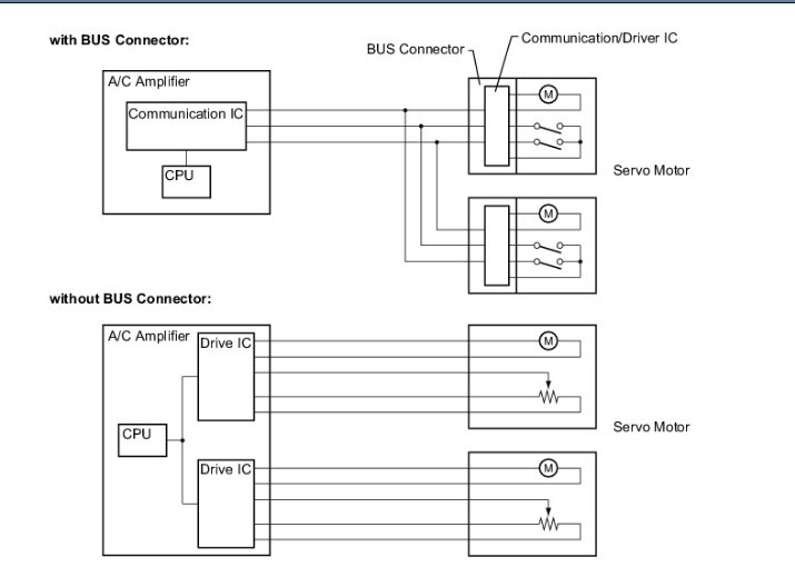

Do you have dual climate control? In other words, you can control the temps on both sides.
There is an A/C amplifier that controls the air mix motors which in turn control the temperature entering the vehicle. See pics below.
Because this is a difficult call, I would suggest having the can-bus scanned to see if there is a diagnostic trouble code stored in the HVAC module. I suggest this because the amplifier and servo motors are controlled via a wiring bus. It's easy to be wrong and spend money and fix nothing. LOL
