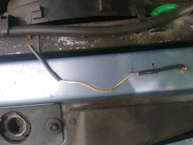

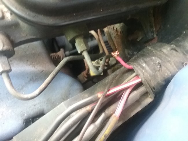

Here are images you asked about first one is the fusible link wire that was cut. 2nd one is location where wire was. Could I solder wire back to where it was? I tried an A/C relay no go. The fuse looks good in fuse panel under dash. any other ideas other fuses? Like i said defroster blows okay but any other part of control for circulation not working, A/C not working at all. Dash switch problem maybe ?

I looked at the pics. The second one shows a disconnected wire. Did the person reconnect power to that wire at a different location?

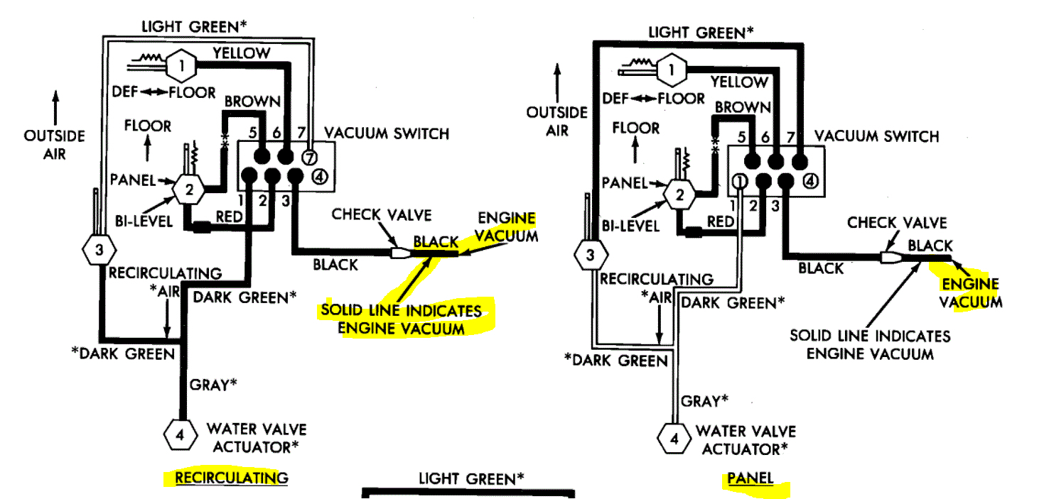

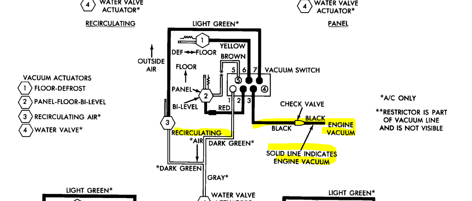

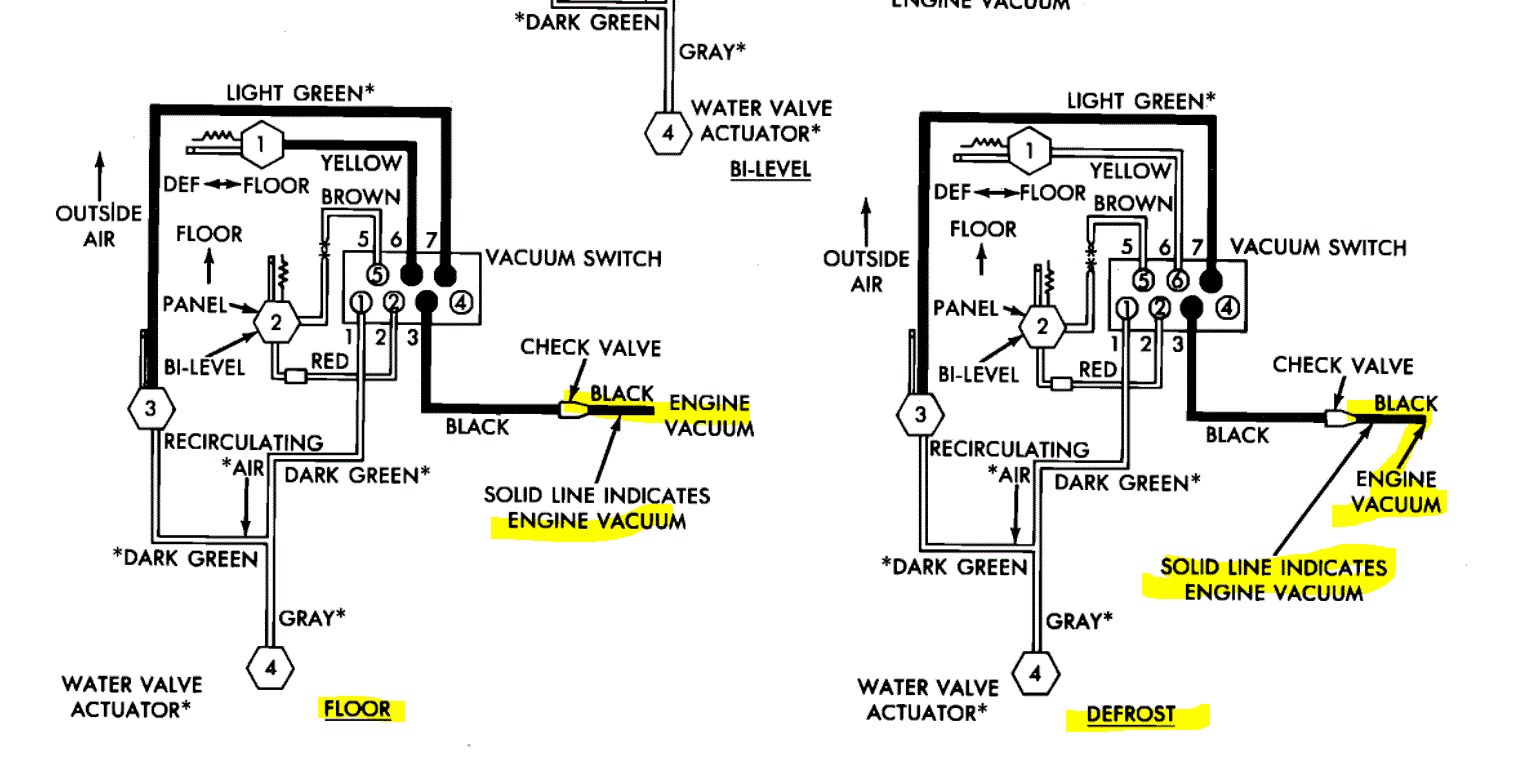

Also, I need to better understand something. First, am I correct in understanding that you are unable to change the airflow direction? I ask because that system (mode door actuator) is controlled by engine vacuum. So, the person may have broken the vacuum supply to the control unit in the vehicle.
Also, when you say the A/C doesn't work at all, by chance, are you hearing the A/C compressor actuate? Again, the air temp door (blend air door) that controls the temp of air entering the vehicle is actuated by engine vacuum, so it could be the same issue. If there is no engine vacuum making it to the right places, that will prevent things from operating properly. In addition, the defrost position is a default area in the event this happens.
I attached a couple of pics below showing the vacuum schematics. If you remove the control unit, locate the black hose and check to see if there is engine vacuum to it when the engine is running.

Hey Joe, your first question. The fusible link wire was replaced and attached to same place it was taken from. I found the vacuum leak a disconnected hose fell down on to transmission. the heater blows hot now still no A/C does not sound like it's kicking in. i don't have a electrical checker but did pull the A/C fuse under dash looks okay. any other ideas ? Thanks, John

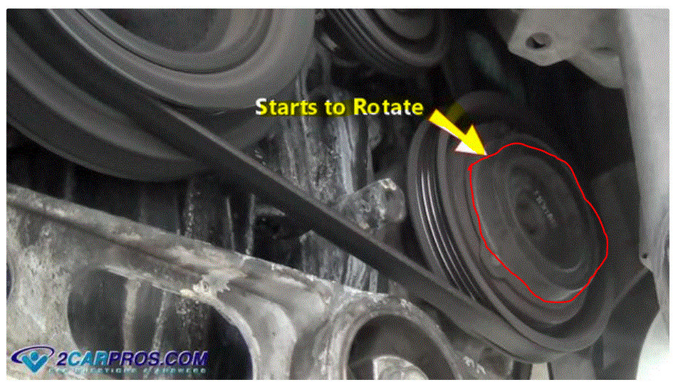

Next, we need to check if the A/C compressor is engaging. On the front of the compressor is the clutch and pulley. The pulley itself turns anytime the engine is running. When the A/C turns on, the center of that assembly, the clutch, will click and start turning as well. Have a helper turn the A/C on and off to see if that is happening.
Also, take a look through this link:
I attached a pic below from the aforementioned link. I circled the center. That is the clutch that will start spinning when the A/C is turned on.
I need to know if that is working. If it is, we have an issue with either low pressure or a blend air door. If it doesn't spin, we will need to check Freon and then wiring.

The vacuum line did take care of the airflow problem. will get back to you about A/C clutch. Thanks, John

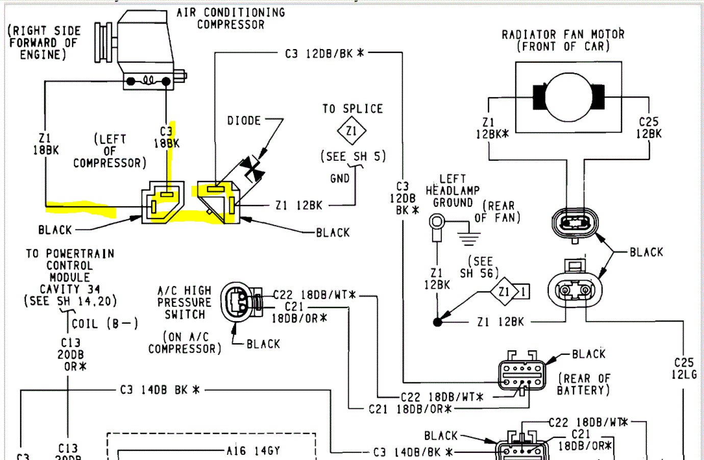

the compressor seems to be spinning okay, but the center you have circled isn't. i used to be able to hear it click when it engaged.
Sep 1, 2021 at 8:41 AM
  • 110,244 POSTS

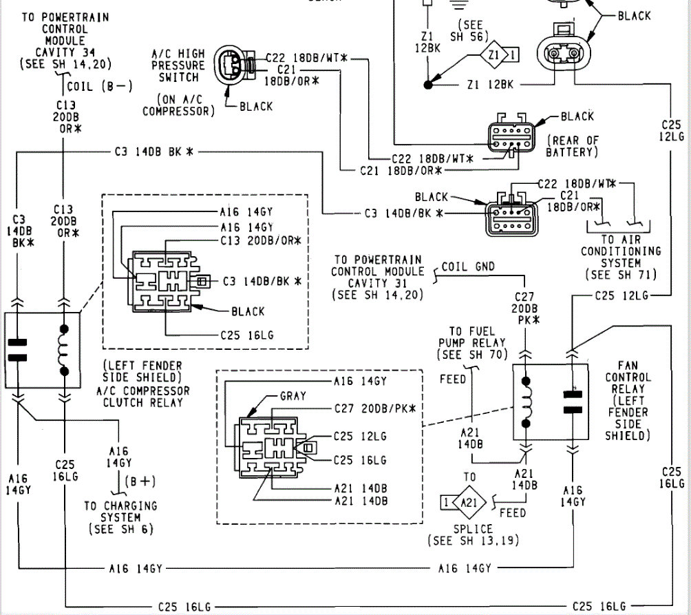

Okay, then either we are not getting power to the clutch, the Freon is too low for it to turn on, or the clutch is bad.
First, we need to check for power at the compressor itself. I attached a schematic below. It is indicating both wires. The schematic is an original schematic from Chrysler. They are difficult to follow at times, but if I'm reading it correctly, the one showing C3 should be power and Z1 is ground. Disconnect the connector and check C3 for voltage with the system on. If there is power, shut the system down and check the Z1 pin for continuity to ground.
Here is a link that you may find helpful:
Let me know what you find. Also, make sure nothing is disconnected from the original repair.
See pics below. Note: I had to cut the schematic in half to make them readable for you. I did overlap them so you can follow from one to the next.
