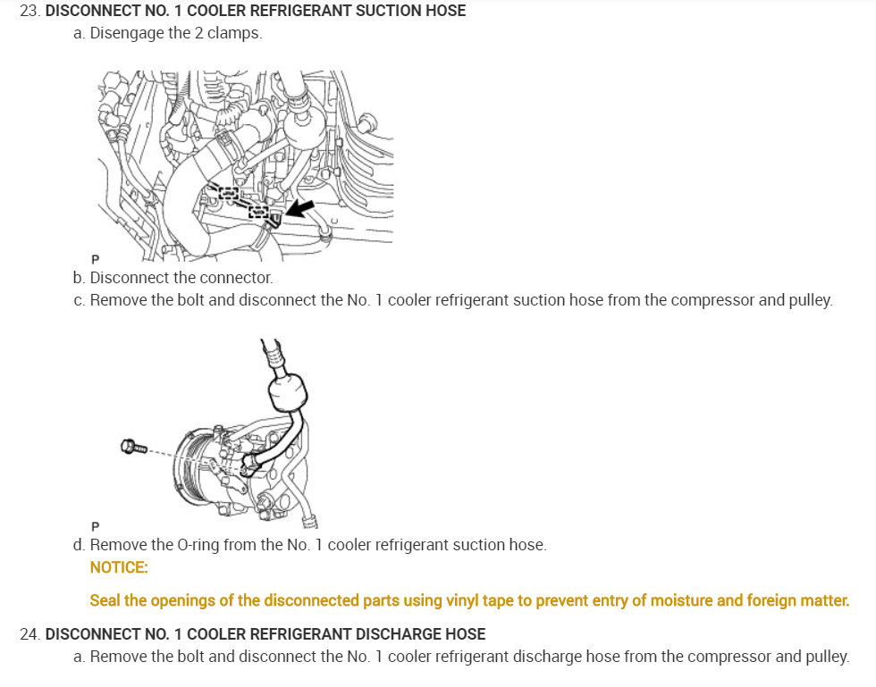

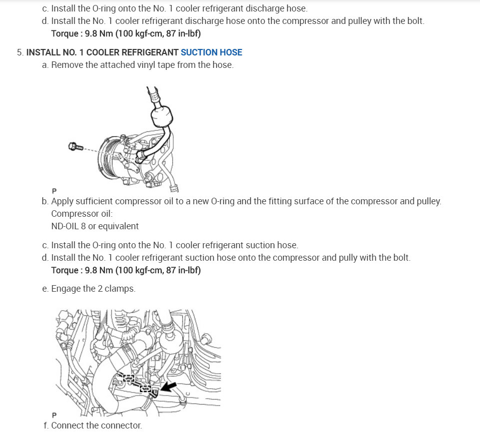

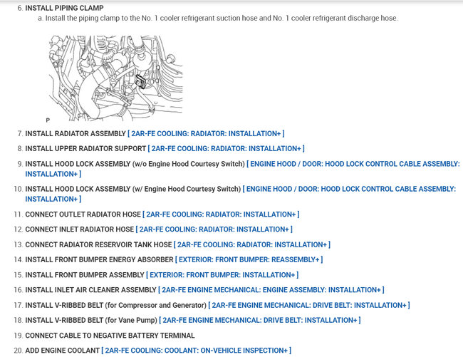

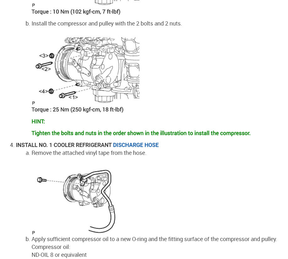

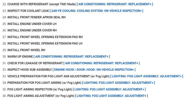

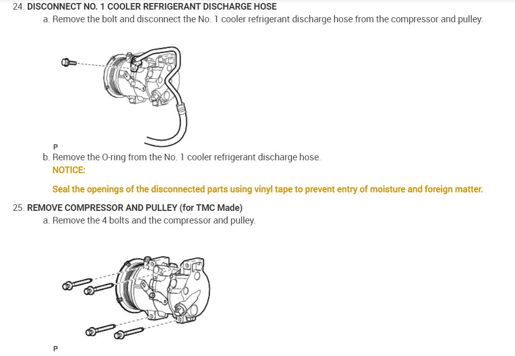

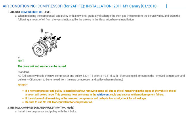

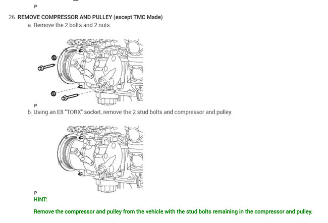

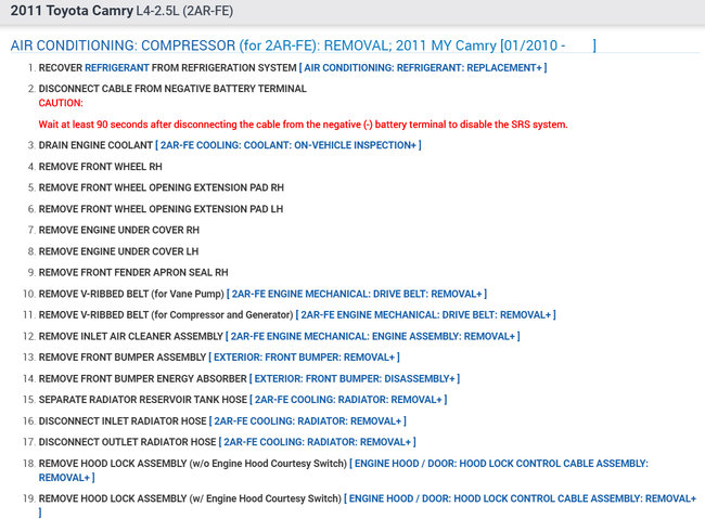

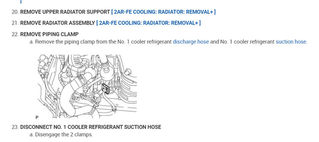

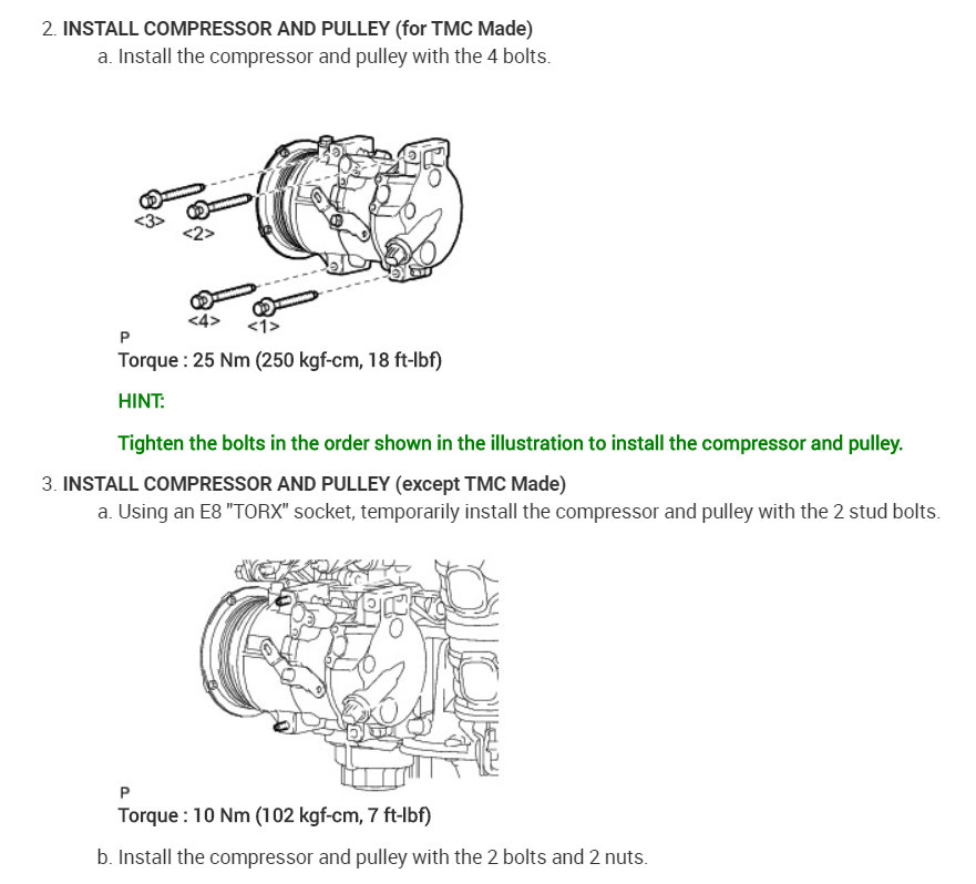

If the system is full you could have a compressor that is going out. this guide will help with diagrams below to show you how on your car:
https://www.2carpros.com/articles/replace-air-conditioner-compressor
and
This video will show you how to fill the system:
https://youtu.be/uZrQCGwXfek
Nov 27, 2020 at 12:24 AM (Merged)
