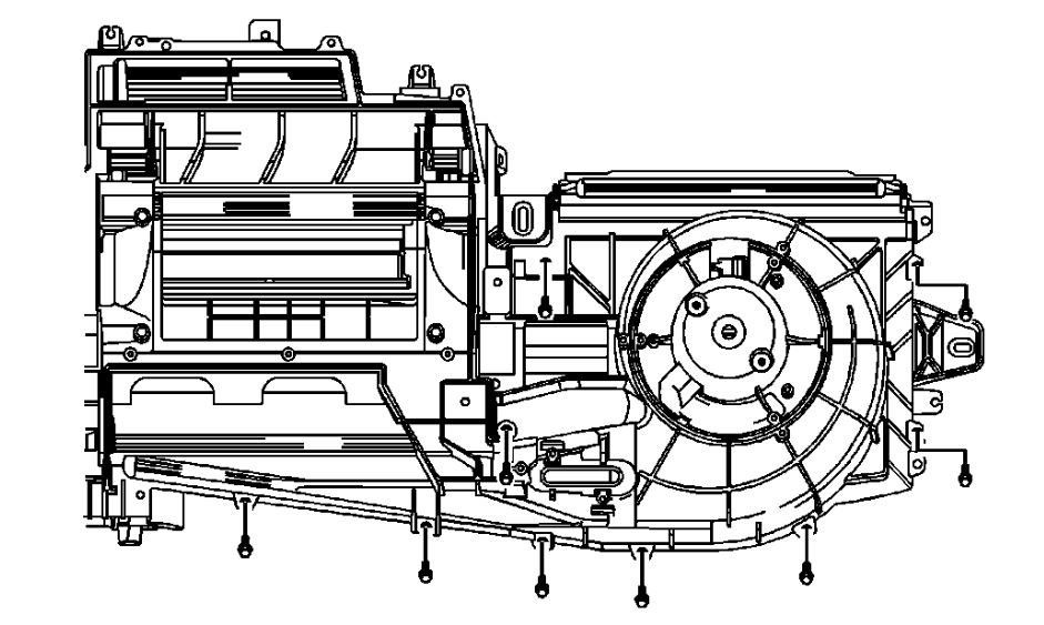

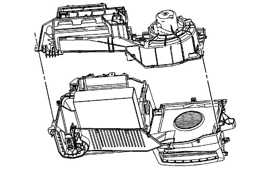

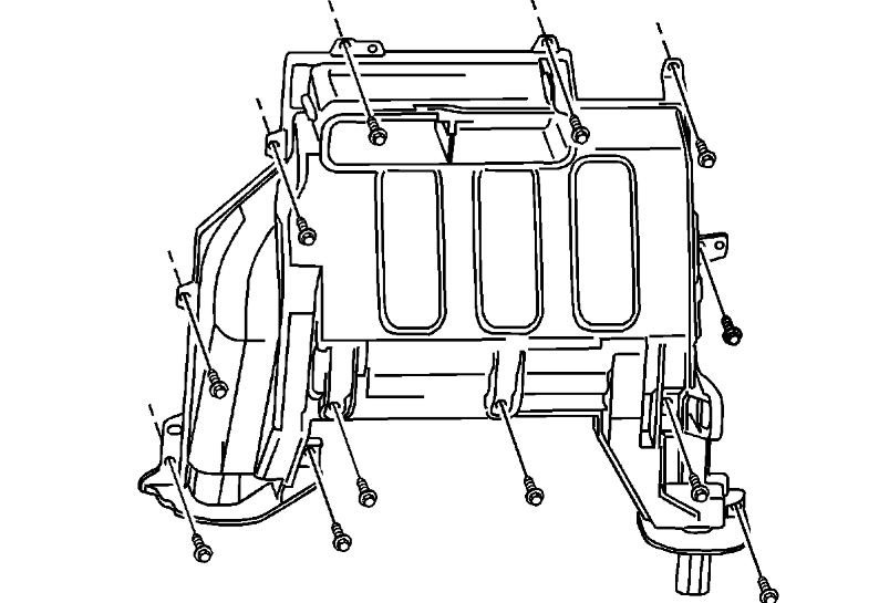

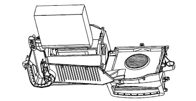

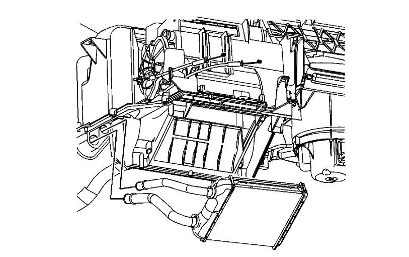

Good afternoon,
Yes, it could be the evaporator leaking.
I would let the car run with the AC working and look for the water coming out of the evaporator to the floor. Then use a LED light and shine it into the water. If it is leaking, it will turn yellow or green in the water.
