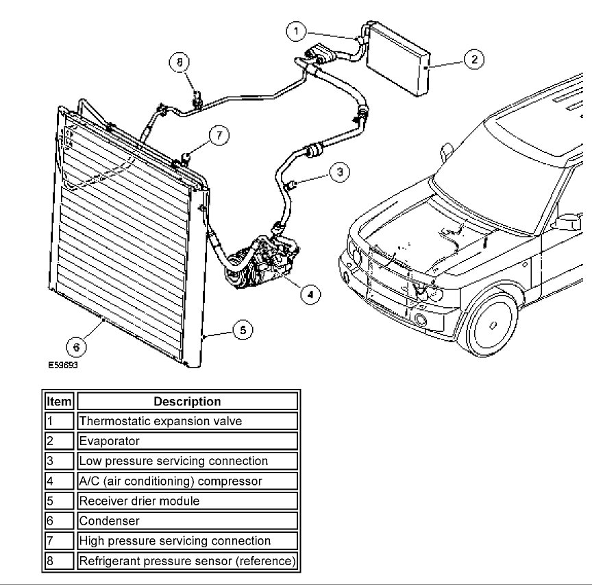

First thing will be to check the ref. pressure sensor. If the system sat for a while without pressure it may have stuck or failed. It is item 7 on the pic. It should have 5 volts to one wire and 0-5 volts that changes with pressure on the other. With a full system charge you shouldn't see either 0 or 5 volts on that wire if the sensor is good, it should be somewhere between them.

Also, I do not see any wires on item 7, just the valve. What am I missing?

In the picture it was just to show you the location of the sensor. On your vehicle that sensor should have a connector on it with wires, If it does not have the wires that is probably the problem, search around and the connector should be there someplace.

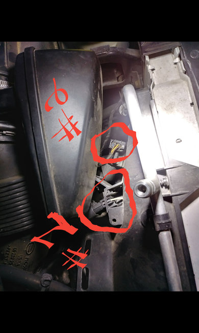

These are the only two connectors that are anywhere close to that valve. Would one of those likely be it?
(I removed the screw top so the valve would be visible)

The valve you show there should be one of the service valves, where you connect gauges or an AC machine up to test, discharge,recharge the system. The pressure switch should be in the line going from the condenser core (near radiator) to the evaporator core inside the car. Follow the line and you should find it.

Follow the other line that goes down the passenger side. The side you show in the video is the low pressure line. The sensor is in the high pressure line.
