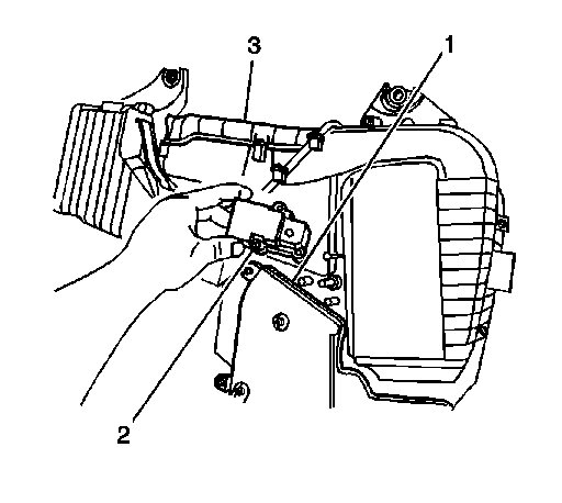

So I bought this vehicle and it is honestly a good vehicle besides the air conditioning problem. First off I replaced the water pump, thermostat, clutch fan, rear A/C housing as it was damaged, made sure the A/C is properly charged, and I am still running into the exact same problem. The front passenger A/C gets cold and even colder while driving. The rear A/C is warm unless it is night time then it is cooler some but it gets colder when I am driving. The front driver side A/C is hot no matter what and hotter if I put the blend door to hot. I am assuming the driver side blend door actuator is not functioning properly so I ordered a new one to try and trouble shoot that. Blower on the rear A/C is functioning properly as well. Help!

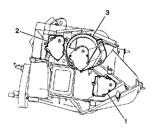

First, it does sound like the blend air door actuator is not working on the left. Here is a link that shows how to replace one in general:
Here are the directions specific to your vehicle. The attached pics correlate with the directions.
2005 Chevy Truck Trailblazer 4WD L6-4.2L VIN S
Air Temperature Actuator - Left
Vehicle Heating and Air Conditioning Air Door Actuator / Motor Service and Repair Procedures HVAC System - Manual Air Temperature Actuator - Left
AIR TEMPERATURE ACTUATOR - LEFT
AIR TEMPERATURE ACTUATOR REPLACEMENT - LEFT
REMOVAL PROCEDURE
1. Remove the I/P carrier.
pic 1
2. Remove the left side air temperature actuator (1) retaining screws.
3. Disconnect the left side air temperature actuator electrical connector.
4. Remove the left side air temperature actuator.
INSTALLATION PROCEDURE
pic 2
1. Install the left side air temperature actuator (1).
2. Install the left side air temperature actuator retaining screws.
Tighten the screws to 1.9 N.m (17 lb in).
NOTE: Refer to Fastener Notice in Service Precautions.
3. Connect the electrical connector to the left side air temperature actuator.
4. Install the I/P carrier.
5. Calibrate the air temperature actuator on vehicles equipped with automatic climate control (C68). Refer to Re-Calibrating Actuators (Primary).
