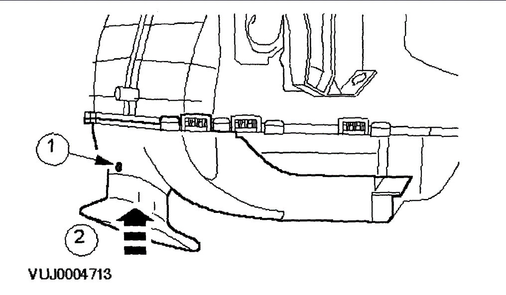

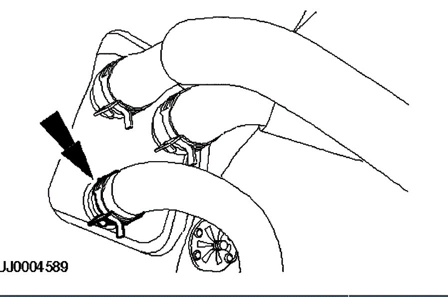

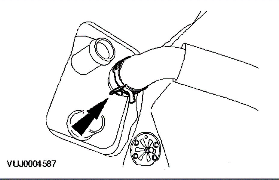

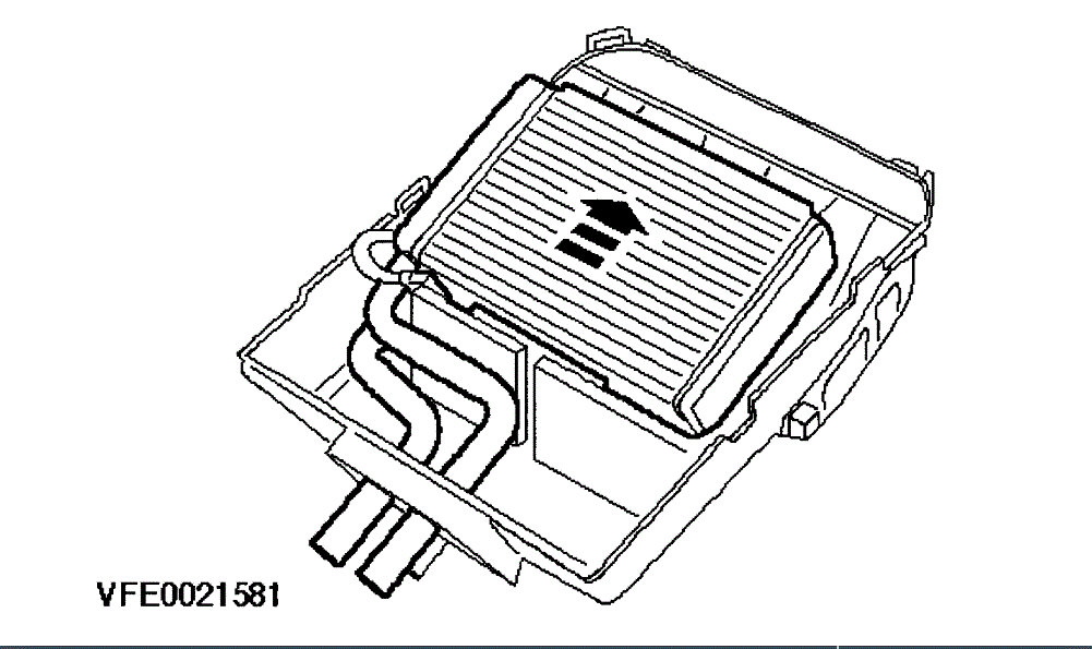

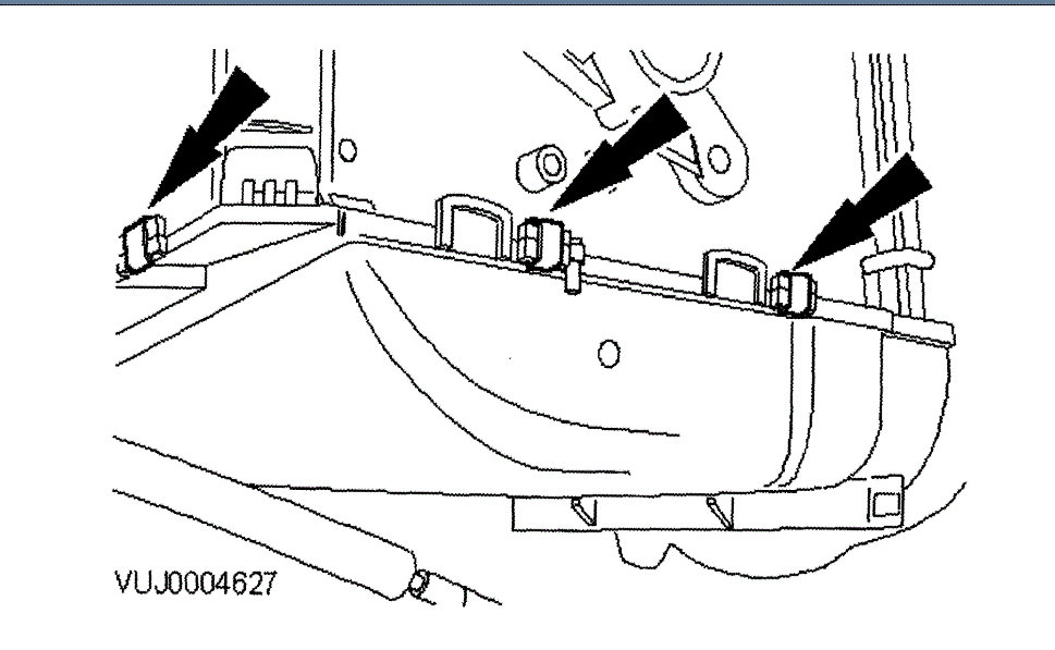

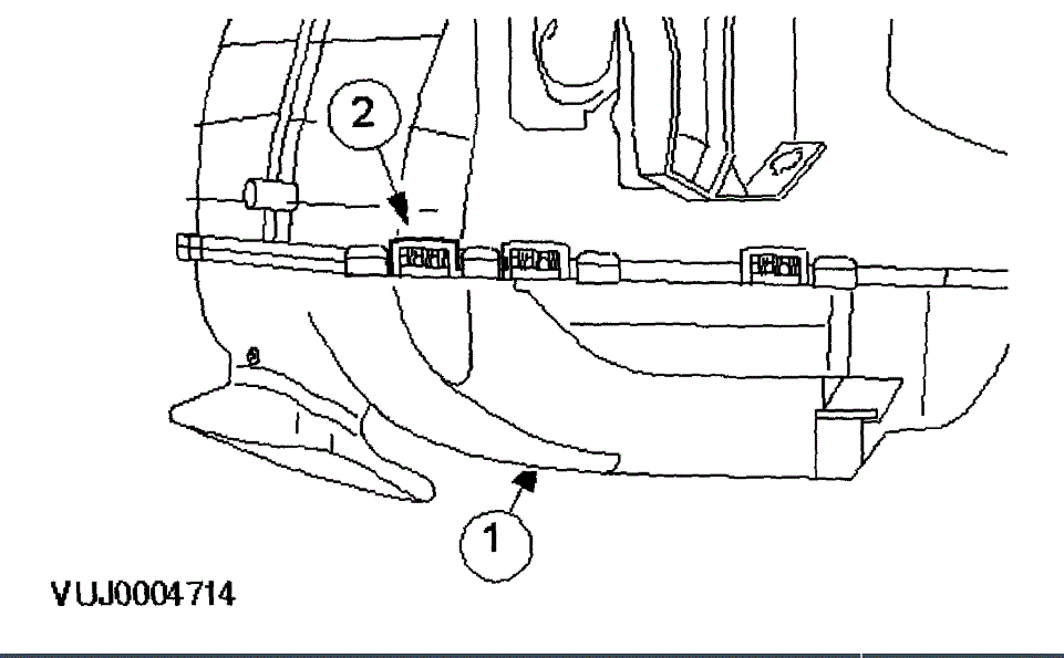

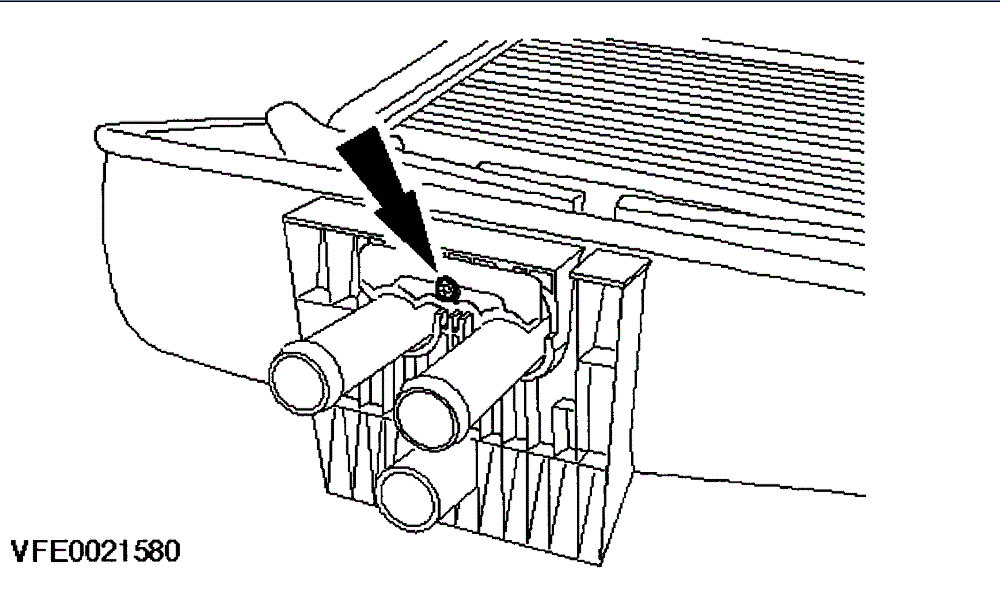

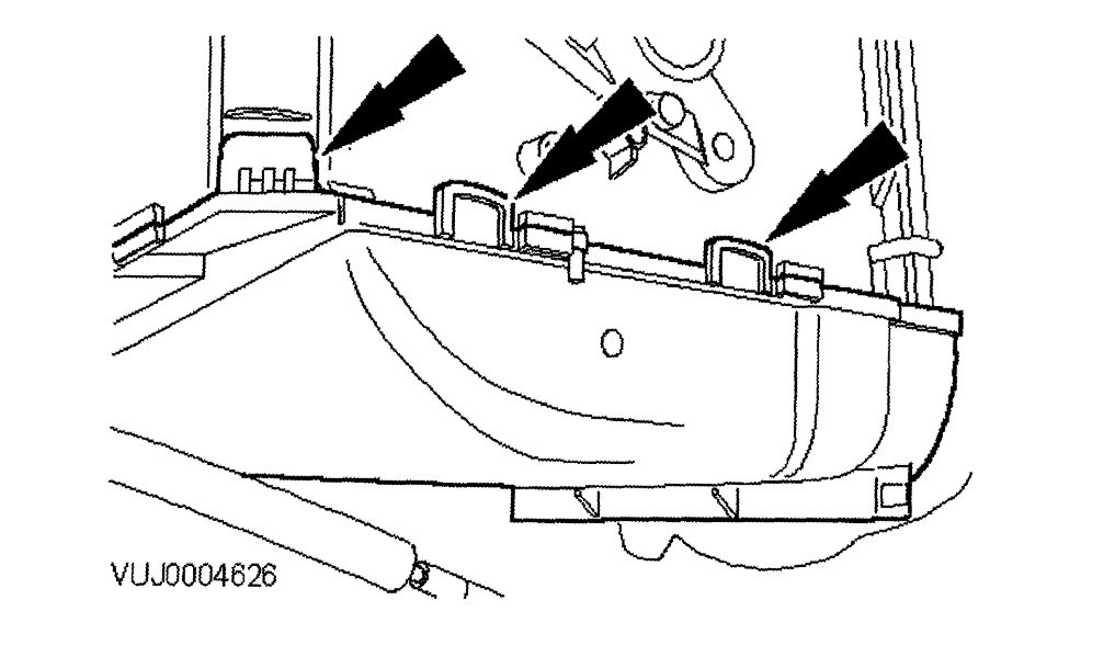

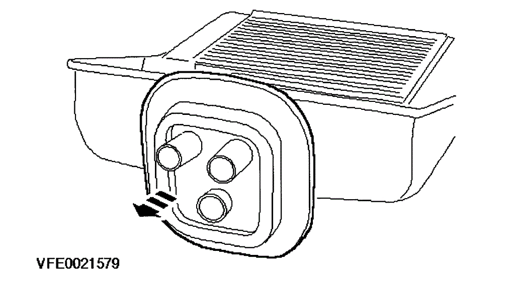

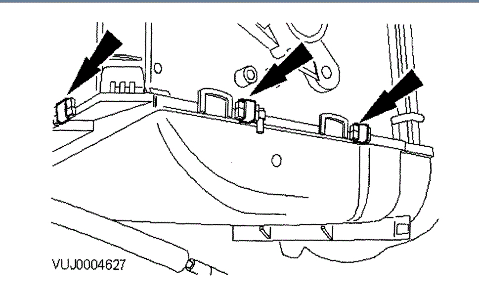

Okay, I attached the procedure below with some pictures. It is very tight under the dash but take your time. Remove the glove box and the heater box is right there.
https://www.2carpros.com/articles/replace-heater-core
https://www.2carpros.com/articles/coolant-flush-and-refill-all-cars
Removal
1. NOTE: If a leak is suspected, the heater core must be leak tested in the vehicle before removal.
Drain the cooling system.
2. Disconnect the drain tube from the heater core.
3. Disconnect the heater hose from the heater core.
4. Disconnect the heater hose from the heater core.
5. Remove the center console.
6. Position the heater core air duct up.
1. Remove the heater core air duct retaining screw.
2. Position the heater core air duct up.
7. Remove the heater core air duct housing.
1. Remove the heater core air duct housing retaining screws.
2. Remove the heater core air duct housing.
Release the retaining tabs.
Right-hand side shown, left-hand side similar.
8. Remove the heater core housing retaining clips.
9. Remove the heater core housing
Release the heater core housing retaining tabs.
10. Remove the seal.
11. Remove the heater core retaining screw.
12. Remove the heater core.
