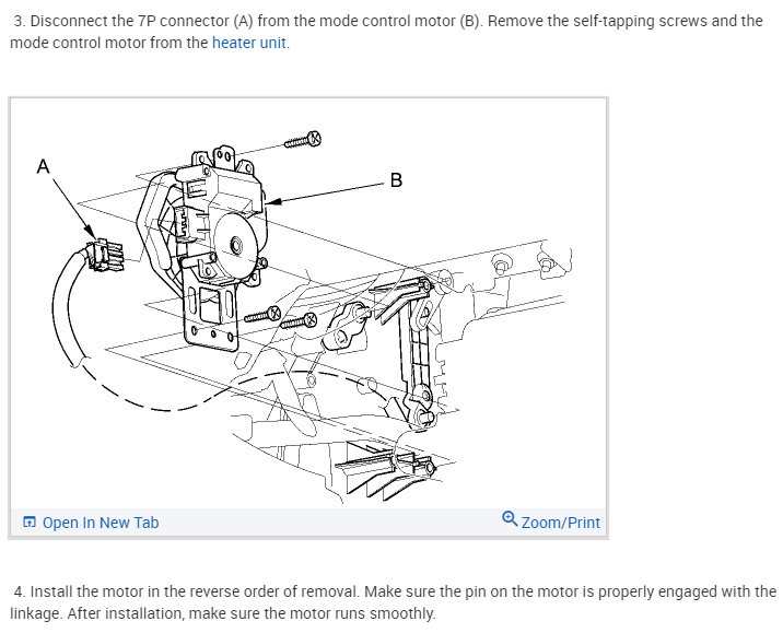

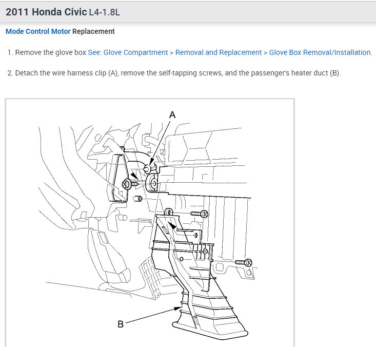

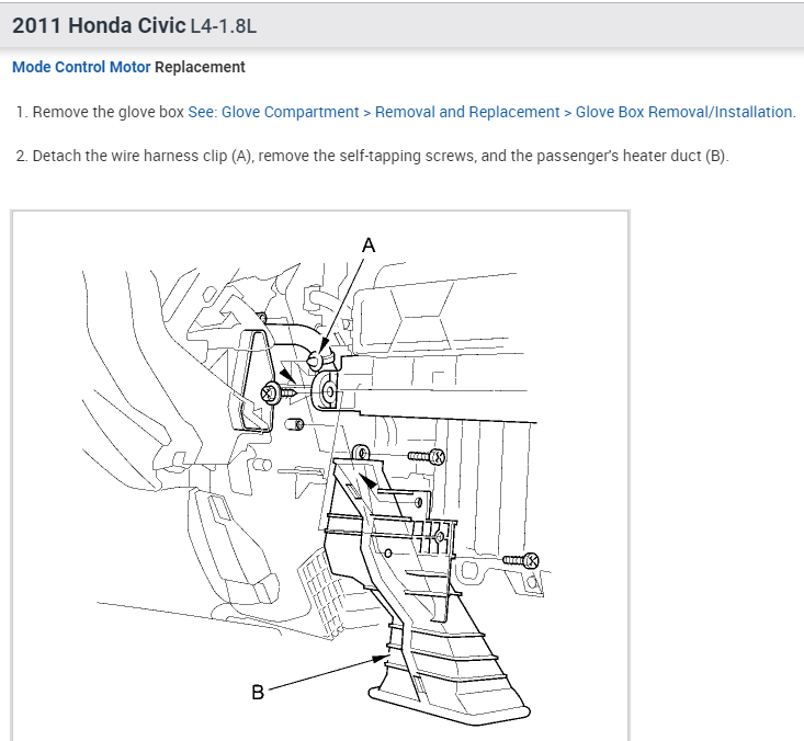

Cannot switch from front to any other zone for the air to flow. Heating and air work fine, rear defrost works fine. Is there a way to tell if there is a short or a issue with the blend door actuator?

It sounds like you're having a problem with the blend/mode door actuator. It's a small electric motor the that controls air flow throughout the ducts in the HVAC box.Here is a tutorial for you to view showing how to replace:
I've attached 2 pictures below as step-by-step instructions for your Civic.Hope this helps and thanks for using 2CarPros.
