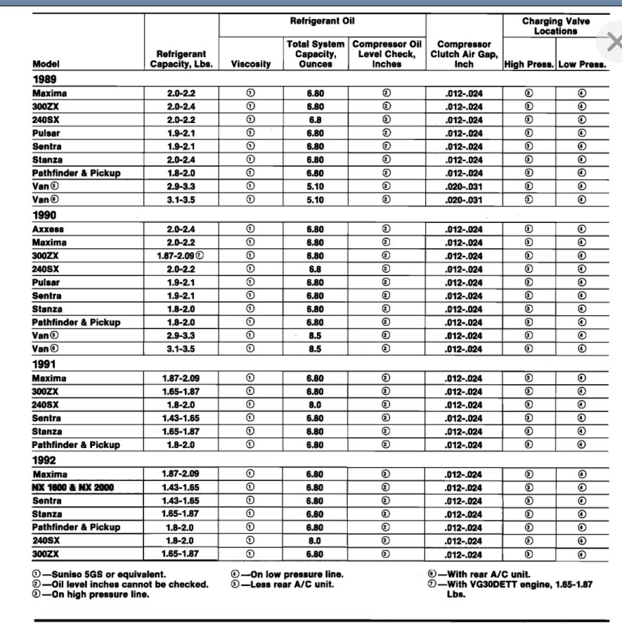

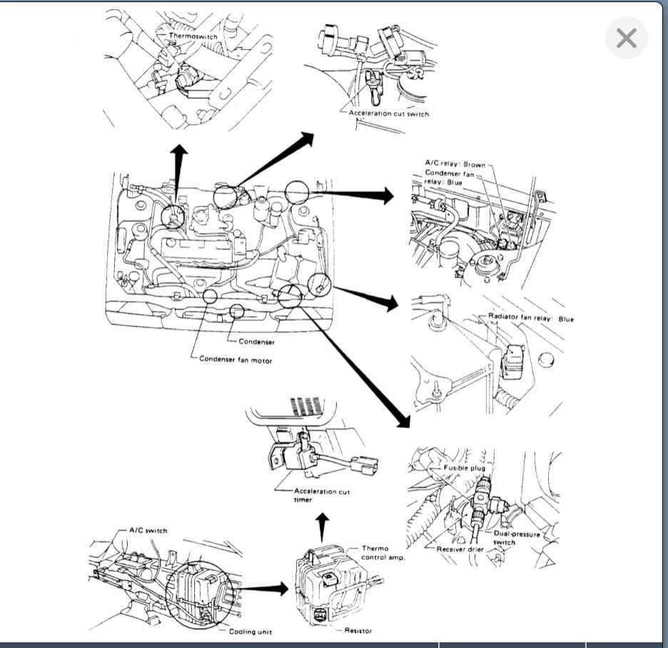

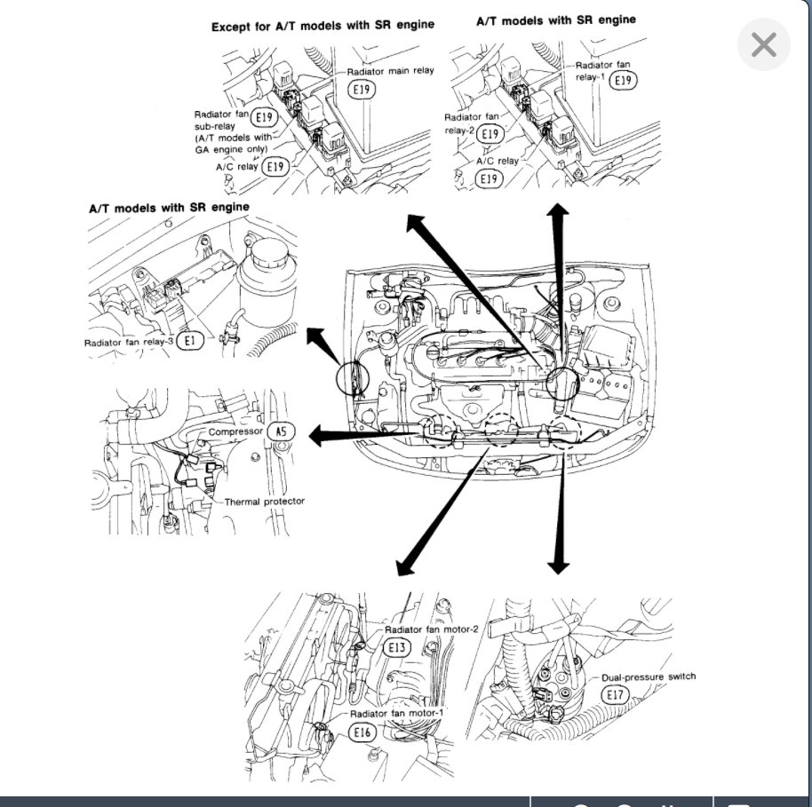

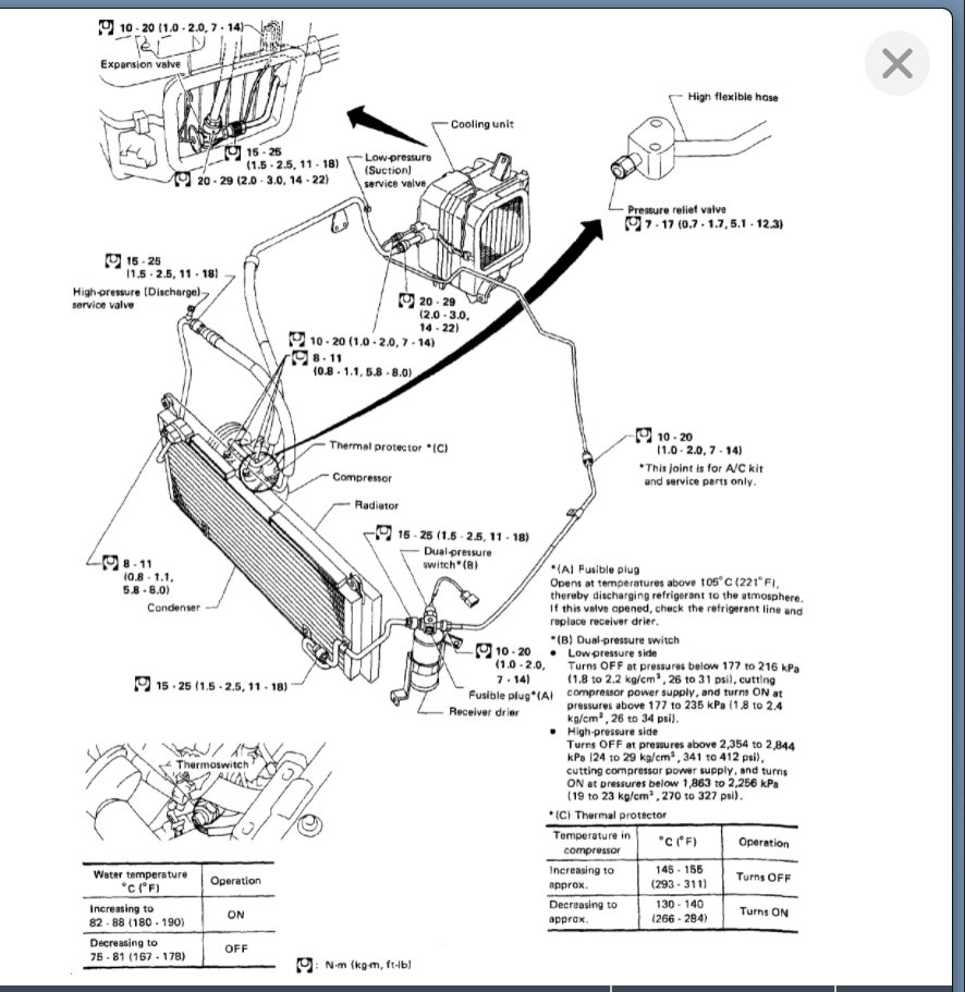

The car I bought was missing lots of parts , I mean very many, long story short. Having problems figuring out what goes where , and I haven't been able to find pictures/videos of the exact car I have so I can't solve it on my own . Trying to get the A/C system pieced together on the car listed above XE model. "Chinese import not American version".
Jun 24, 2021 at 11:40 PM
I am attaching the info on the location of these components but the issue that we may have is that this is a Chinese import vehicle. I am not 100% sure that they are going to be exactly the same as this but the fact that this engine is the same as you vehicle gives me confidence that they are going to be similar.
When you are finished you are going to need to pull it into a vacuum and check for leaks. Here is a guide that will help with this:
Please run through this material and let us know if you have other questions on this. Thanks
