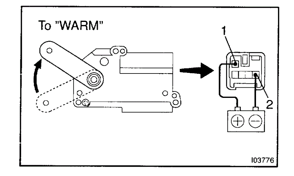

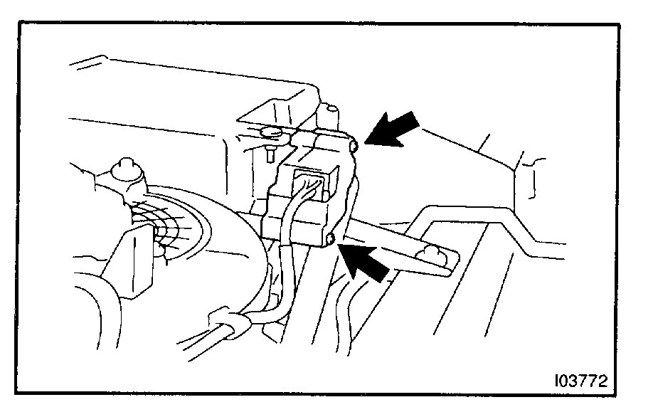

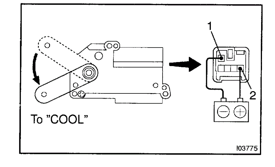

I attached the test for the air mix door under the dash for you as well in case the motor is not closing off the heater core.
INSPECTION
1. REMOVE FRONT SEATS
2. REMOVE FRONT DOOR SCUFF PLATES
3. REMOVE COWL SIDE TRIMS
4. REMOVE REAR DOOR SCUFF PLATES
5. REMOVE LOWER CENTER PILLAR GARNISHES
6. REMOVE AIR MIX SERVOMOTOR
a. Slide the floor carpet backward.
b. Disconnect the connector.
c. Remove the 2 screws and servomotor.
7. INSPECT SERVOMOTOR OPERATION
a. Connect the positive (+) lead from the battery to terminal 2 and negative (-) lead to terminal 1, then check that the arm turns to "COOL" side smoothly.
If operation is not as specified, replace the servomotor.
b. Connect the positive (+) lead from the battery to terminal 1 and negative (-) lead to terminal 2, then check that the arm turns to "WARM" side smoothly.
8. INSPECT POSITION SENSOR RESISTANCE

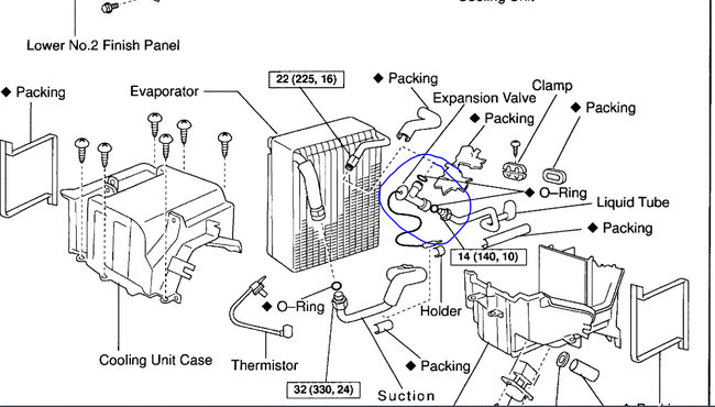

Okay, got a gauge. I have 15 on the low and 135 on the high. When I tried to add another can of from the system would not take it.
Aug 5, 2020 at 8:00 AM
Okay, 15 pounds is your issue. The expansion valve is stuck closed not allowing Freon into the evaporator.
You need to replace the expansion valve and the dryer.
https://www.youtube.com/watch?v=GemLsZuQeWc
The expansion valve is on the end of the evaporator core under the dash. It will require removal of the heater case to access.
I attached a YouTube video of the location and how to get to it without removing the heater case.
