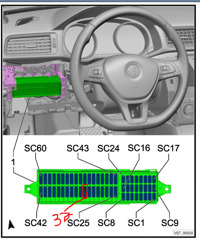

I can't seem to find which fuses to check either under the hood or in the cabin. All the ones I see online are different than mine. My fuse panel is located near the steering wheel. Not on the side as I see online.

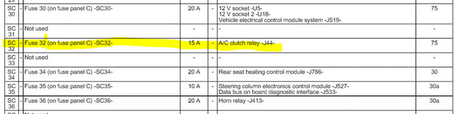

If you are looking for the fuse related to the A/C compressor, it is number 32 in the fuse box near the steering wheel. I attached two pics. The first is a partial legend indicating what each fuse is for. The second shows location. Note that I had to circle the fuse. They don't make it easy. LOL They provide numbers identifying certain fuses and then you have to count to the correct fuse. Ugh!!!
Anyway, let me know if this helps.
