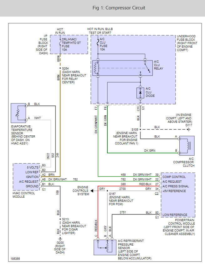

Compressor clutch will not come on. it has the right amount of pressure on the lines. it is getting current to the relays, but no current to the compressor. I stopped for gas and when I restarted the engine the compressor would not kick on. Like I said we tested the current from the inside to the relay box under the hood. Checked the pressure and the system is full. Just no current to the compressor.

It sounds like you have a connection problem. Here are some guides to help you do some testing so you can get the problem fixed.
and
Wiring diagrams (below)
Please run some tests and get back to us we are interested to see what it is.
