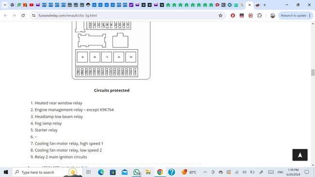

This is the diagram I found. no relay for A/C but maybe its somehow about number 6 or 7?
Jun 19, 2024 at 8:43 PM
  • 110,241 POSTS
Numbers 6 and 7 are for the radiator cooling fan. By chance, do you have the original owner's manual? It may have something listed.
