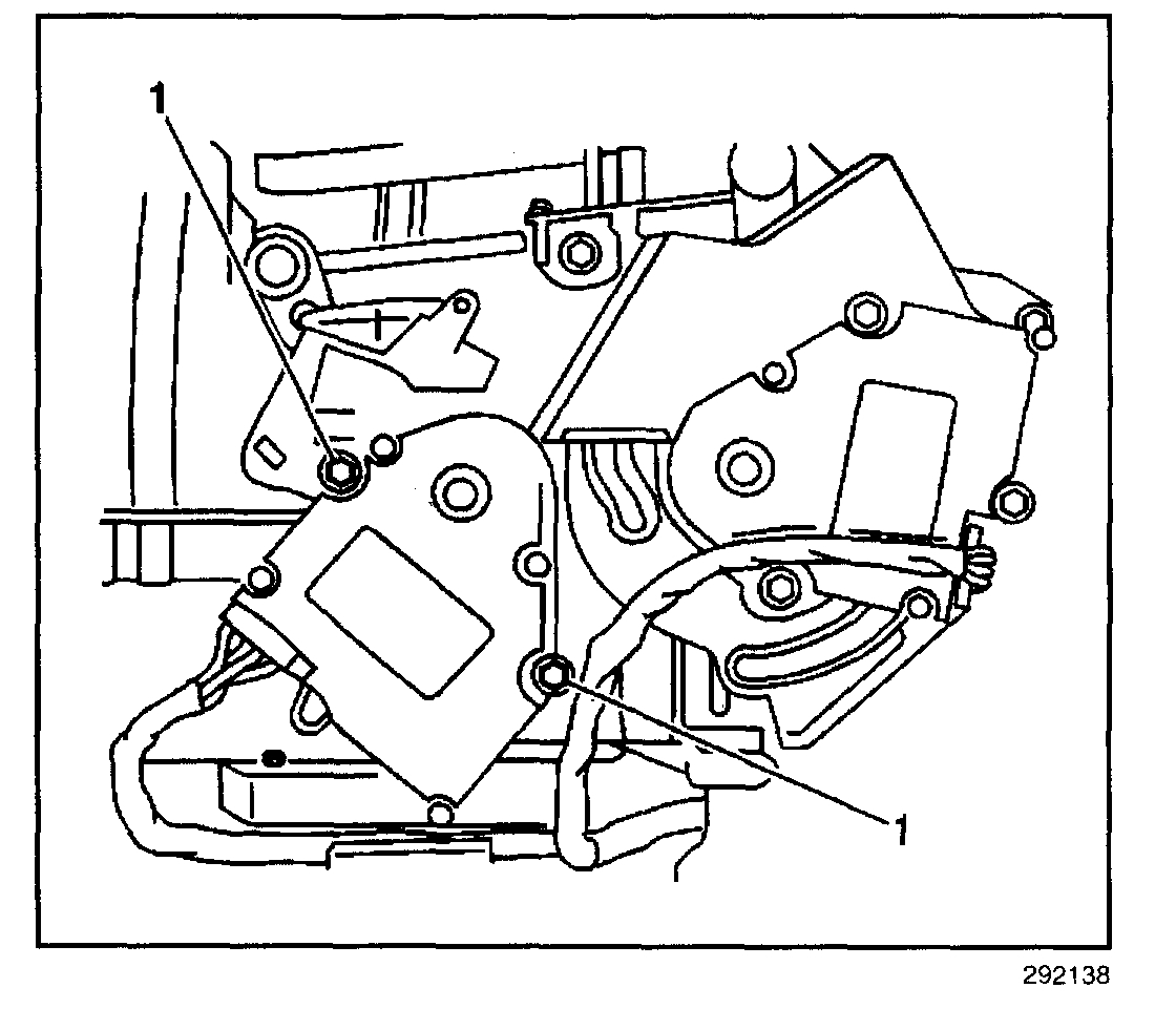

Driver side blows cold air on high heat.

If it is limited to only the driver's side, chances are the blend air door actuator for that side is bad.
What I suggest is to remove the actuator and inspect it for operation. If you are hearing a clicking sound, then likely the small plastic gear in the actuator has broken the teeth on the gear.
Take a look through this link. It explains what goes wrong and how, in general, one gets replaced.
Here are directions specific to your vehicle and the left side for removal and replacement. The attached pics correlate with the directions.

pic 1
1. Remove the left side sound insulator. Refer to Closeout/Insulator Panel Replacement - Left in Instrument Panel, Gauges and Warning Indicators.
2. Remove the aspirator muffler.
3. Remove the electrical connector from the left air temperature actuator.
4. Remove the left air temperature actuator retaining screws (1).

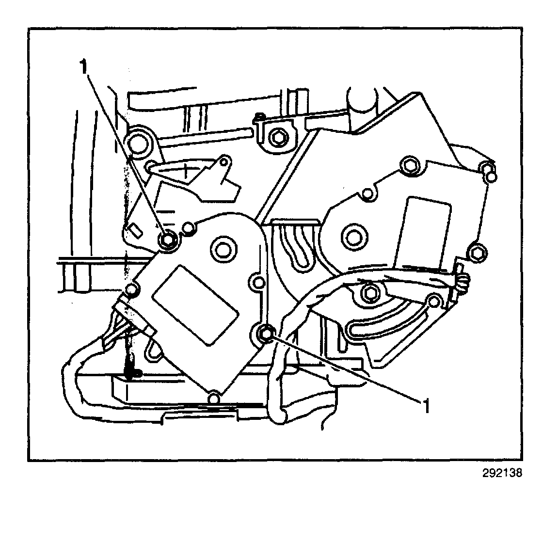

pic 2
5. Remove the left air temperature actuator.

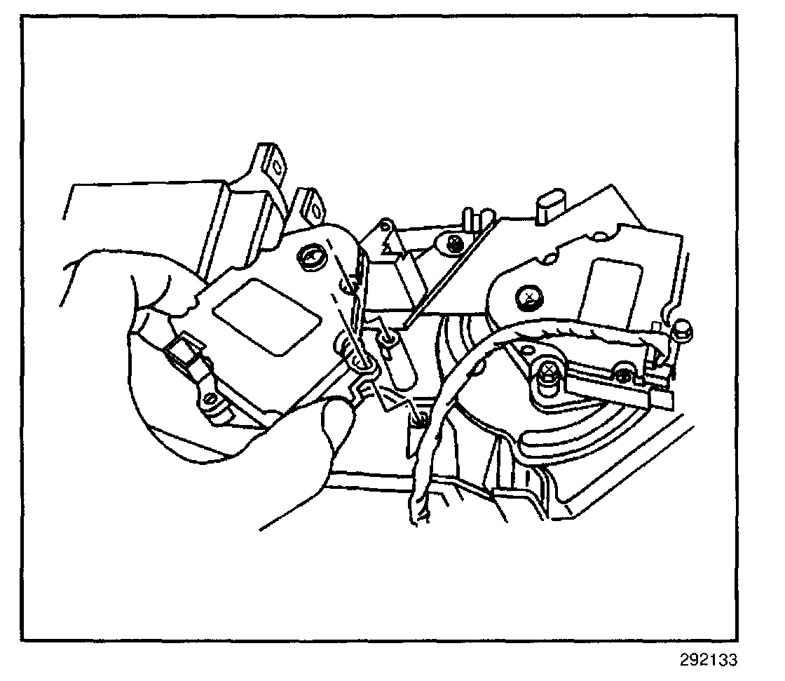

pic 3
1. Install the left air temperature actuator.
