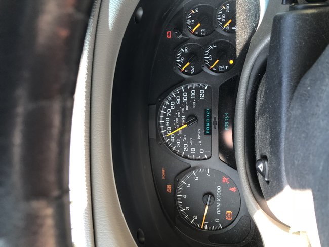

All lights comes on when the air conditioning runs for a while. All lights come on but the car does not stop running. The windows will not roll down. What could be causing this?

All the lights on the dash, notifications lights come on battery, seat belt, engine, etc. Yes the air conditioning still be blowing, the windows do not roll down when lights come on, unless I pull over and turn key off then the lights on dash go off and power resumes to the windows. The gauges on the dash also go to the off position as if I turned the car off. But the car still be going/running. I uploaded a picture of the dashboard with lights on.
Thursday, June 7th, 2018 AT 12:12 AM
  • 52,797 POSTS
From the looks of it, you are loosing communication. This could be from the ignition switch which is common for this issue.
I suggest you get it checked to be sure.

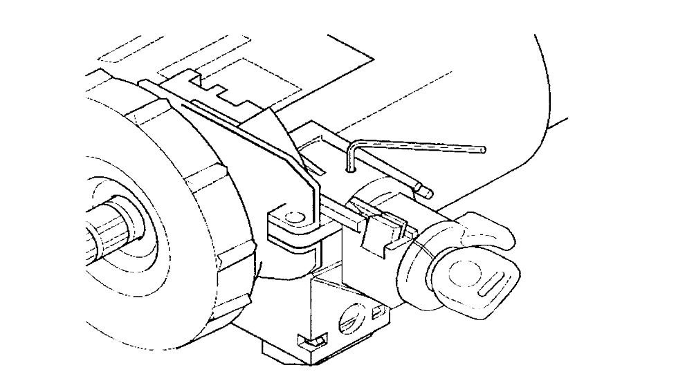

6. Install an allen wrench into the hole on top of the lock cylinder housing. Push down on the allen wrench to release the tab on the lock cylinder inside the lock cylinder housing.

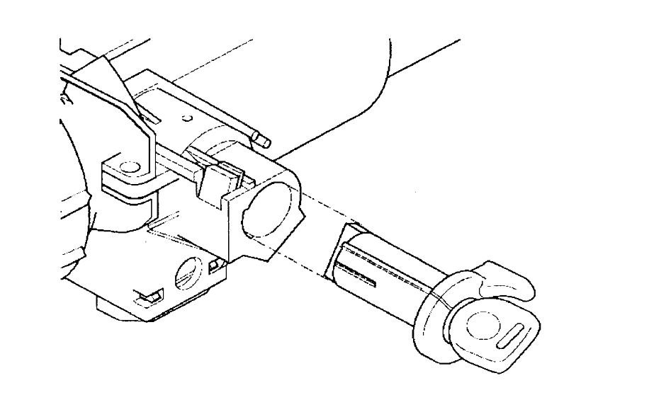

7. Slide the lock cylinder out of the lock cylinder housing.
8. Disconnect the passlock and key buzzer from the lock cylinder housing.

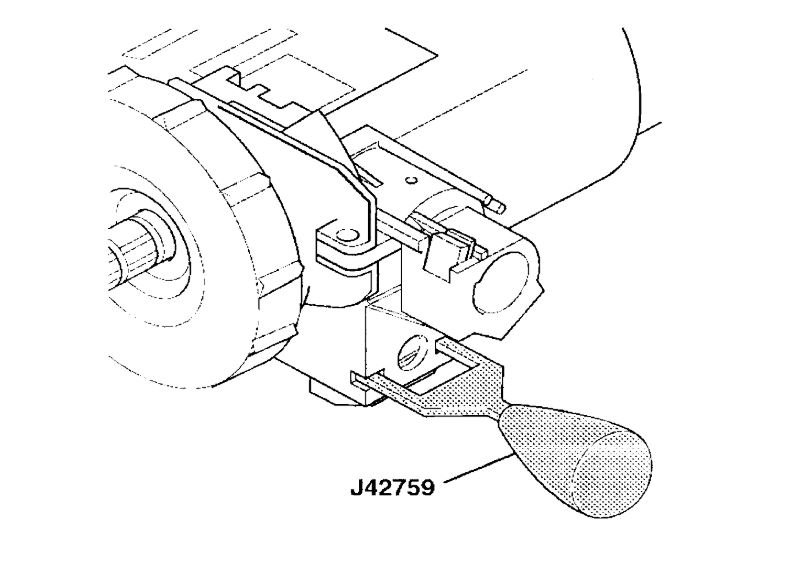

9. Insert J-42759 into the lock cylinder housing to release the tabs on the ignition switch.
10. Pull the ignition switch out of the lock cylinder housing.
