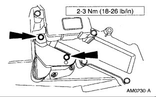

To check the for air flow direction problems, follow these steps. NOTE: I have attached several pictures to help.
REMOVAL

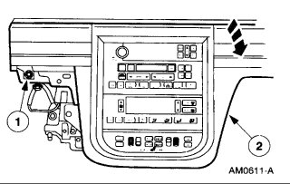

Remove the screws and lower the instrument panel steering column cover.
Reposition the instrument panel finish panel.
1 Remove the screw.
2 Disengage the clips and reposition the instrument panel finish panel away from the instrument panel.
Push in on the retaining tabs and remove the automatic temperature control sensor hose and elbow from the instrument panel finish panel. To remove the in-car temperature sensor, push in on the retaining tabs and remove from the trim panel.

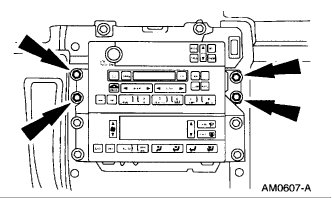

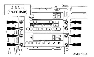

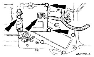

Remove the screws and reposition the radio chassis.

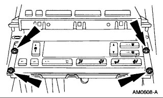

Remove the screws and pull the electronic automatic temperature control module from the instrument panel.
Remove the electronic automatic temperature control module.

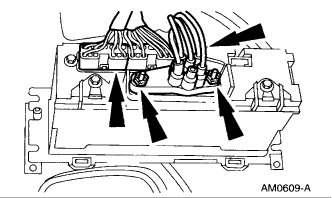

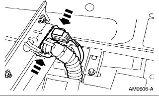

Remove the nuts and the vacuum harness connector.
Remove the electrical connectors and remove the electronic automatic temperature control module.
Once the unit is removed, check for damaged, cracked, or disconnected vacuum lines. Additionally, check to make sure there is a vacuum supply coming from the engine.

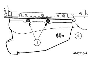

Remove the instrument panel insulator.
1 Remove the pushpins.
2 Disconnect the courtesy light and remove the instrument panel insulator.

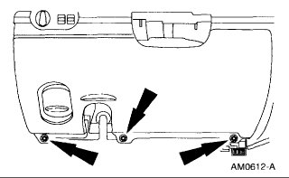

Remove the floor console.

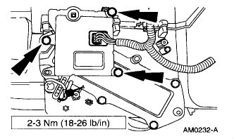

Remove the screws and remove the cover.

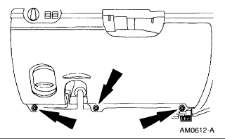

Remove the A/C electronic door actuator motor.
Disconnect the connector.
Remove the screws and remove the A/C electronic door actuator motor.
