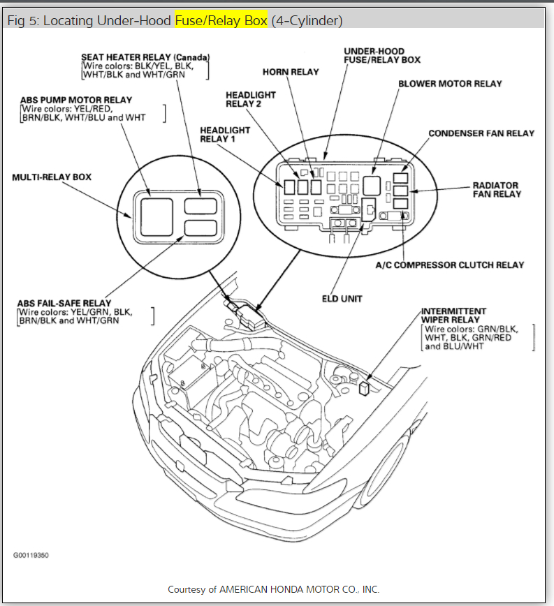

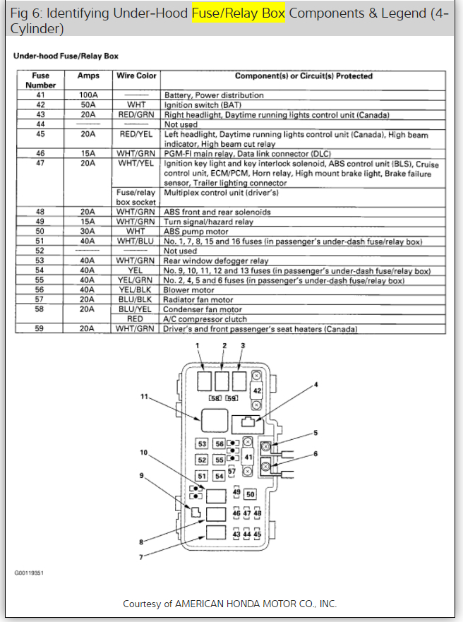

Air will not blow cold unless the lights come on they come on some times, but sometimes they do not. What is the problem?
Jul 17, 2016 at 1:45 PM
HMAC300
  • 48,601 POSTS

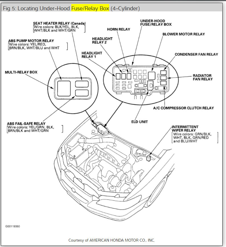

This usually happens when the compressor clutch coil shorts out intermittently. Here is a guide to help you change out the compressor, but I would test the compressor relay as well.
https://www.2carpros.com/articles/replace-air-conditioner-compressor
and
Check out the diagrams (below). Please let us know what you find.
Cheers
Jul 18, 2016 at 12:12 AM
ZOOM-ZOOM
Thanks for the guides and diagrams I checked my car out and I think I got lucky because I changed the relay and everything worked.
