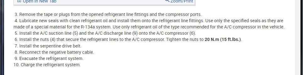

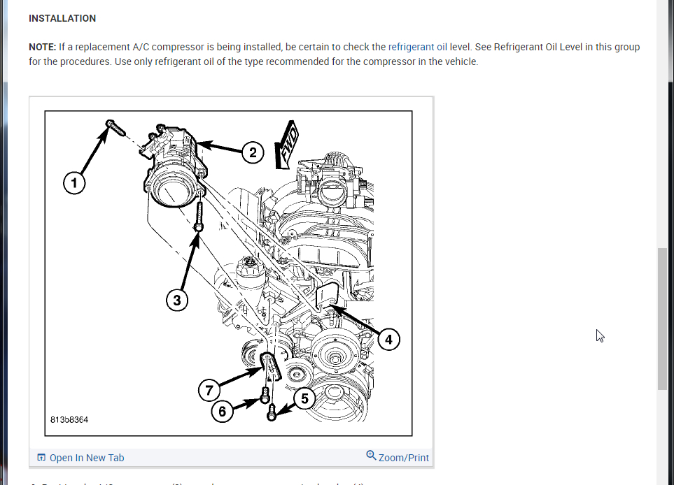

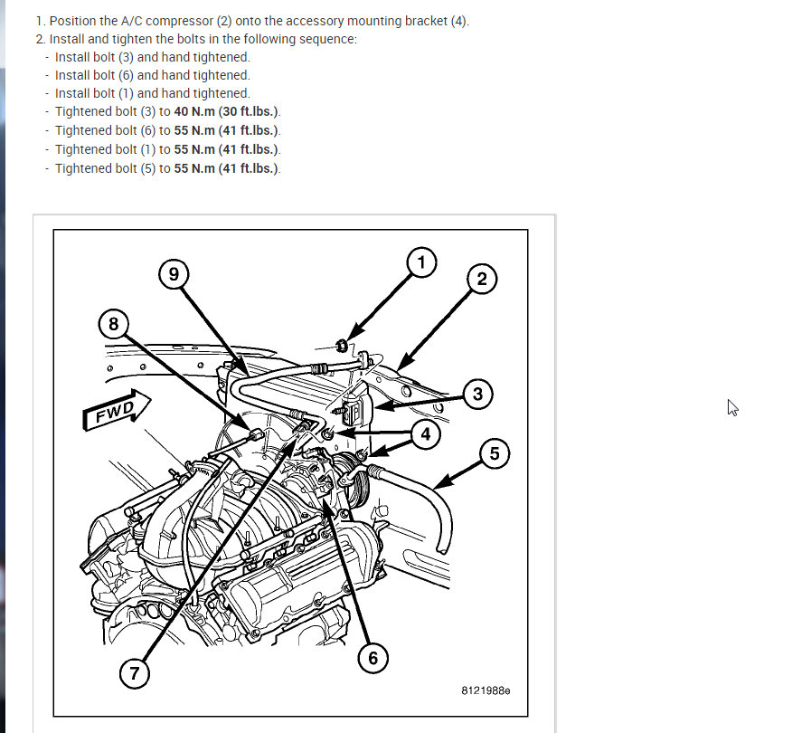

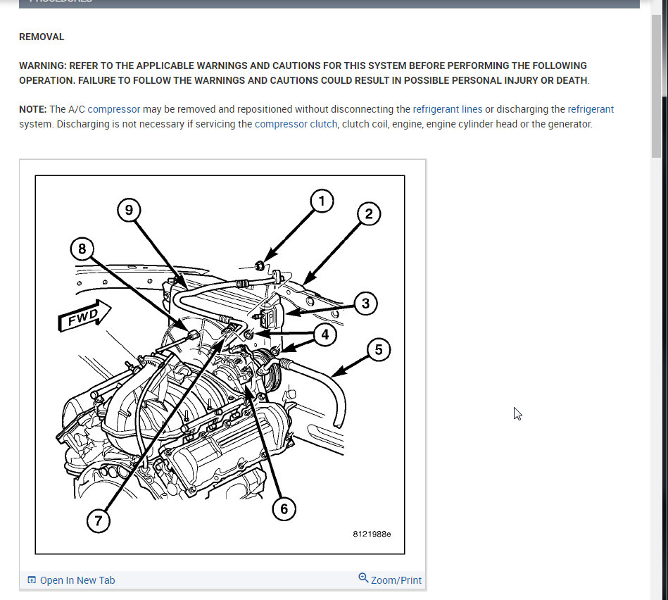

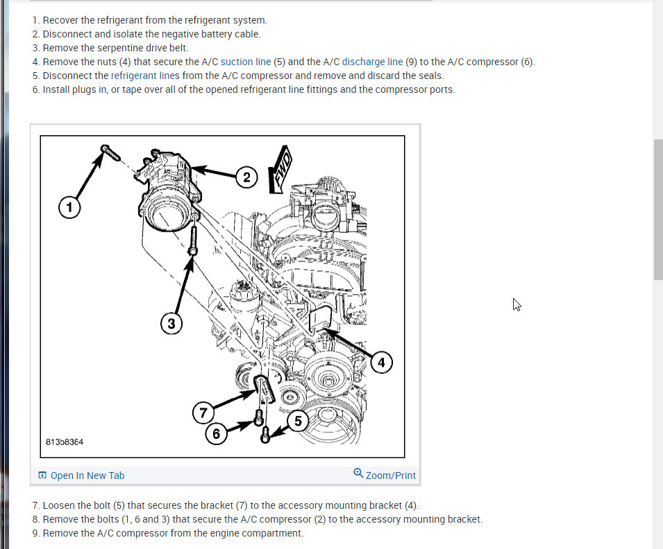

You are correct that if the low side is high and the high side is low then the compressor is most likely faulty.
Here is a guide that will help with this:
https://www.2carpros.com/articles/replace-air-conditioner-compressor
Below is a chart that will help with this and the process from the manual on how to replace the compressor. Please let us know if you have other questions. Thanks
