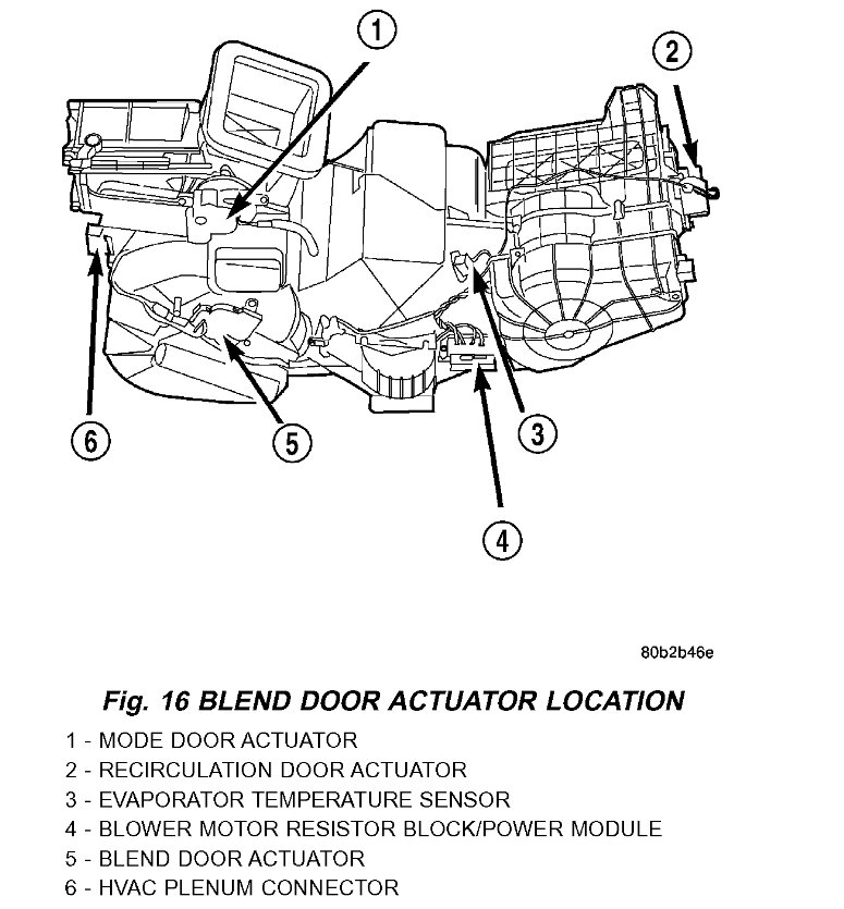

Where is the temperature blend door actuator located?
142,000 MILES
WILL3131
Air conditioning. The location of the temperature actuator.
Apr 25, 2023 at 7:08 AM
  • 55,710 POSTS
Sure, here are the locations of all of the actuators so you can see how the system works. Check out the images (below). Please let us know if you need anything else to get the problem fixed.
