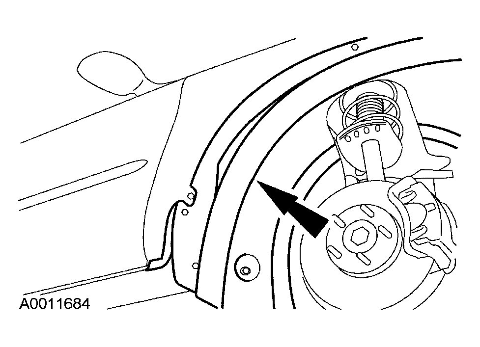

You have a vacuum leak in the heater control system or under the hood. When you accelerate the throttle opens farther, that actually decreases the amount of vacuum and the actuators that hold the mode doors in position move and shut off the vents.
Common reasons for this are a bad vacuum check valve in the line to the vacuum reservoir or in the lines from it to the various items it holds vacuum for.
The reservoir is inside the passenger fender, you remove the inner fender liner to get to it.
