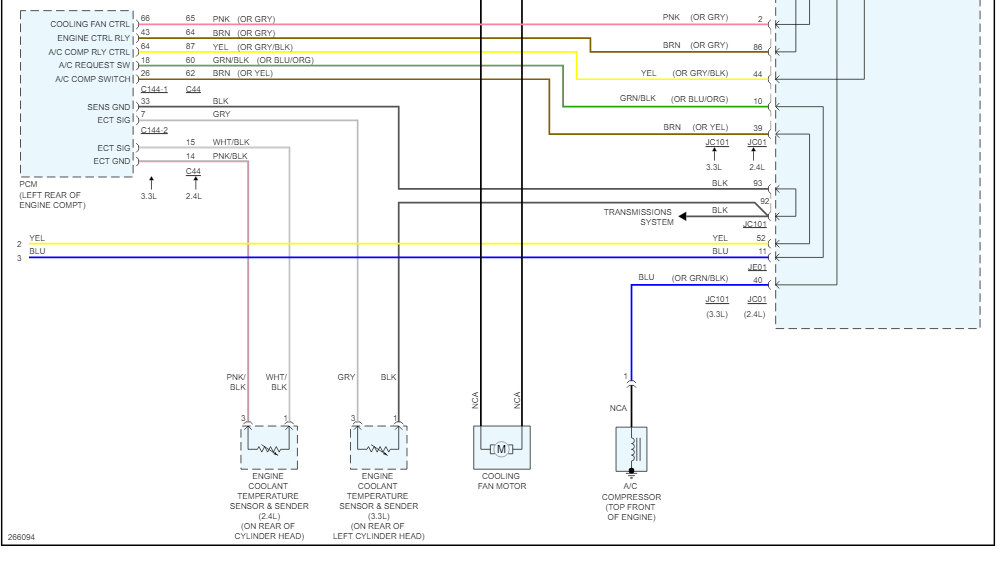

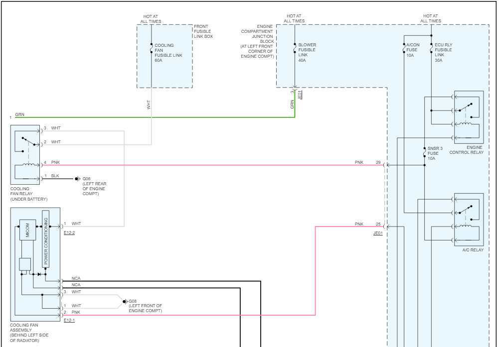

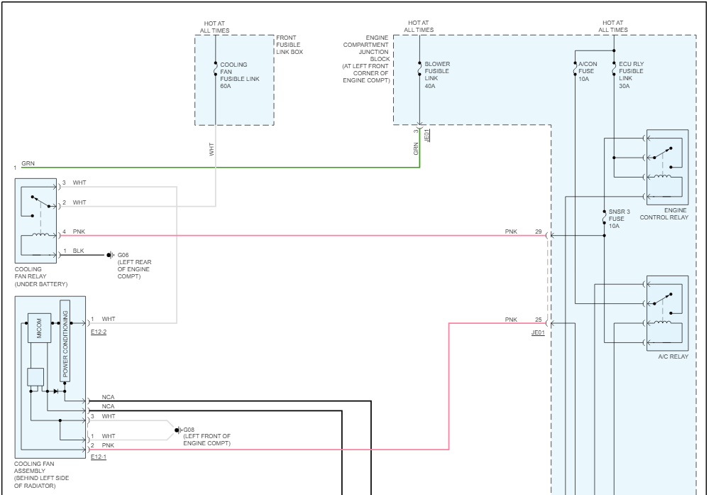

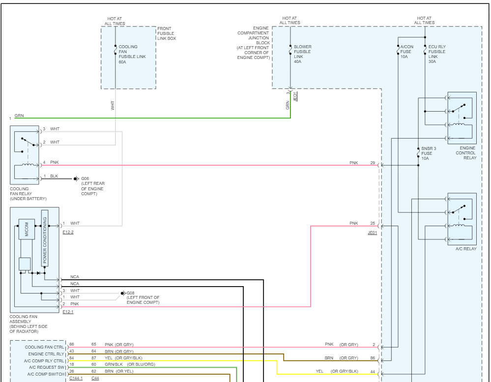

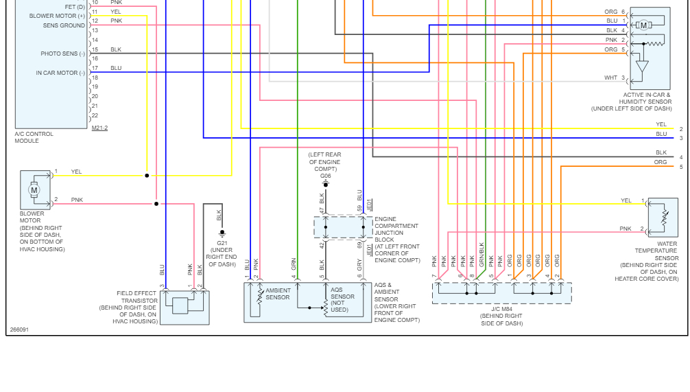

air conditioning stopped working; can I get a wiring schematic?
115,000 MILES • 3.3L • 6 CYL • 2WD • AUTOMATIC
LARRYPARADIS
Just in need of wiring schematic so I can trouble shoot.
Jun 16, 2022 at 11:43 PM
SQM
  • 6,383 POSTS

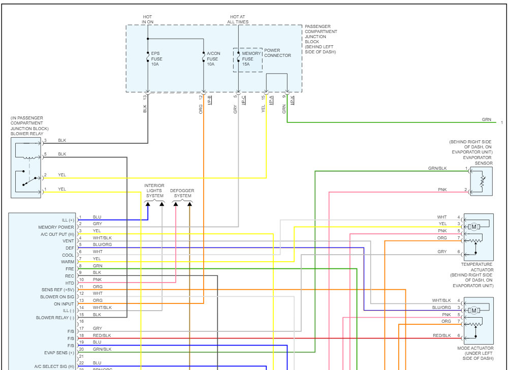

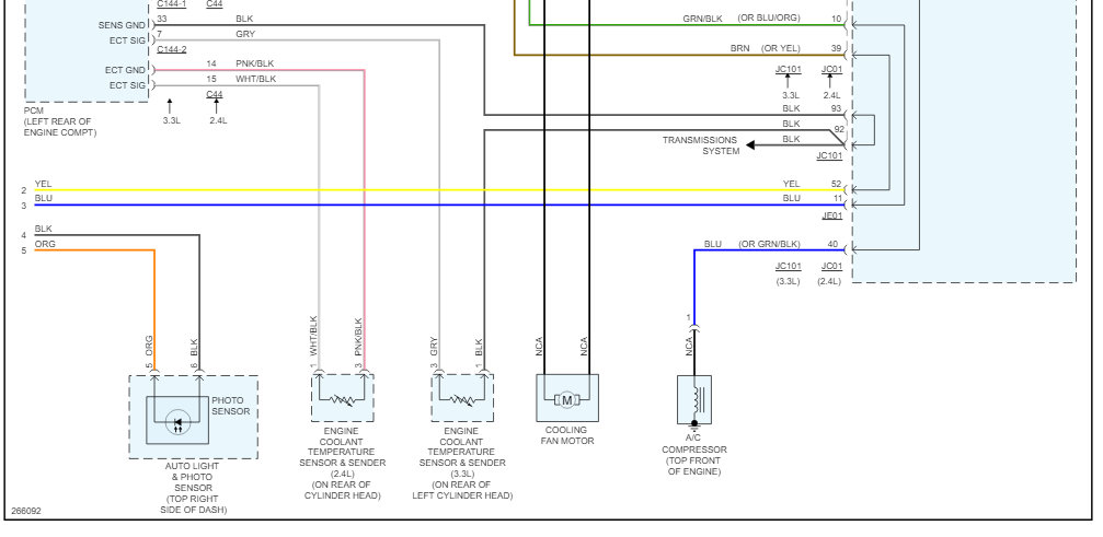

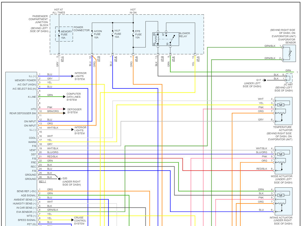

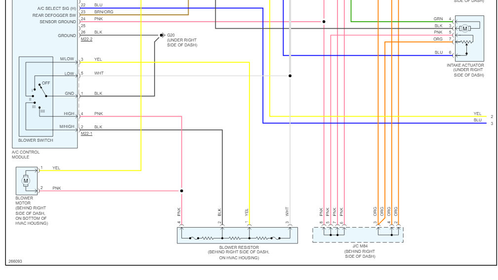

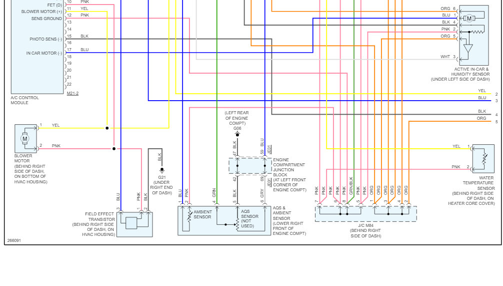

See attached for the wiring schematics for the AC system.
The first four images are for manual climate control and the last four images are for automatic climate control.
Let me know of any questions.
