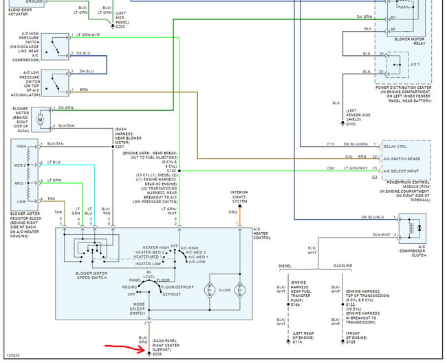

The A/C clutch is engaging with the selector in the dash/floor fresh air position. It does not engage in the dash only and floor only positions which is normal. I changed out the A/C heating control switch assembly but still have the same problem. I also changed out the A/C compressor clutch relay (just in case) but no change.

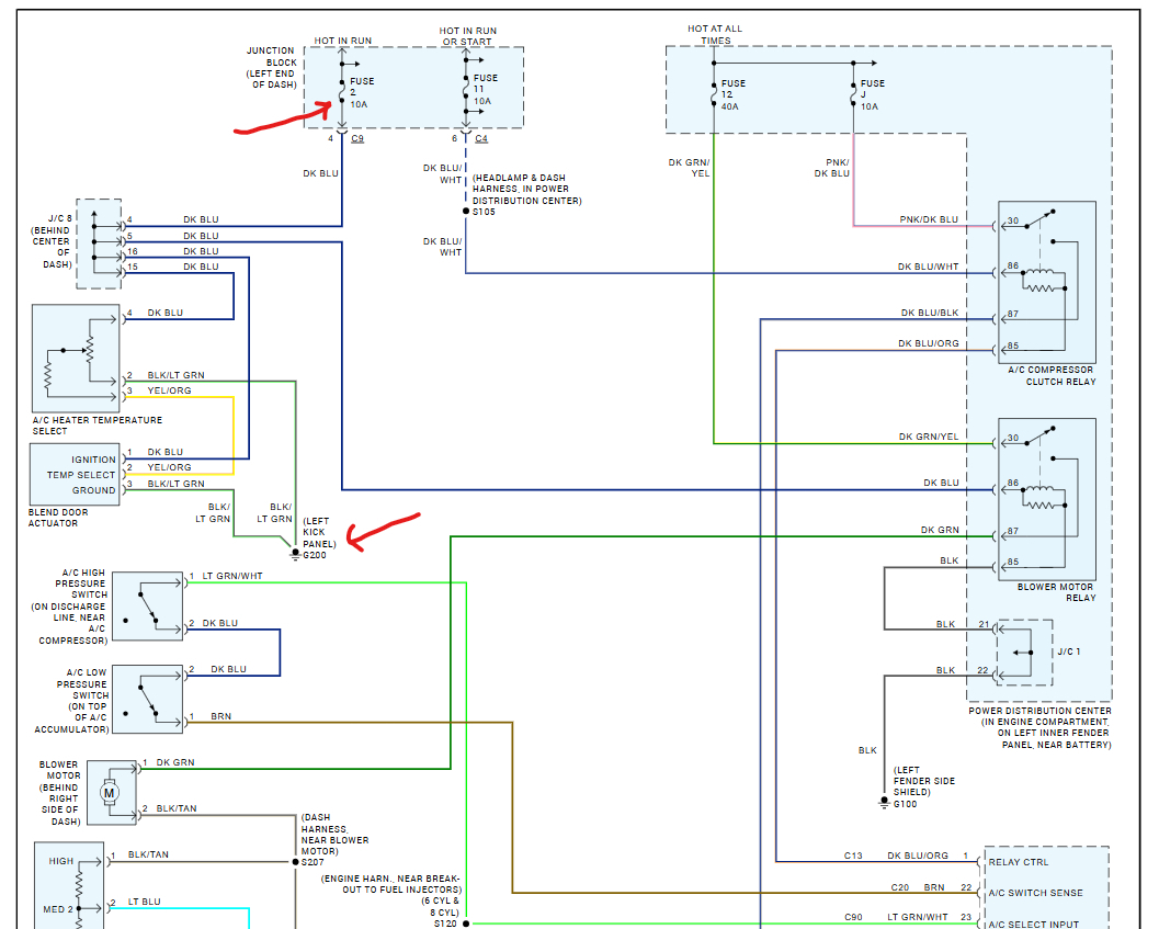

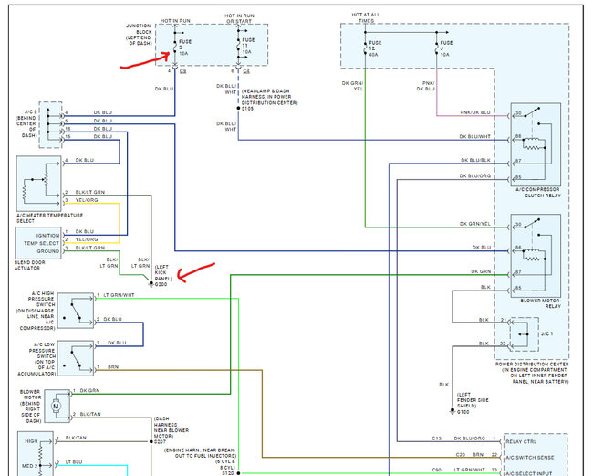

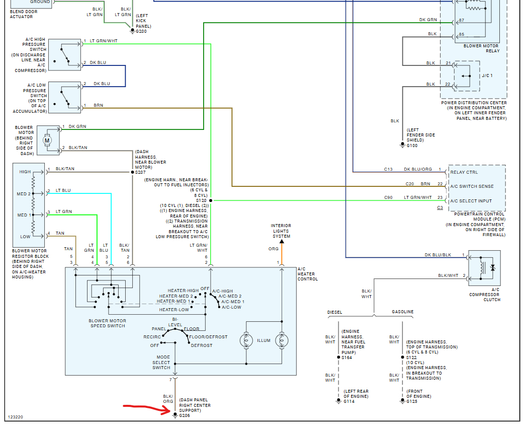

So to be clear, the compressor does not engage while the HVAC system is on the dash vent setting? Here are the wiring diagrams for the system which show the fuses and the ground G200 and G206 that need to be checked, here is a guide to help you:
Check out the images (below). Please upload pictures or videos in your response of any problems so we can see what to help you with.

Thanks for the reply. The compressor does not engage in the dash only or floor only setting which it should not but does engage in the dash/floor combination setting, which should be fresh air only and compressor not engaged. It does engage in the two a/c settings: max a/c and a/c. It works correctly in all of the settings except dash/floor combination when it should not be engaged but is.

Thanks, Ken. The connections on the controller are 1 multi vacuum and 3 electrical all of which only fit one way. Kind of hard to do it wrong, but I understand you asking. I checked the ground under the left kick panel, it's good. I haven't managed to locate the dash panel right center support one yet. I'll try again to find it tomorrow. I'll let you know. Thanks for your help.
