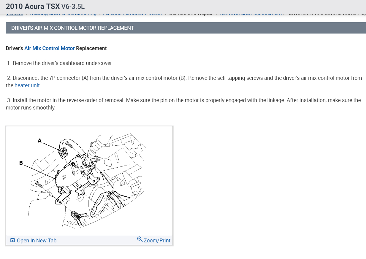

I have plenty of AC but only out of the passenger side two vents. I have air coming out of driver side not hot but not cold. I need to know how to fix this. Thanks much

It sounds like you have a driver's side air blend door actuator that is not working. here is the instructions below on how to fix it step by step. Check out the diagrams (below). Please let us know what happens.
