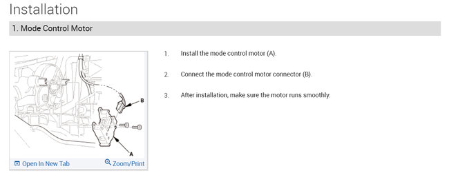

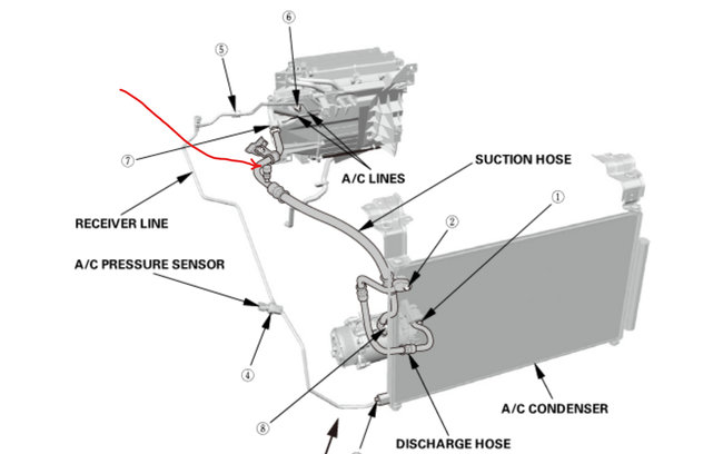

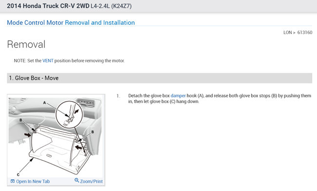

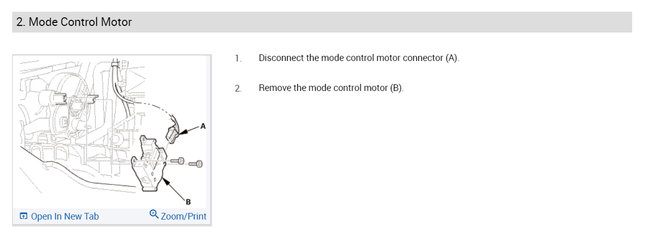

Does it feel like the heater is on or the air conditioner is just not working? If the heater is on, then you may have a temperature blend door actuator that is not working. If the air is not working, chances are you need to service the system with a simple recharge. Here is a video to show how to recharge the system with the blend door actuator location in the diagrams below:
https://youtu.be/uZrQCGwXfek
and
https://www.2carpros.com/articles/air-conditioner-how-to-add-freon
I have shown where the low side charge port is as well in the last diagram. Check out the diagrams (below). Let us know what happens and please upload pictures or videos of the problem.
