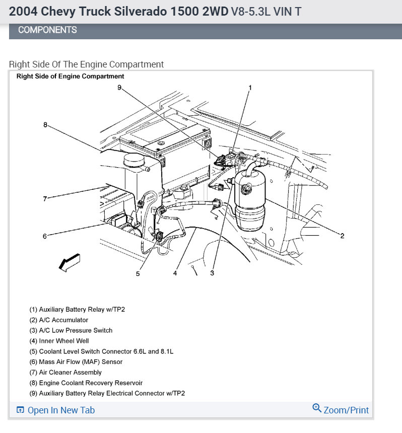

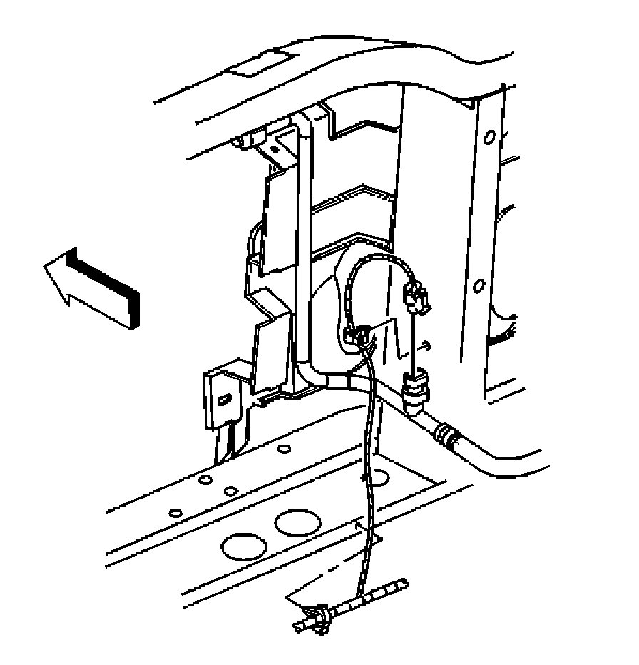

I don't know if you need them, but here are the directions for replacing one. The attached picture correlates with the directions.
___________________________________
AIR CONDITIONING (A/C) REFRIGERANT PRESSURE SENSOR REPLACEMENT
TOOLS REQUIRED
J 39400-A Halogen Leak Detector
REMOVAL PROCEDURE
1. Raise and support the vehicle. Refer to Vehicle Lifting.
picture 1
2. Disconnect the electrical connector from the A/C high pressure recirculation switch.
3. Remove the A/C high pressure recirculation switch from the evaporator tube.
INSTALLATION PROCEDURE
NOTE: Refer to Fastener Notice in Service Precautions.
Also Picture 1
1. Install the A/C high pressure recirculation switch.
Tighten
Tighten the switch to 6 N.m (53 lb in).
2. Connect the electrical connector to the A/C high pressure recirculation switch.
3. Leak test the fittings of the components using the J 39400-A.
4. Lower the vehicle.
I hope this helps. Let me know the results.

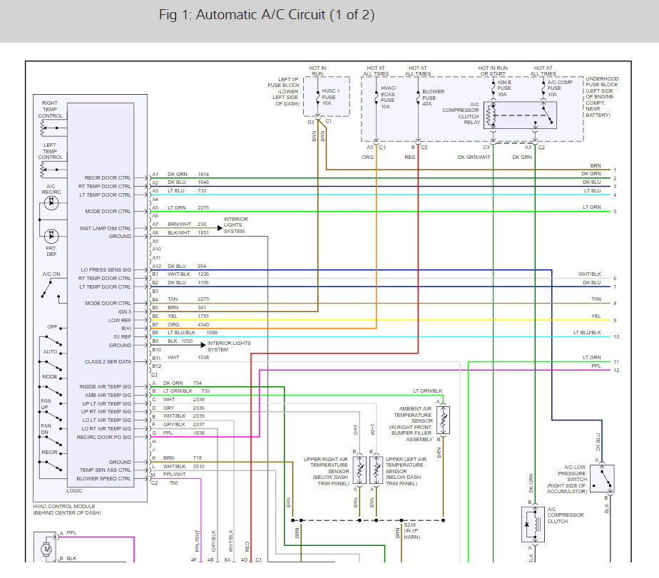

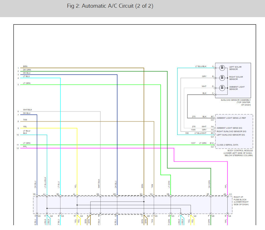

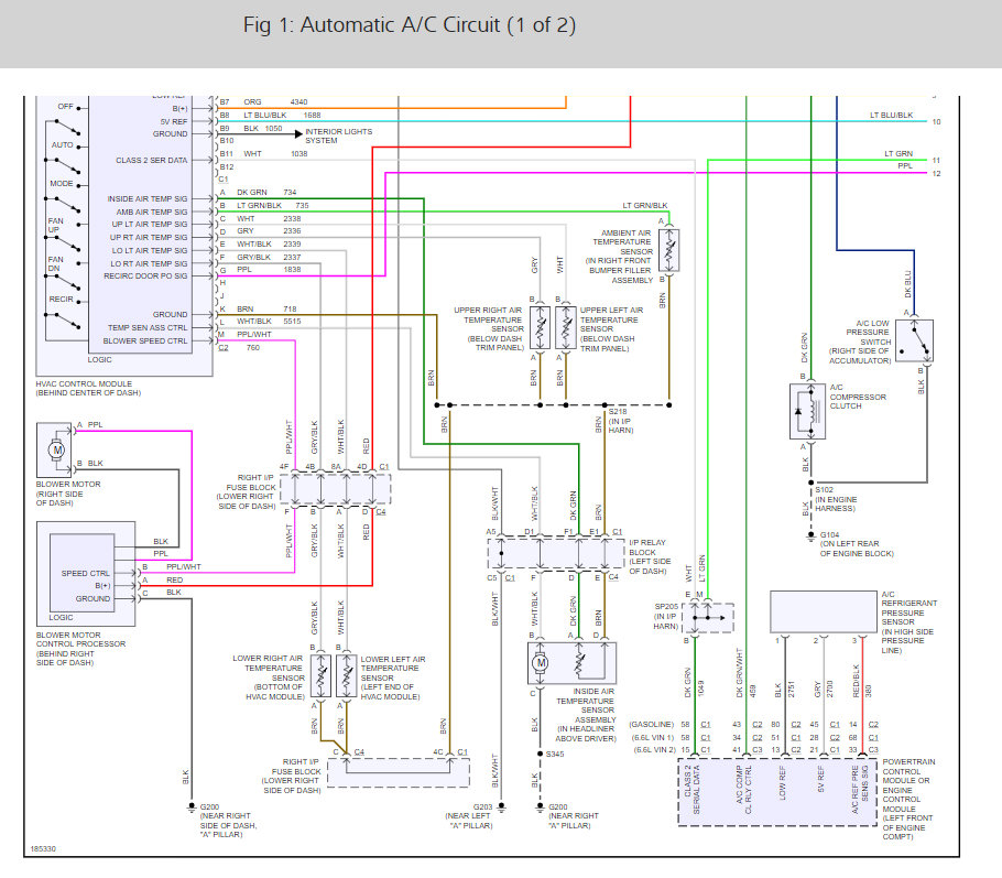

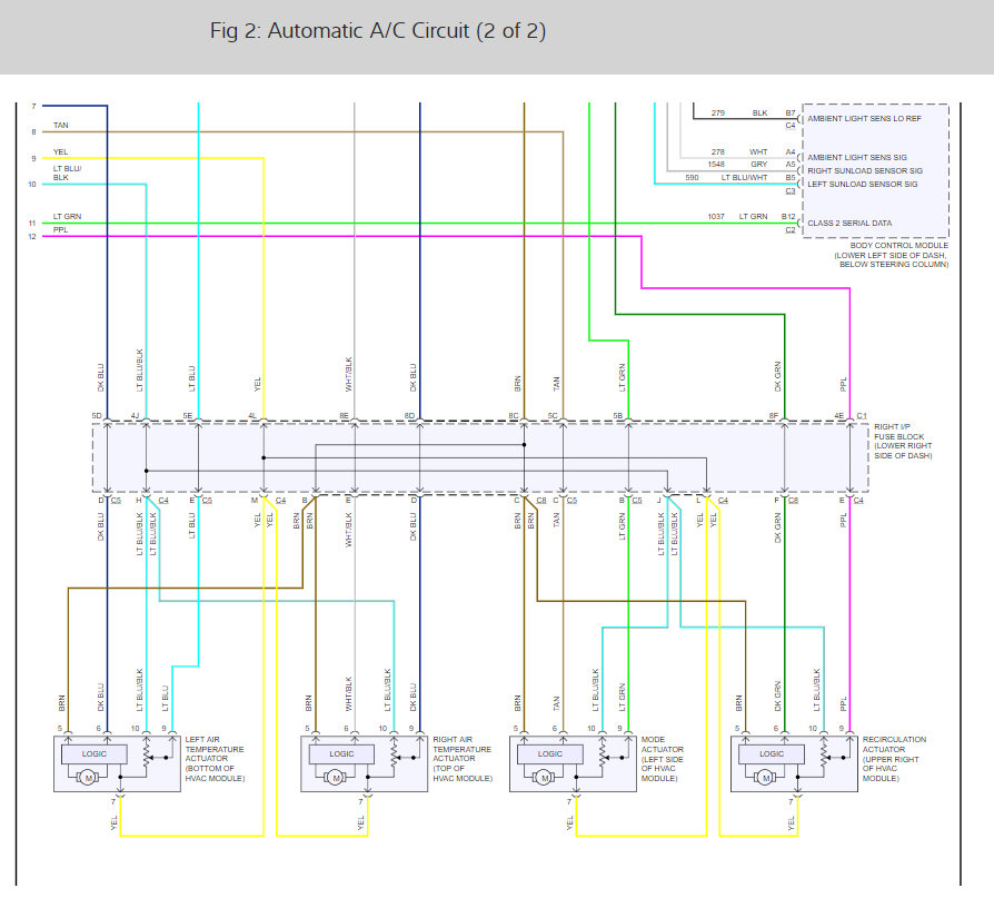

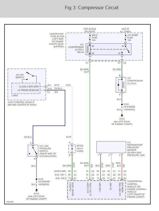

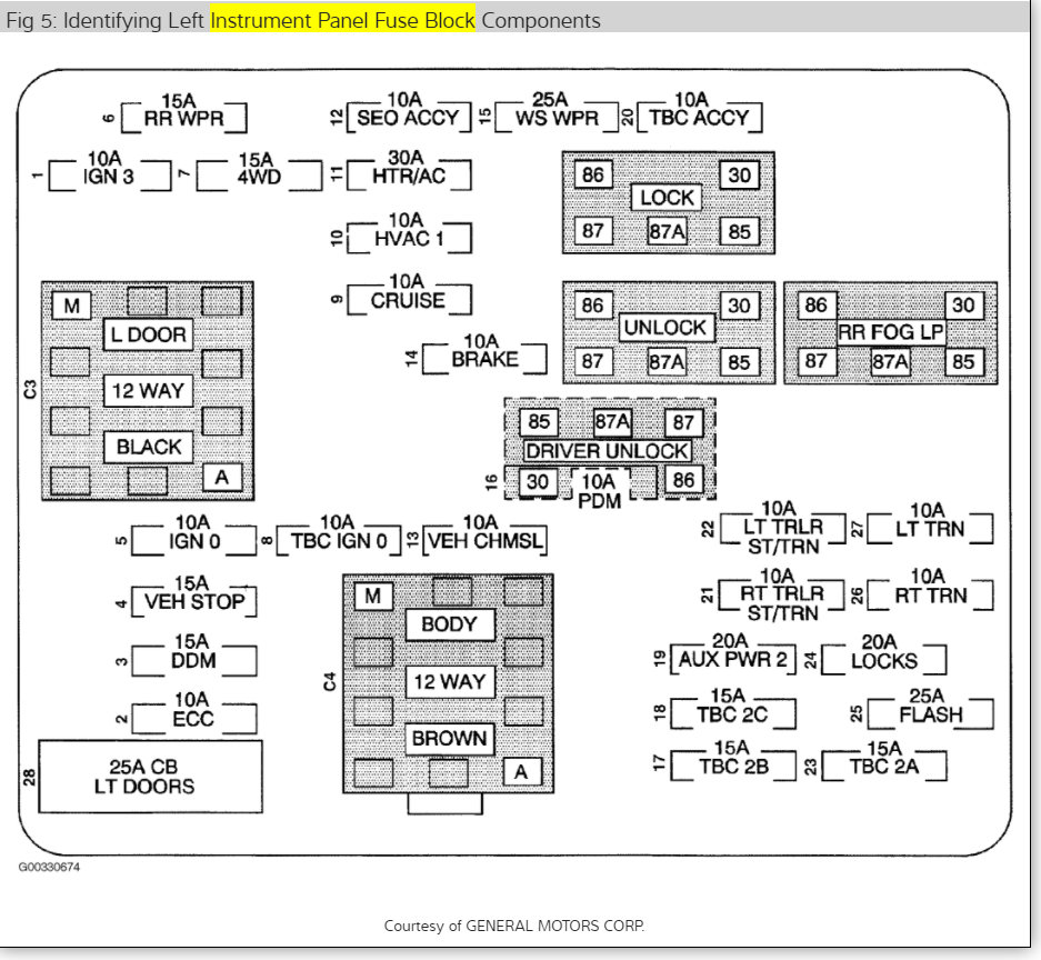

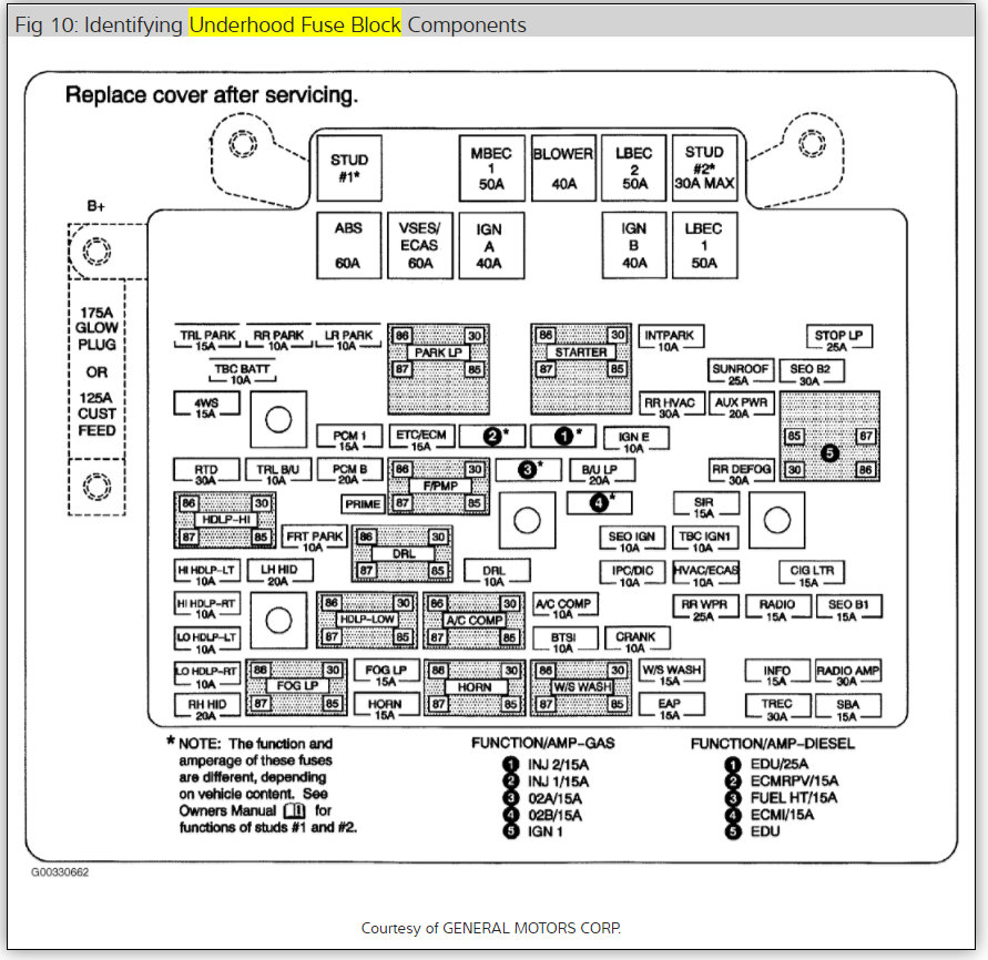

When it is hot the system will not cycle. Can you unplug the compressor to see if the clutch disengages please? Here is the air conditioner wiring diagrams so you can see how the system works. It could be the compressor relay sticking sometimes as well, the location is below.
Here is a guide for the blend doors:
Check out the diagrams (below). Please let us know what you find.
Aug 3, 2019 at 4:03 AM

When I unplugged the compressor it didn't come back on when I restarted it. It will turn on and off with switch and if you unplug the cycle switch it will also kick off as well but as soon as you plug it back up it never disengages no matter what temperature it is.
Aug 3, 2019 at 5:12 AM
  • 55,782 POSTS

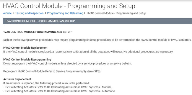

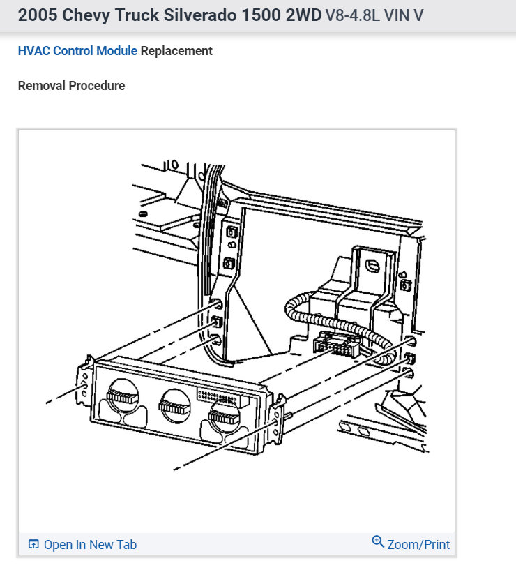

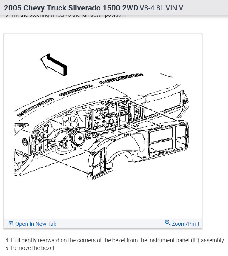

Okay cool, that does sounds like a HVAC controller has gone bad. here are instructions to change it out in the diagrams below. Please let us know what you find.
