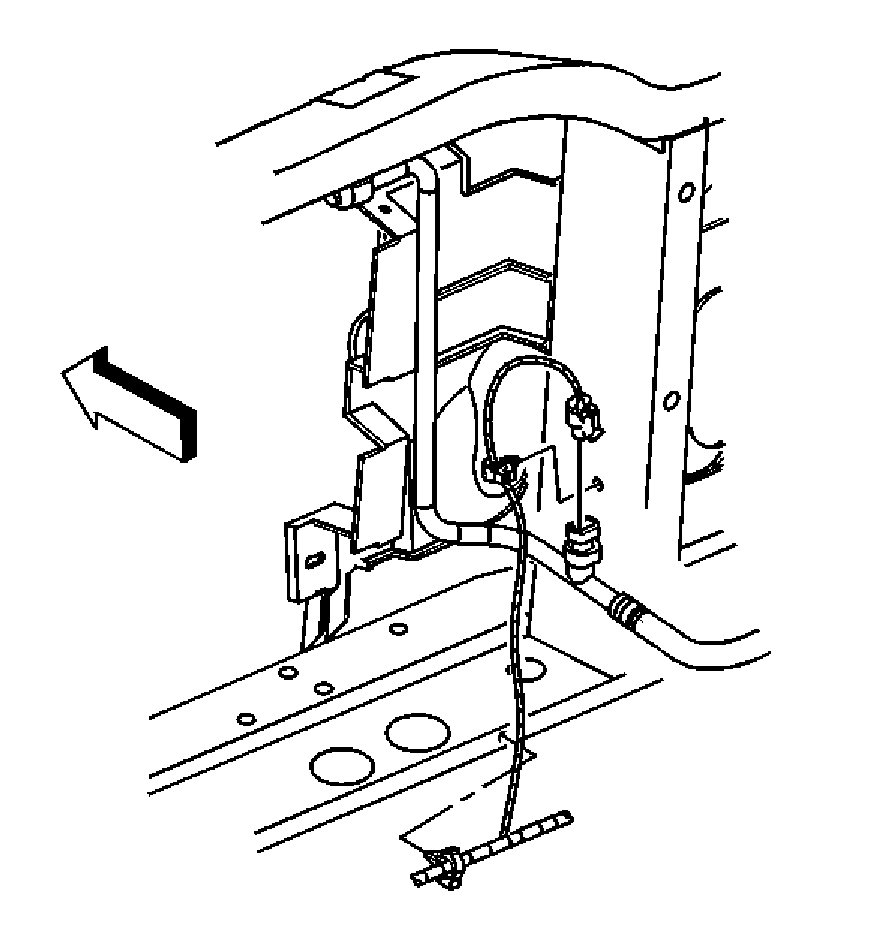

I don't know if you need them, but here are the directions for replacing one. The attached picture correlates with the directions.
___________________________________
AIR CONDITIONING (A/C) REFRIGERANT PRESSURE SENSOR REPLACEMENT
TOOLS REQUIRED
J 39400-A Halogen Leak Detector
REMOVAL PROCEDURE
1. Raise and support the vehicle. Refer to Vehicle Lifting.
picture 1
2. Disconnect the electrical connector from the A/C high pressure recirculation switch.
3. Remove the A/C high pressure recirculation switch from the evaporator tube.
INSTALLATION PROCEDURE
NOTE: Refer to Fastener Notice in Service Precautions.
Also Picture 1
1. Install the A/C high pressure recirculation switch.
Tighten
Tighten the switch to 6 N.m (53 lb in).
2. Connect the electrical connector to the A/C high pressure recirculation switch.
3. Leak test the fittings of the components using the J 39400-A.
4. Lower the vehicle.
I hope this helps. Let me know the results.

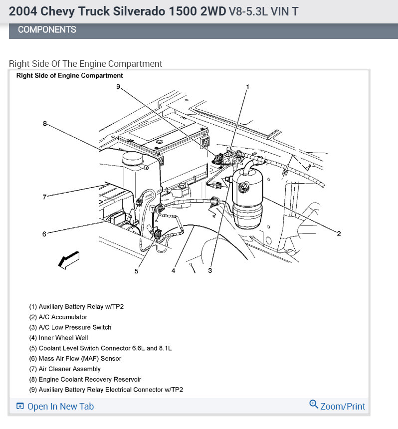

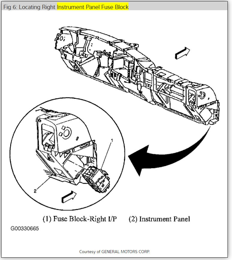

Yes, that is correct. you might have too much oil in the system causing the issues. but to be sure lets unplug the pressure sensor to see if the compressor clutch disengages. Here is the location. The pressure seems okay to me so I don't think the seals are gone. Check out the diagrams (below). Please let us know what you find. We are interested to see what it is.
Jun 18, 2019 at 5:22 AM

Sorry it has taken me so long to reply, but this is what I’ve done so far. I’ve put new Freon in it, a new high pressure sensor, cycling switch sensor the one located on the accumulator, changed orifice tube.
It still doesn't kick off. These are some other issues I’ve found, no matter what temperature i set my A/C too it doesn’t change. If I turn A/C switch off, and set temperature to 90 I have heat coming out of only front vents and bottom because If i turn defrost on it kicks my compressor in. Heat will eventually come out of passenger side vents with A/C on if it’s been set there awhile. I’m thinking this could be bad actuator switch under the dash. Could this cause evaporator to freeze and keep compressor from kicking off ?
We went on a trip for the weekend and I drove this truck and ac was real cold had no in between and sometimes it felt as is if it had moisture in it. Got to where we were going and i heard ice falling from Evaporator core. Water drips from bottom of truck at fast steady pace. If it idles more than 15 minutes starts blowing warm unless you idle it up some. The fan is working as well
Is it also possible that A/C cycle switch I put on is bad?
I’ve researched into ambient temperature switches and there is quite a few temperature switches on the truck and I don’t know what all actually sends the signals back and forth to let the compressor cycle other than that switch.

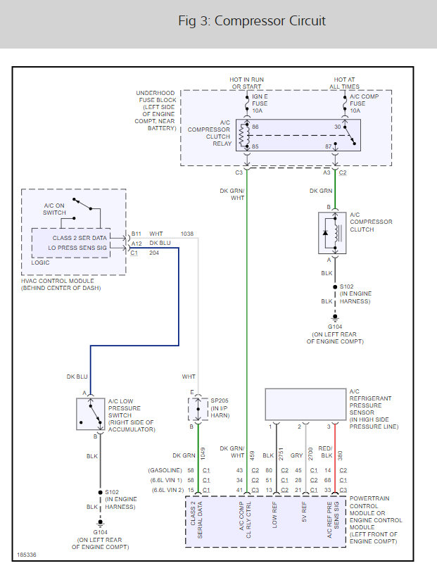

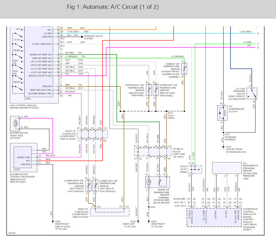

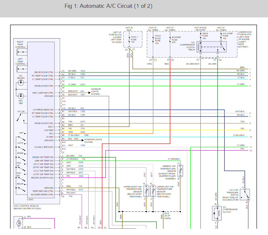

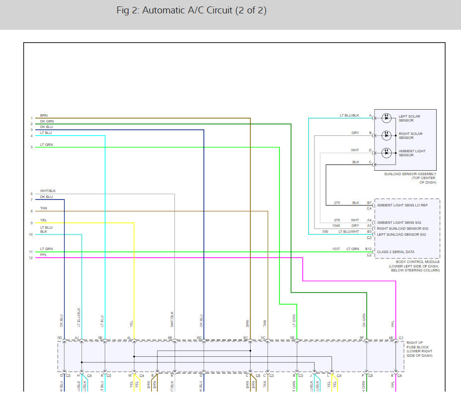

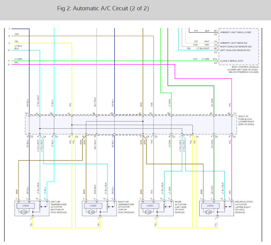

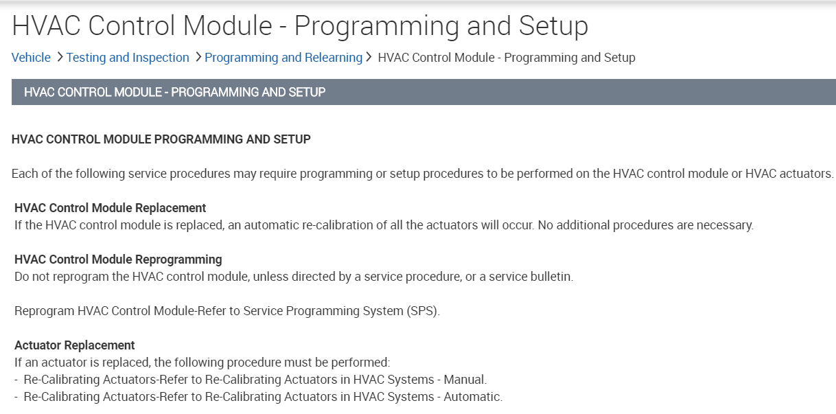

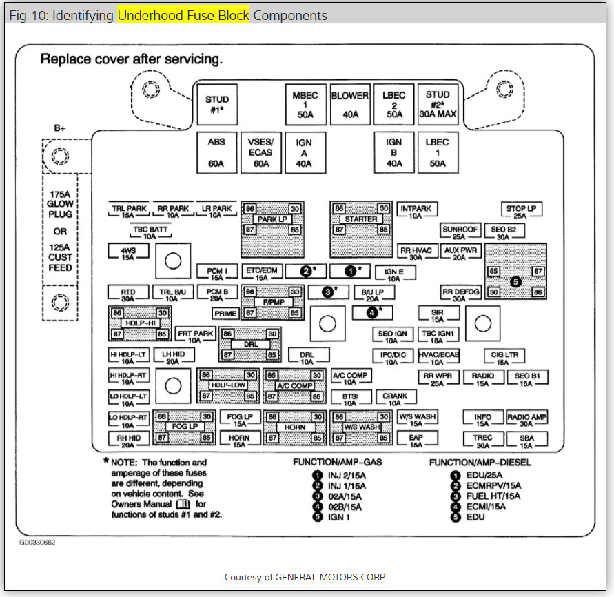

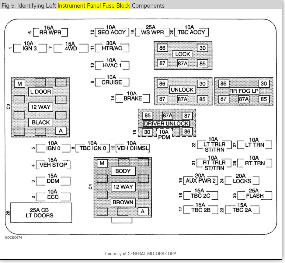

When it is hot the system will not cycle. Can you unplug the compressor to see if the clutch disengages please? Here is the air conditioner wiring diagrams so you can see how the system works. It could be the compressor relay sticking sometimes as well, the location is below.
Here is a guide for the blend doors:

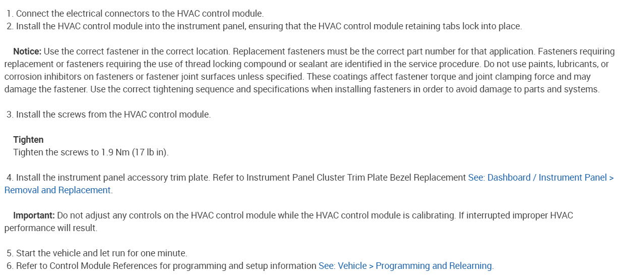

When I unplugged the compressor it didn't come back on when I restarted it. It will turn on and off with switch and if you unplug the cycle switch it will also kick off as well but as soon as you plug it back up it never disengages no matter what temperature it is.
Aug 3, 2019 at 5:12 AM
  • 55,433 POSTS

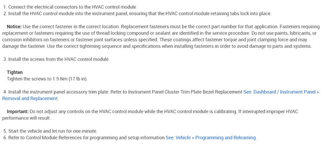

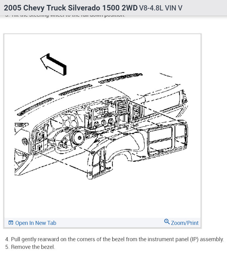

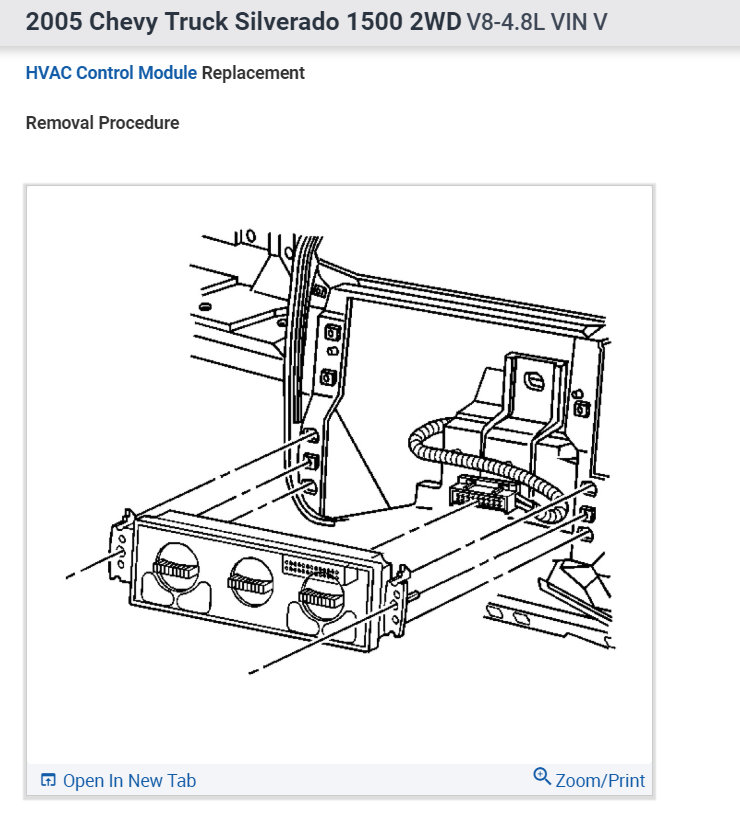

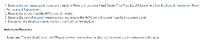

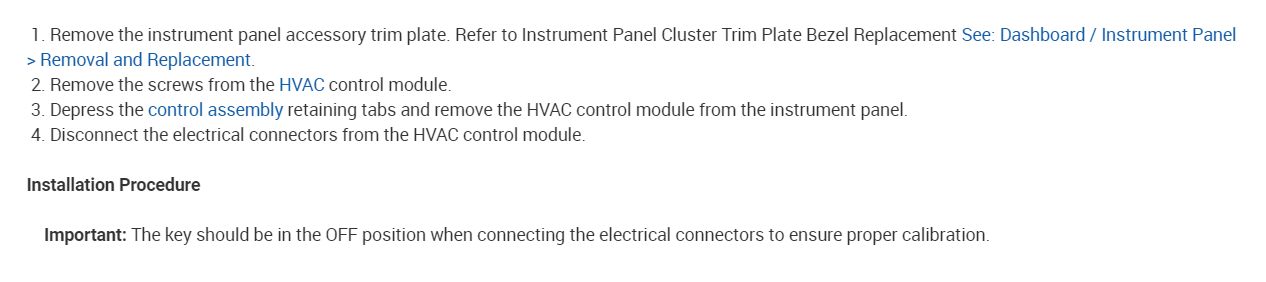

Okay cool, that does sounds like a HVAC controller has gone bad. here are instructions to change it out in the diagrams below. Please let us know what you find.
Aug 5, 2019 at 2:05 AM
