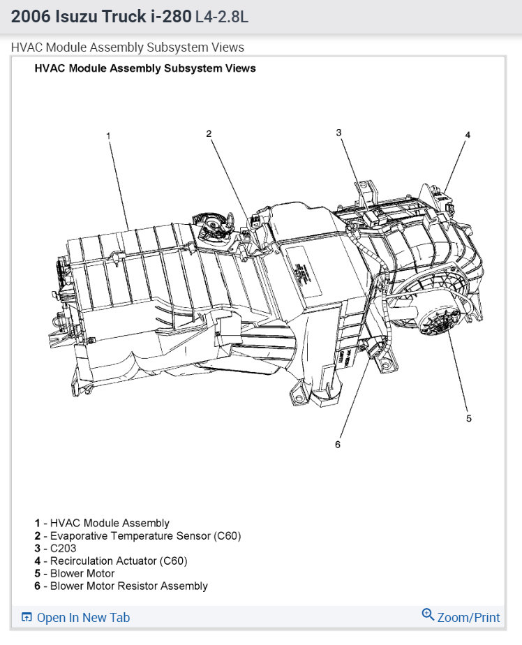

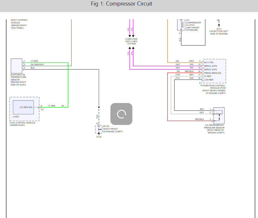

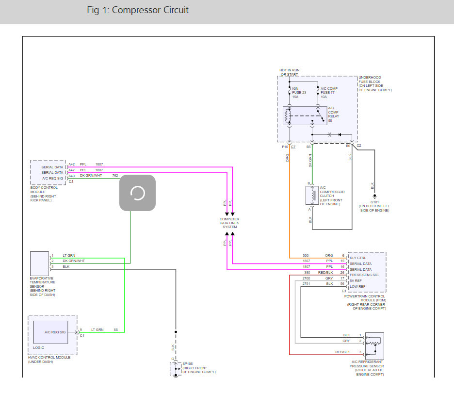

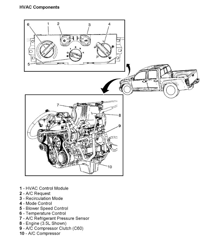

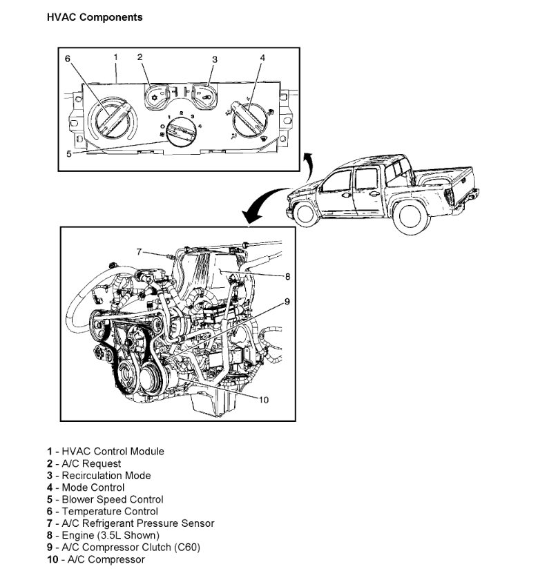

I took my vehicle in for an air conditioner re-gas and still it couldn’t work. Upon checking the wiring including the condenser, relay and fuse, everything was fine. The challenge was to find the location of the high and/or low pressure sensors in the car. Can you perhaps advise where I could find it? Is it inside under the dash board or anywhere in the bonnet? Please advise.
Thanks!
Gilbert
Dec 14, 2019 at 3:38 PM
  • 55,421 POSTS
Here are the locations of the sensors and the compressor wiring diagrams so you can test for power and see how the system works:
