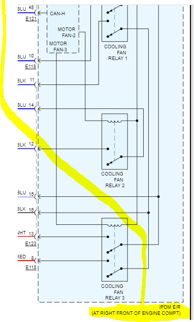

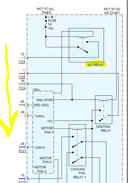

Where is A/C relay located and wire diagram.
Oct 19, 2022 at 3:59 PM
  • 110,248 POSTS
The compressor is located in the under-hood IPDM (intelligent power distribution module).
See the attached pics. Some of these are non-replaceable because they are part of a printed circuit board (PCB) and controlled by a CPU.
Let me know if this helps.
