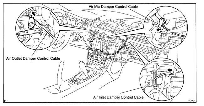

Center A/C vents not blowing air
2001 TOYOTA CELICA
188,000 MILES • 3.7L • 4 CYL • 2WD • AUTOMATIC
TONYA WILLOUGHBY
A/C works fine, but my center air vents don't blow air at all. Only outside vents work... Any ideas? Is it a fuse if so which one? Thanks for your time..
Aug 24, 2019 at 1:36 AM
  • 55,402 POSTS
This happens when the mode cable comes undone/stops working. here is a diagrams to help you see how it work and what to look for to fix it. Check out the diagrams (below). Please let us know what you find. We are interested to see what it is.
