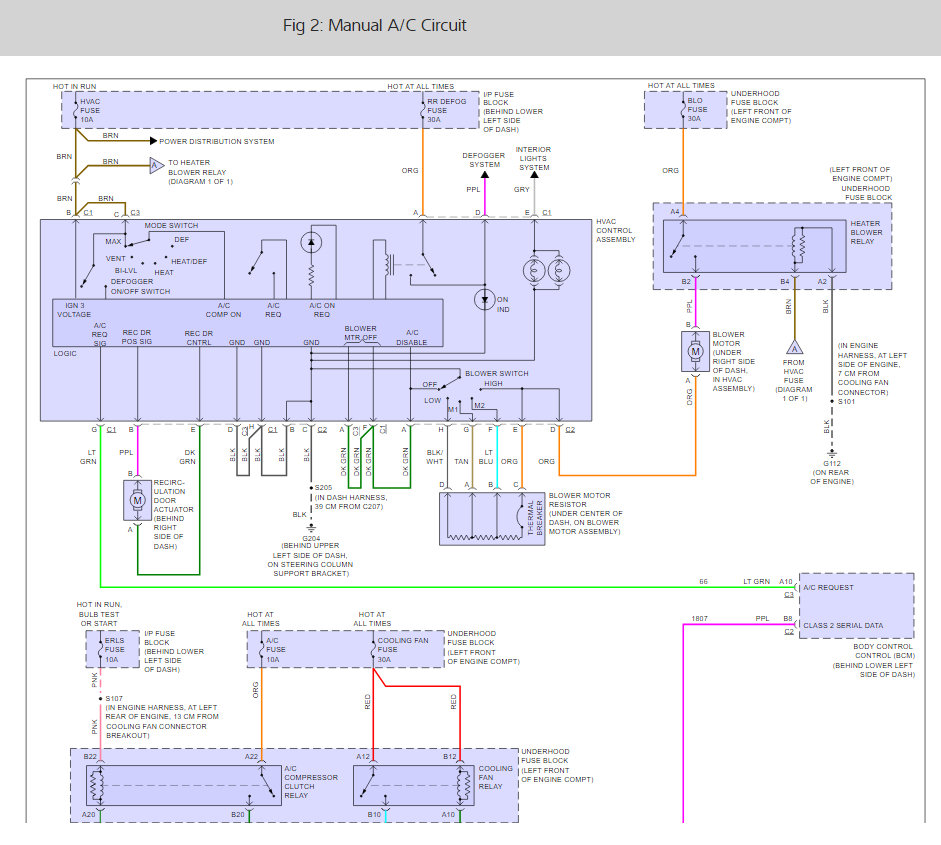

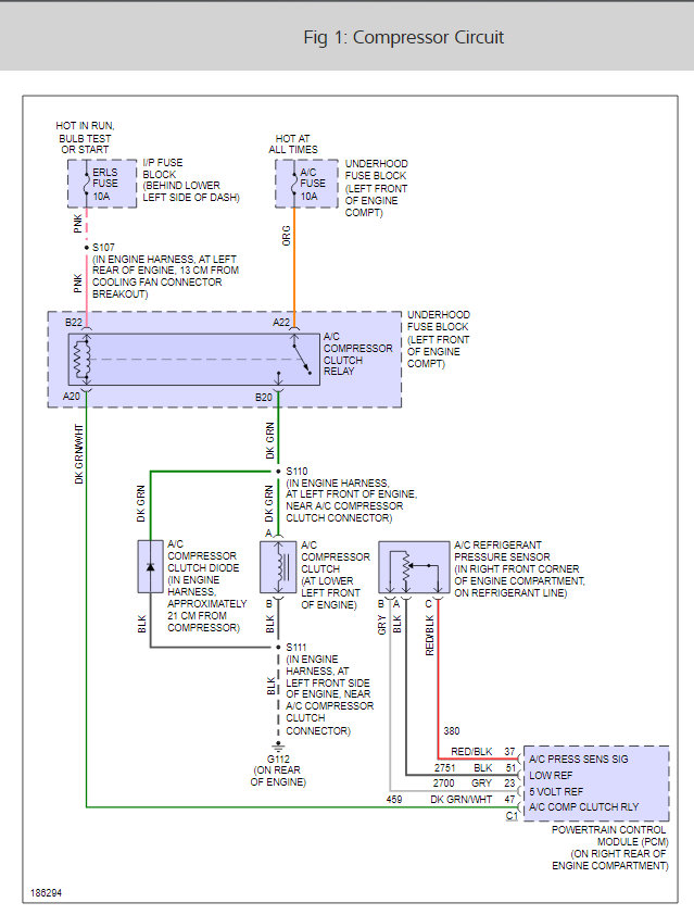

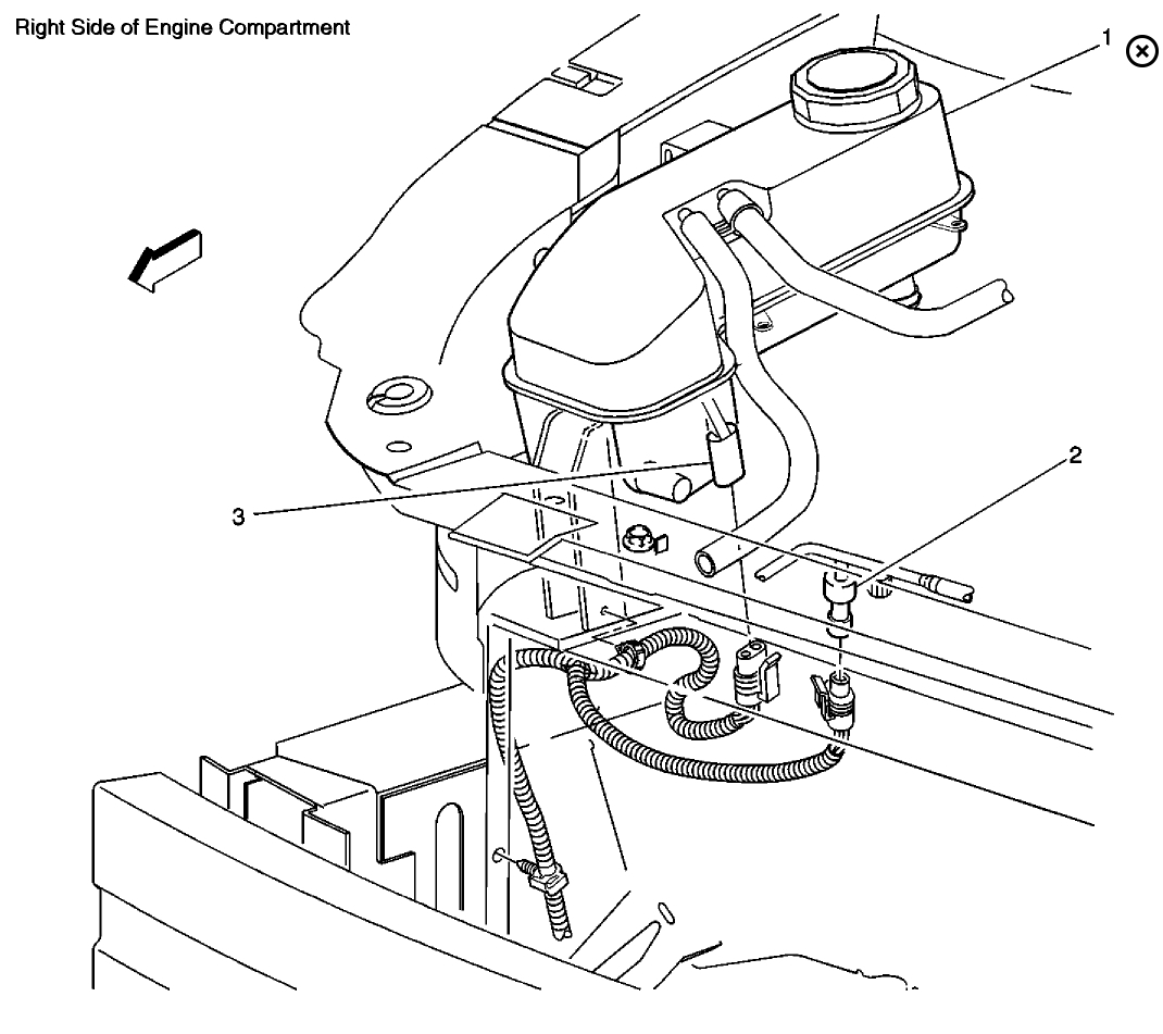

Charged with Freon. Relay will not turn clutch. Not getting signal to relay.
Jul 29, 2017 at 12:08 AM
  • 55,588 POSTS

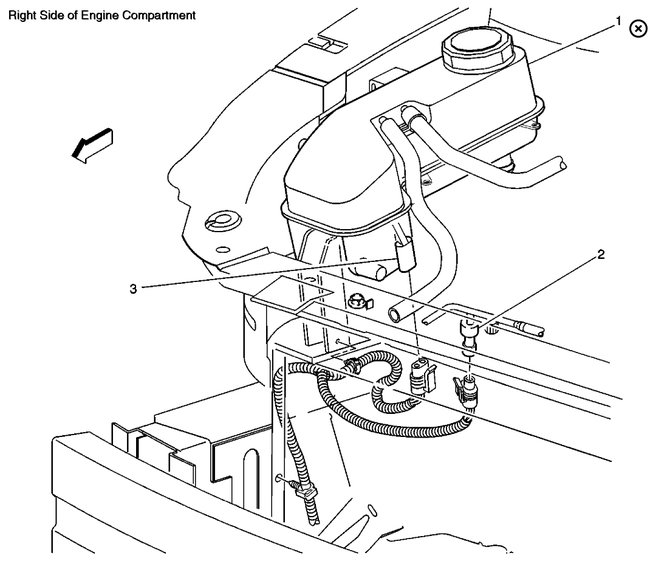

If the pressure is full and it is not getting a signal my first thing I would test is the pressure switch. The switch will connect when the pressure is correct. Jumper across the two wire connector and see if it has power as well.
Please let us know what happens, we are interested to see what it is.
Jul 29, 2017 at 7:17 AM
ELLEN NORD BOAHN
Pressure switch is fine. Not getting signal from switch inside car unless i straight wire it.
Jul 29, 2017 at 11:00 AM
  • 55,588 POSTS

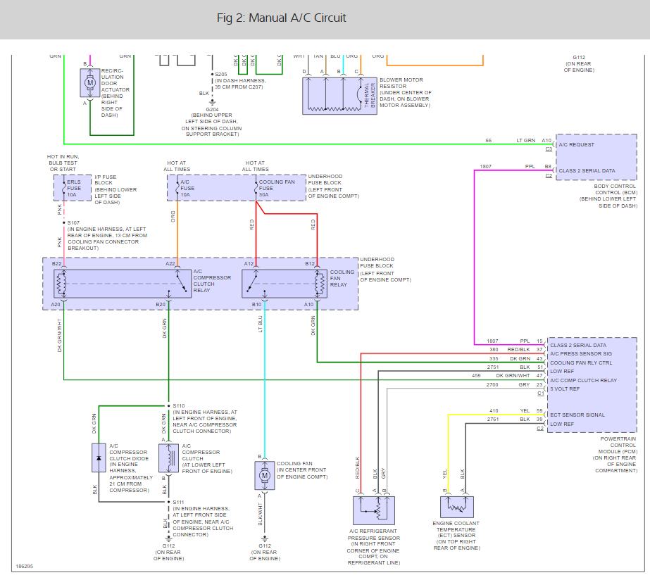

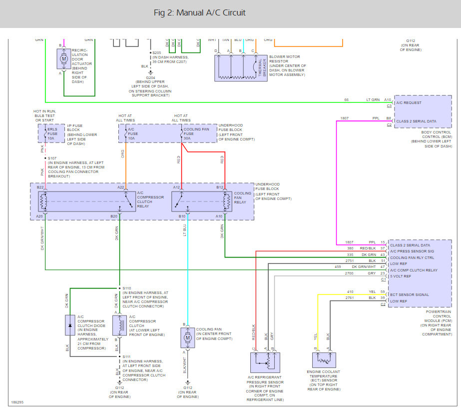

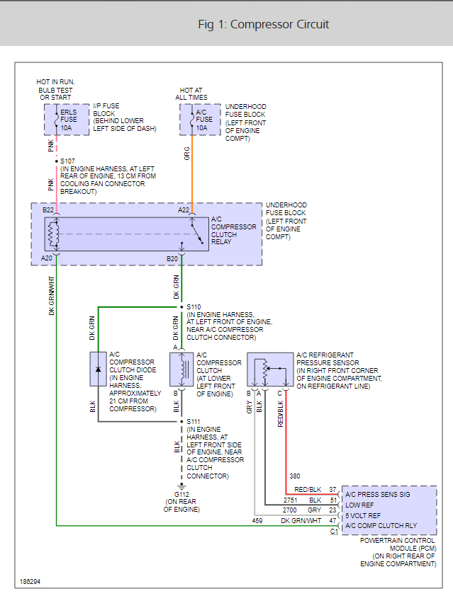

We must have a power failure or an open circuit somewhere or possible a bad fuse. Here are some diagrams (below) and some guides to help you, get some testing done.
and
Please run some tests and get back to us we are interested to see what it is.
