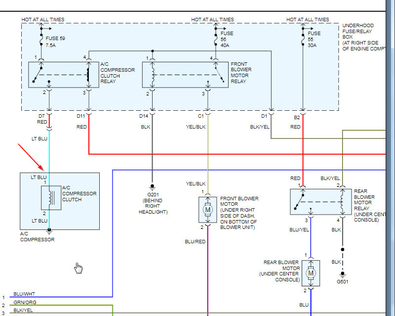

Next we need to check for power at the compressor when the engine is running and A/C is on. Just set your meter up first and then start the engine. Then monitor the voltage.
In order to have a compressor run, we need power to the compressor and proper Freon level in the system. If we have both of those and the compressor still does not run then I suspect the compressor is the issue.
