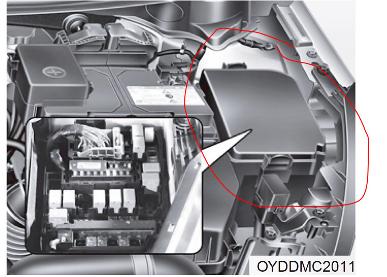

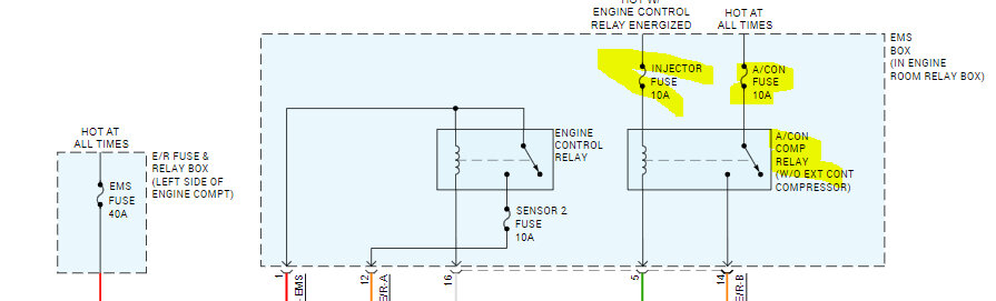

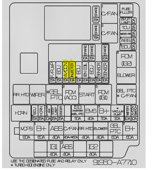

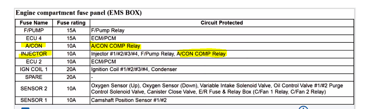

Thanks for the info. Take a look at pic 1 below. I need you to check both highlighted fuses first, in addition to checking the fuses, confirm there is power to and from them.
Here is a link that you may find helpful:
If they check good, switch the compressor relay with a different one in the fuse box having the same part number. If there isn't one, here is a link that explains how to check the relay and circuit:
Let me know what you find.
