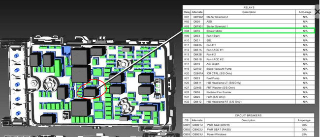

The air in my car works fine in the mornings but in the afternoon when I start the car it doesn’t come on at all. If I roll the windows down a bit and drive on the freeway it blows just a little but not enough. If the car stops it goes off. What could this be? I stopped at a dealer and they thought that I might need to replace the radio/screen control system at $2,000.00 yikes!! Could there be a cheaper solution?

When you open a window, chances are you are just feeling air naturally flow through the system. The problem seems related to the blower motor. Since it does turn on at times, then it isn't a fuse issue. At this point, we need to determine if power is making it to the blower motor when it refuses to turn on.
First, locate the blower motor relay in the under hood power distribution box. See pic 1. See if there is another relay with the same part number and switch them to see if that makes a difference.

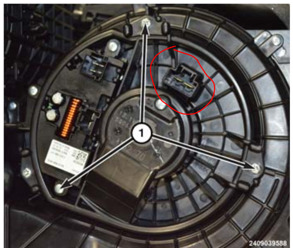

Next, on the bottom of the blower motor is a power module. You will need to disconnect the connector I have in pic 2 and check to see if there is power to the motor when you turn the blower motor on.
If there is power, suspect a bad blower motor. If there is no power, then I suspect the power
module may be bad.
