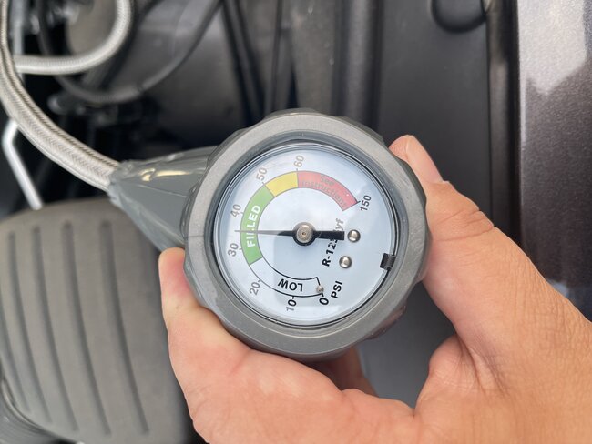

JLAR12
  • 6 POSTS
I hooked up the gauge and it seems to be okay. (See photo)
Aug 9, 2023 at 9:45 AM
  • 55,395 POSTS
You need to see the high-side pressure, but I would give a little more to be closer to the top of the green area. Please let me know.
Aug 10, 2023 at 3:43 AM
