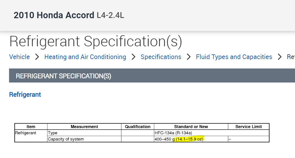

My gauge hoses were not good. I took it to my friends shop he evacuated and filled the system. It held vacuum and feels cold now. I have one question. I've read the car takes 19 oz of freon. Sticker under the hood says 15.9. At this time we went with the sticker under the hood. Can you tell me if there was an update about the freon capacity for my vehicle. Thanks again for all your help and have a great day. Neil
Quick update, I did check the service manual 450 grams= 15.9 oz

Yep, it takes R134a and holds between 14.1 and 15.9 oz. So, you nailed it. (see pic below)
I'm glad to know you got it taken care of. Take care, keep cool, and feel free to come back anytime in the future.
