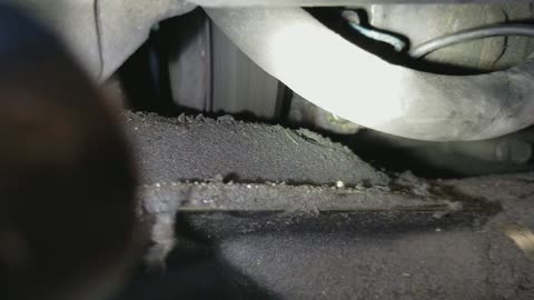

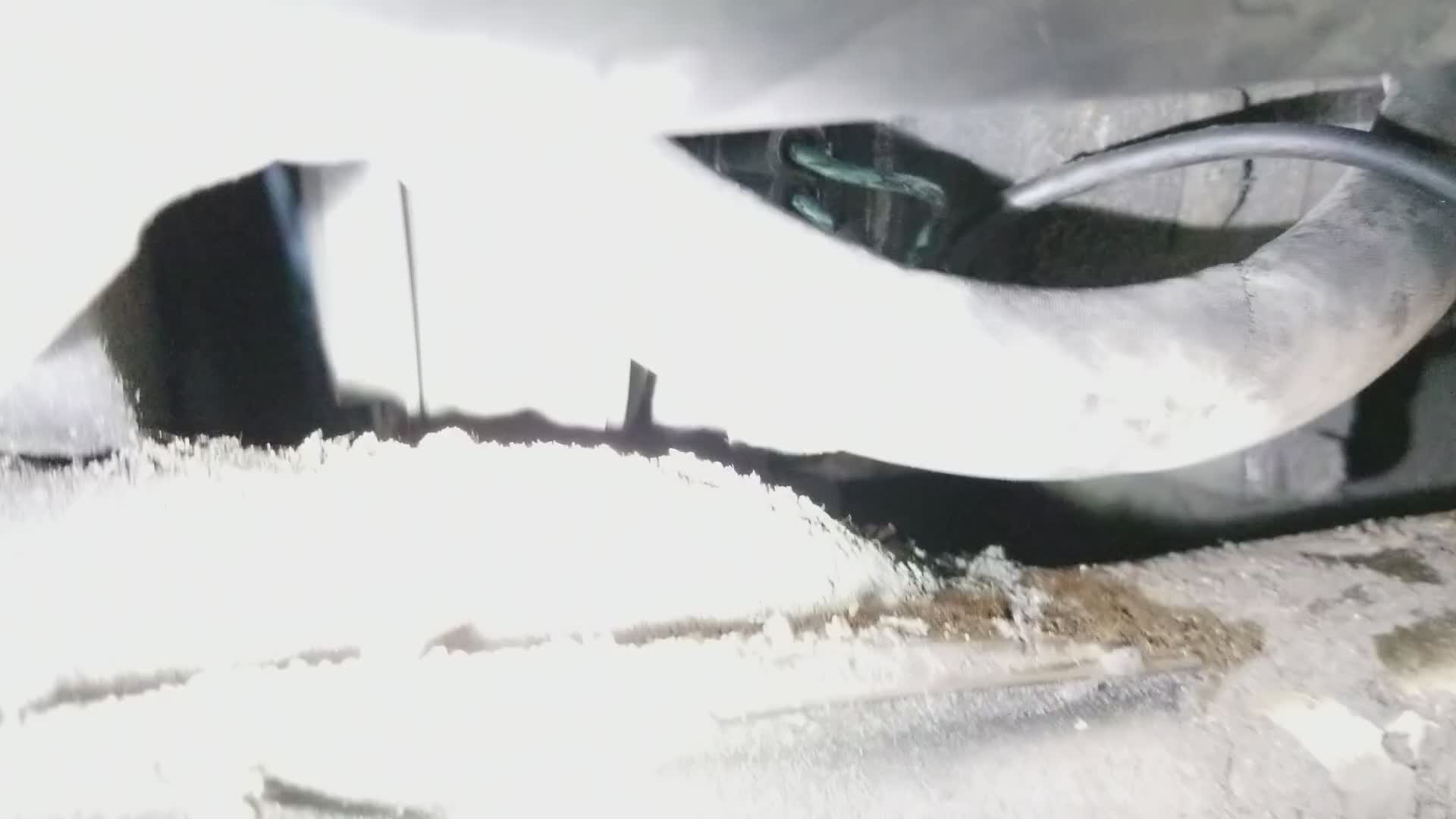

So my A/C is going in and out. I condenser motor was not working so i replaced it. so now that works but compressor clicks on and off. When I turn on my car it works fine and blows cold air for about five to ten minutes. then when it idles it stops blowing cold and and compressor clicks in and out. I have checked the relays and they work fine. The condenser fan works fine (now) I do not have much money so I cannot keep replacing stuff and its not the issue. Please help me.

Get a gauge and check the R134A charge level. It looks like it is low on charge. Being an 2003 it may have just leaked out over time through the compressor shaft seal or it could have a larger leak. But starting with a pressure check is the first step.

So i took it to a friend's friend shop and the guy check it right and my pressure was way too high on the high side and was jumping almost to 200. so he vacuumed it out so i can replace everything. He said wait let me refill it just to check so he did and re let the car run for about thirty minutes and everything was fine. Everything stayed exactly were it should and pressure was great. He said I probably messed up and put the can stuff before I changed my condenser fan. He said it would have just changed the fan first everything would have been good. Well thanks for the help guys.

Yeah, high pressure would do it as well Then the compressor will shut off to protect the rest of the system. That's why you always check the pressures first.
