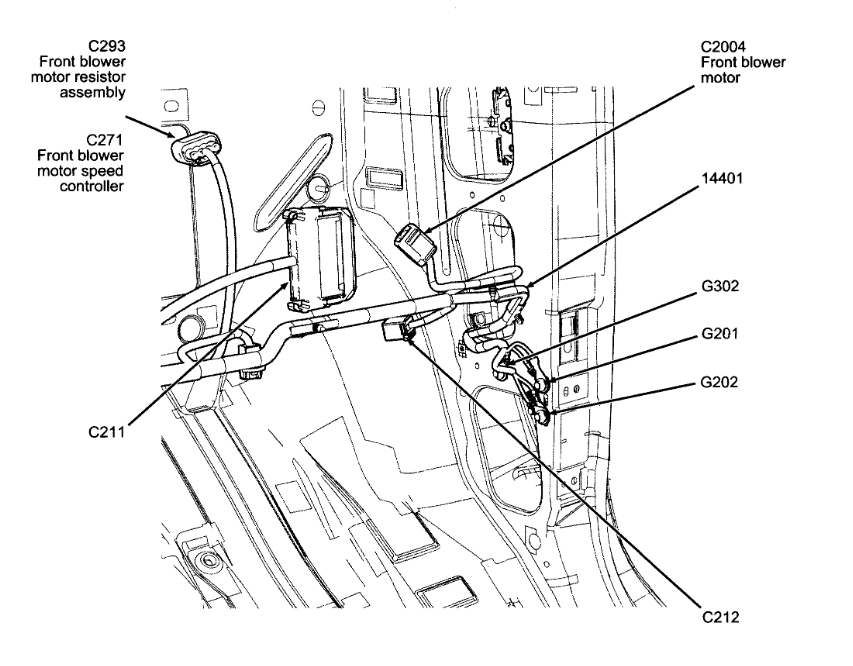

My fan blows on low on all the settings except 3 and even then, it does not blow wide open. I checked all fuses, the fan motor and still nothing seems to work.
Jul 1, 2022 at 1:59 AM
SQM
  • 6,383 POSTS

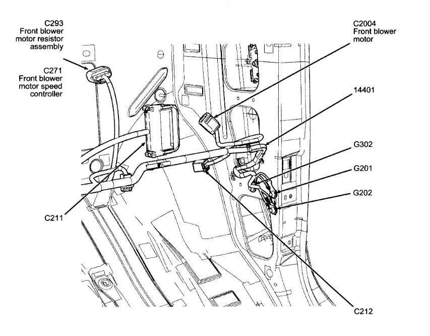

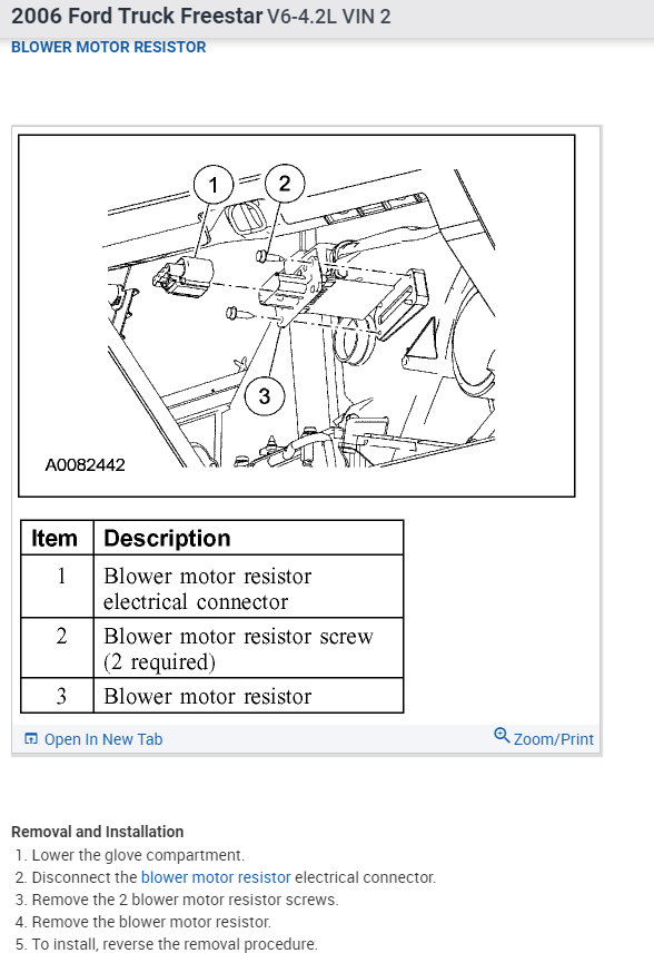

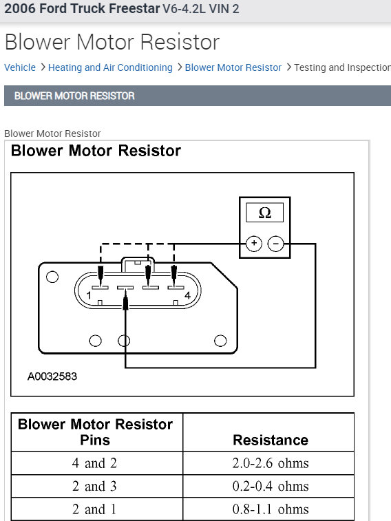

This could be due to a faulty blower motor resistor. Many times when these resistors go bad it will only allow one speed of fan.
The resistor is located under the passenger side dash.
https://www.2carpros.com/articles/blower-fan-motor-works-on-high-speed-only
I have attached diagrams below for your reference, also included the test procedure for the resistor.
Let me know of any questions.
