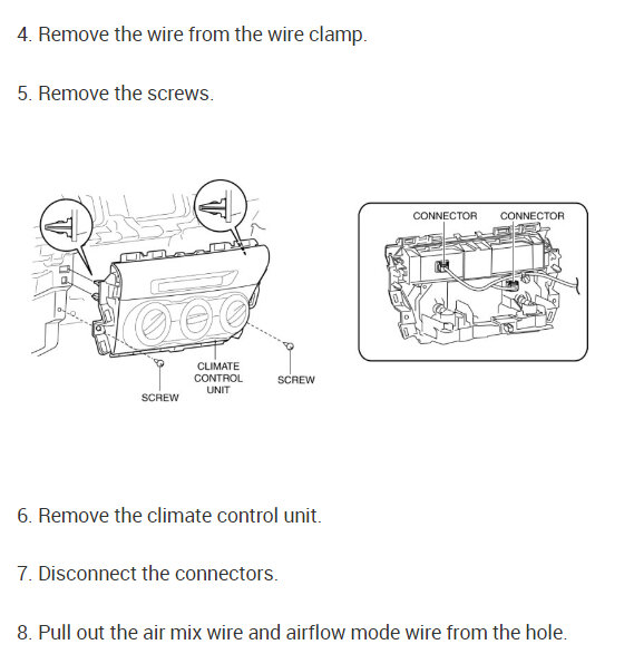

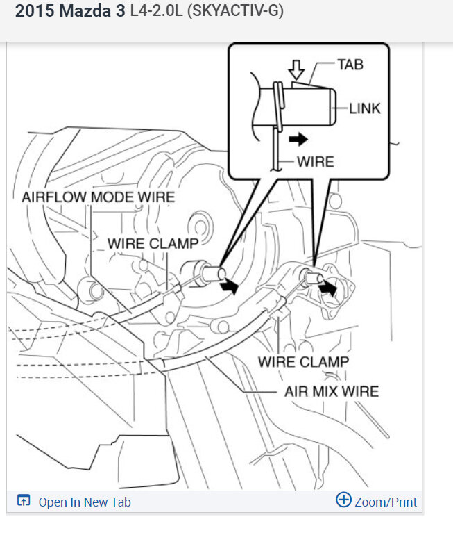

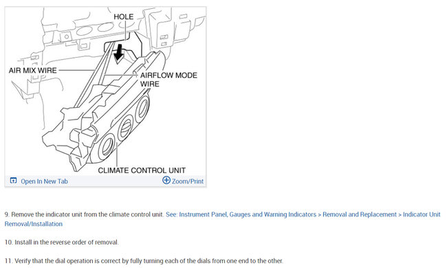

When I try to turn the A/C to max cool it stops halfway with heavy resistance but when I try the same for max heat it works fine. Same with the other two dials. The airflow and temperature works fine as I get both cold and heat.
Sep 27, 2024 at 7:43 AM
  • 55,694 POSTS

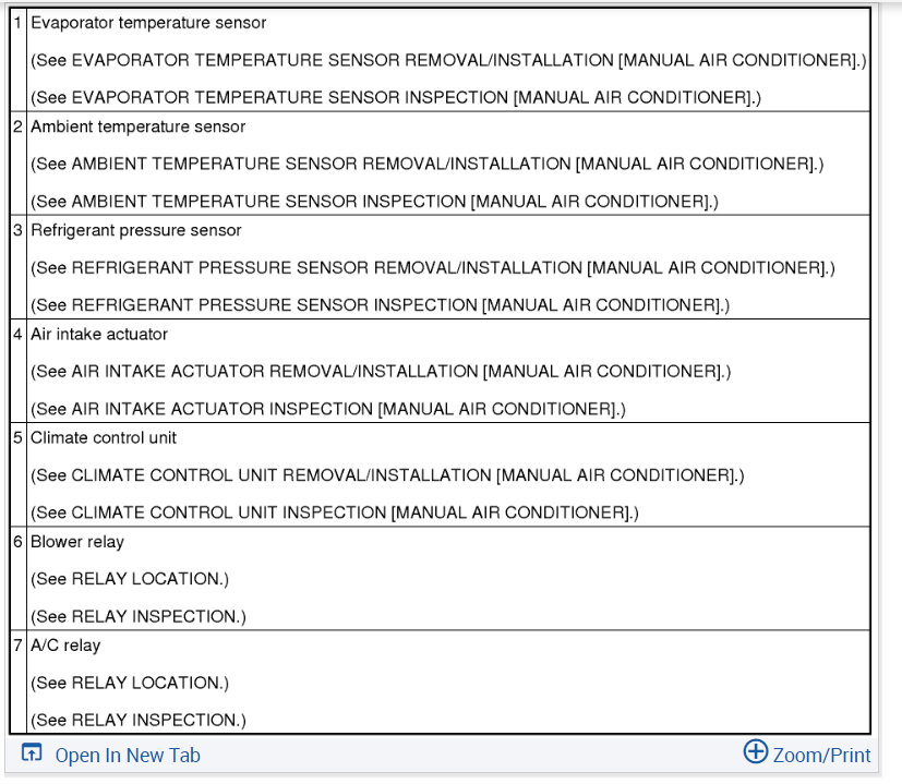

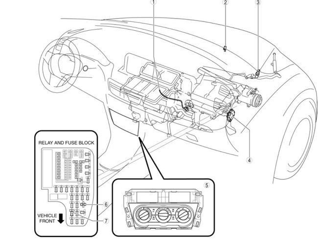

This sounds like a mechanical problem like cable issue here is how the system works, you may need to lubricate the cable or it might be weak and got bent or just worn out. Here is how to see what going on. Check out the images (below). Please upload pictures or videos in your response of any problems so we can see what to help you with.
