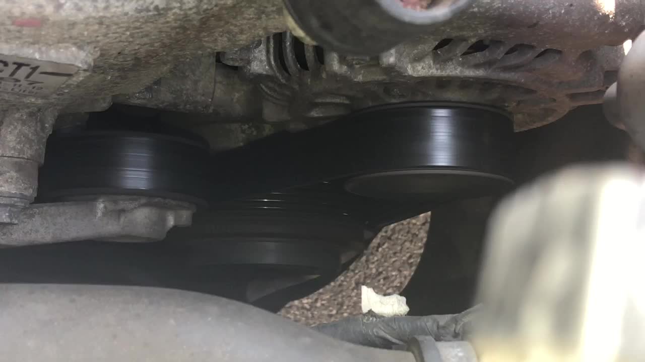

I was trying to troubleshoot why my A/C is blowing hot and was going to try adding Freon. I bought the one with the gauge but the low side reading is above 150 psi. Is my next step doing the vacuum and new refrigerant or is there smaller steps in between I can try/look for? Thanks!

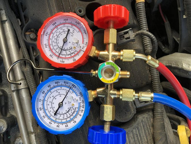

The gauges for the high and low both read 120 psi.
Thanks in advance for any insight!
Jul 3, 2019 at 6:23 PM
RICHARDINNC
  • 10 POSTS
This was with the car off and in about 90 degree weather.

Okay, those are both good static pressure readings. What do you get when the system is running?

Same thing. No cold air though.

I'm sorry. I wasn't clear. What are the pressure readings when the system is running?

They were the same.

If the pressures were the same both static pressure, and with the system running, and the compressor clutch was engaged, the compressor is most likely the problem. If there is no change, it isn't working. You are certain that the clutch is engaging, correct?

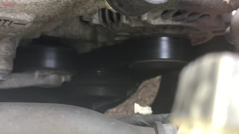

I took a video. I don’t know a whole lot but I think the clutch is engaging. The pressures on high and low are both 100 psi static and running. I just took this now in 89 degrees.

It's hard to tell in the video because of the angle I'm seeing it from. Try this. Have a helper in the vehicle with the AC off. Have the helper start the engine (AC off). While you are watching the compressor, have them turn the AC on. You should hear a click and the center of the pulley should start spinning.

Yes it clicks and starts spinning!

Since it is engaging and there is no change in pressure, the compressor is bad. I wish I had better news.

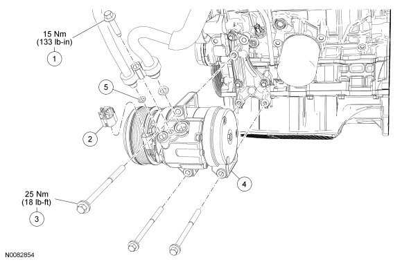

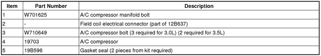

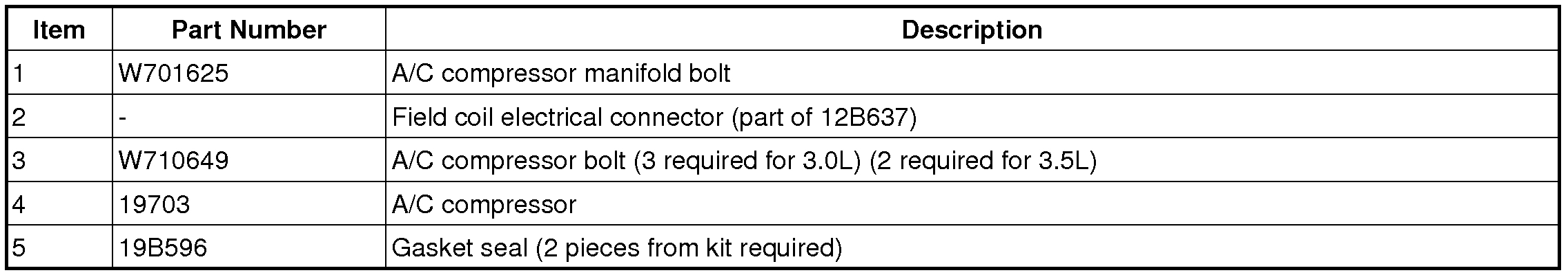

Here are the directions specific to your vehicle. The attached pictures correlate with the directions.

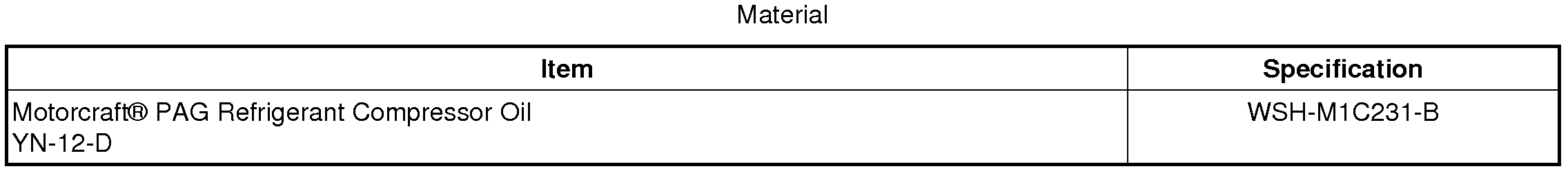

NOTICE: Use only the Air Conditioning (A/C) refrigerant compressor oil specified for this vehicle configuration. Use of any A/C refrigerant compressor oil other than what is specified will contaminate and damage the A/C system.

1. If flushing of the A/C system has not been carried out, recover the refrigerant.
2. With the vehicle in NEUTRAL, position it on a hoist. For additional information, refer to Vehicle Jacking and Lifting. See: Vehicle Lifting > Procedures > Jacking and Lifting
3. Remove the lower engine splash shield (if equipped).
4. Remove the drive belt from the A/C compressor pulley.
5. Remove the A/C compressor manifold bolt.
- Discard the gasket seals.
- To install, tighten to 15 Nm (133 lb-in).
6. Disconnect the field coil electrical connector.
3.0L vehicles
7. Remove the 3 A/C compressor bolts.
- To install, tighten to 25 Nm (18 lb-ft).
3.5L vehicles
8. Remove the 2 A/C compressor bolts.
9. Remove the A/C compressor stud.
1. Remove the A/C compressor nut.
2. Remove the A/C compressor stud.
- To install, tighten the stud to 9 Nm (80 lb-in).
- To install, tighten the nut to 25 Nm (18 lb-ft).
pic 4
All vehicles
10. Remove the A/C compressor.
11. To install, reverse the removal procedure.

- If filtering of the A/C system is not to be carried out, add the correct amount of clean PAG oil to the refrigerant system.
