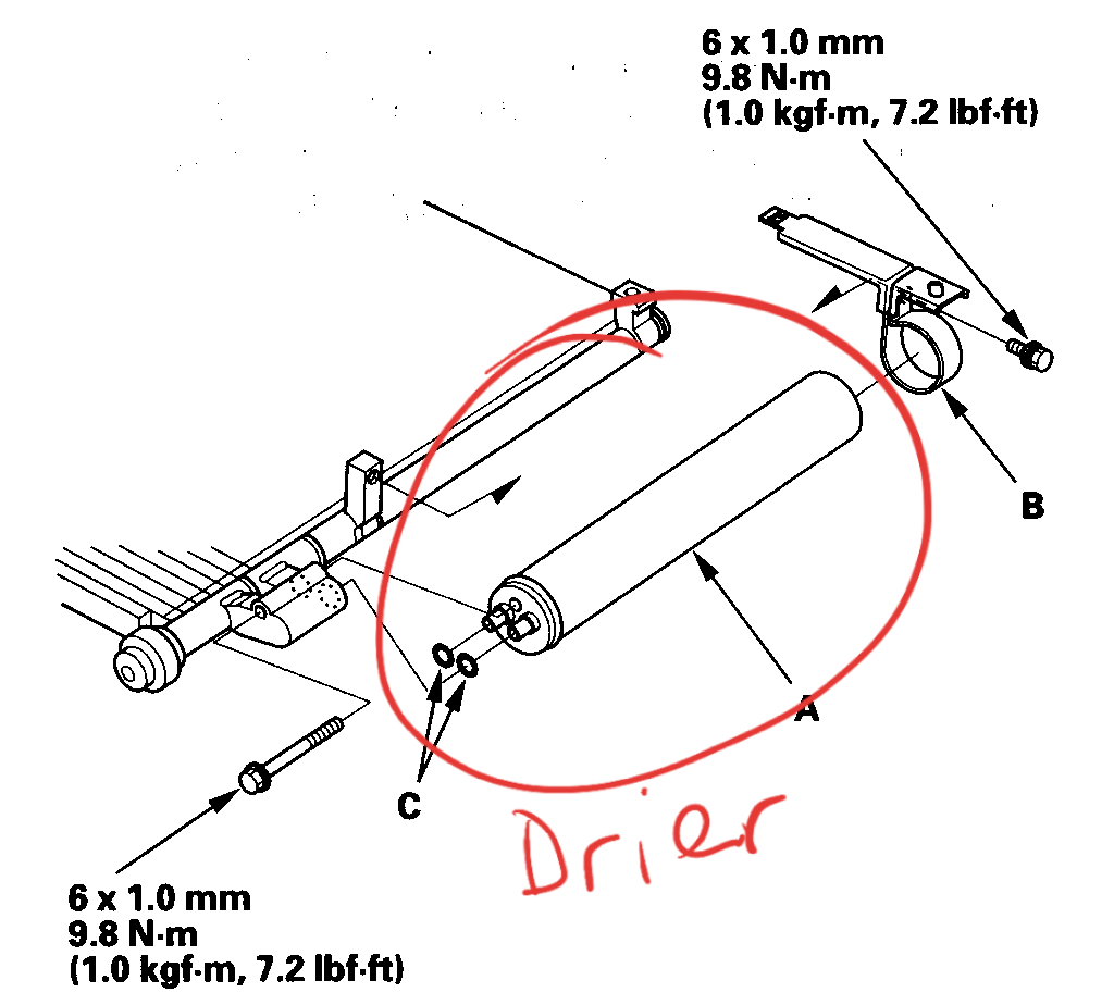

Hello, I appreciate your educated answers. I can ask the mechanic about checking the pressure to see if high and low are the same; which would indicate bad compressor. If that is the case then fine, I would need a new one. However, you introduced three new terms that I am going to have to ask you about. You say when compressor is failing the system needs to be flushed out (can you explain that please - unless it means removing the refrigerant) and replace the drier (first term I am not sure what it is). Is the drier part of the compressor or is it somewhere else in the engine?
Then you said a bag (term number 2) can be replaced - I am not sure what a bag is. In relation to an air conditioner. Then you talk about replacing the condensor (third term) to save some money. I think the condensor is the thing up near the radiator but please let me know for sure. I am not sure how the condenser relates to the air compressor if it is bad and how replacing it would help. I guess that is a cheaper fix than the air compressor if high and low are NOT the same pressure. Lastly I don't know if I mentioned that a few years ago I hit some animal on the highway and had to have the condenser (the thing up front by the radiator replaced). So I am wondering if that condenser was not very good to begin with. My A/C hasn't worked very well since the accident I don't think.

Hello and welcome back. When the compressor starts to fail the inside starts to break apart which introduces metal contaminants. When you replace the compressor for failure you will need to flush out the system of contaminants and replace the drier (filter). Most Japanese automotives have that filter in the condensor which can be serviced separately or you can replace the condensor assembly which comes with a new filter inside (the bag). But double checking the image I sent it looks like you can just replace the drier since it is outside the condensor.
I hope this clarified the answer and if you have any other questions about this repair do not hesitate to ask. Also to make a note, when replacing a compressor in order to have a warranty they will want you to replace the drier since the majority of the metal contaminants gets captured there. Not doing so will introduce that metal back into the system and cause the compressor to fail prematurely.
