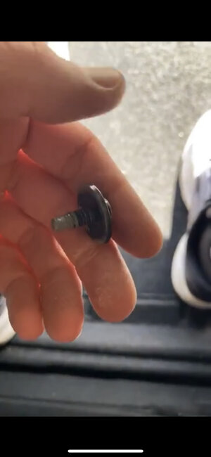

I was rear ended and had to have about $10,000 worth of repairs to my brand-new car, after having a rental car for a month and a half, I finally got my car back. Unfortunately, the air conditioning is not working and one of my subwoofers is making a popping sound.
Specifically, the temperatures its set to vary between vents, the driver's side, middle and passenger vents blow different temperatures. Drivers side is coolest, the middle is warmer, the passenger's side is warmest. Regardless, the cool air on the driver's side is not the temperature it says it is. The cooling fan is working, and the coolant level is not low. I am very upset about this because they had my car for a very long time, and to have it returned with new problems is just not acceptable. I have tried taking the negative off the battery to reset it, but it did nothing.
As far as the popping sound on the subwoofer, what would this be? Only one side does this.
This is a new car, so there is not any wear and tear that can explain this. Lastly, I know very little about cars but I’m a fast learner.

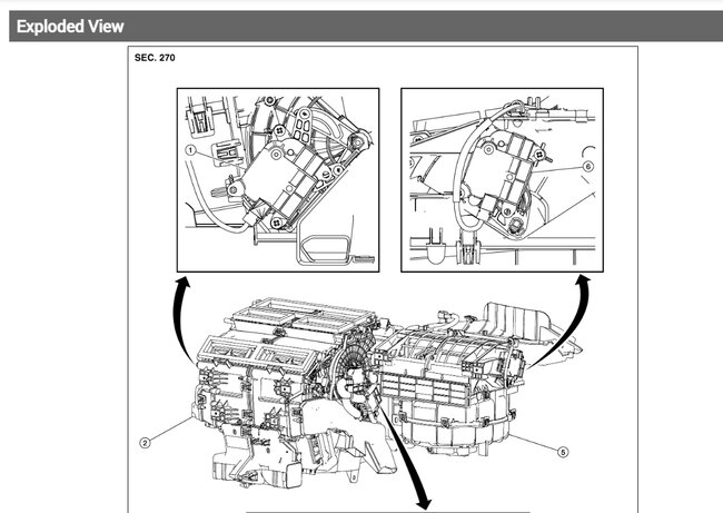

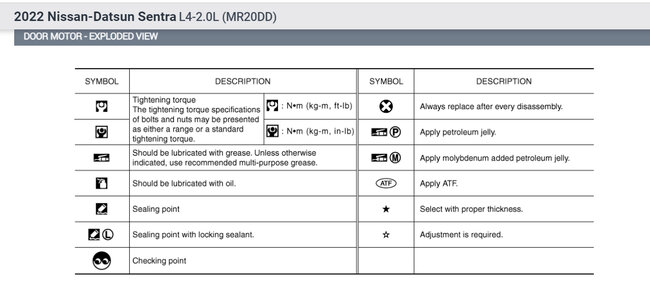

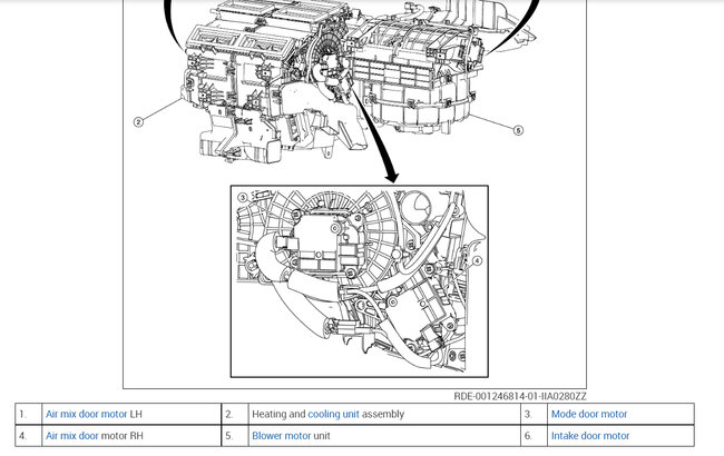

First, I would check the ground wires for the subwoofer because it sounds like one has been left off during the repair. Next, it sounds like the mode door actuator is broken, does the air change when you go from heater to air conditioner to defrost? If not, this will be the mode actuator failure. Here is the location of the actuators so you can see if they work when you make changes, you can feel them move if you put your hands on them. Check out the images (below). Let us know what happens and please upload pictures or videos of the problem.

Also, popping was a bad word to describe the subwoofer. It's like a rattling sound, but its mounted in my car and not easy to get apart.

Yes, here is the sub noise, now that I listen to it on video it sounds like rattling.
As for the actuator, am I able to see this without taking off my dashboard?
Oct 17, 2022 at 6:26 AM
  • 55,267 POSTS
Thanks for the video. That sounds like a connection problem, or the subwoofer is bad. You should be able to reach the actuators. If not, you may need to remove the bottom panel or glove box door.

I can see all of them moving except the one in the back, nothing back there is moving when I press anything. I also hear a clicking sound coming from somewhere when I turn the air on and off.
Oct 23, 2022 at 3:50 AM
JAKE8771
  • 11 POSTS
Just kidding, there is some movement but not much. According to what you posted, the twitching back motor is the passenger side actuator.

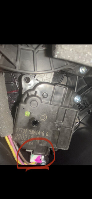

Oct 24, 2022 at 4:20 AM
JAKE8771
  • 11 POSTS
So, today the ambient temperature has been above 70 degrees and the air is working totally fine, I have noticed this lately. I unplugged the actuator where I circled, and the air continued to work normally.
When you say check the pivot, where exactly do you mean? The place where the white “arms” are moving or where the actuator attaches to the white arms?
Oct 24, 2022 at 4:52 AM

Thanks Ken. By the way, the sub was making that sound because the repair shop left a random screw sitting on the speaker. It works perfectly now.

Well, I was hoping I could fix this myself but I’m running out of time. I removed the actuator and looked inside. Replacements are shockingly expensive. The car is under warranty, but I was just hoping I could skip not having my car for who knows how long when they fix it.
Oct 26, 2022 at 1:22 AM
JAKE8771
  • 11 POSTS
Even when I turn the pivot myself this does not make the temperature stable, there is still a difference between sides.
