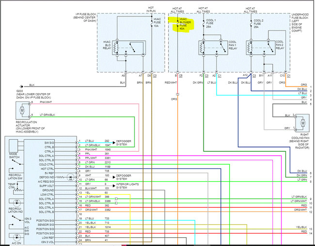

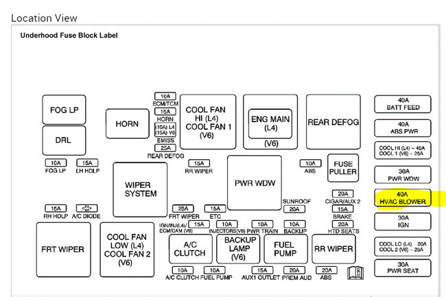

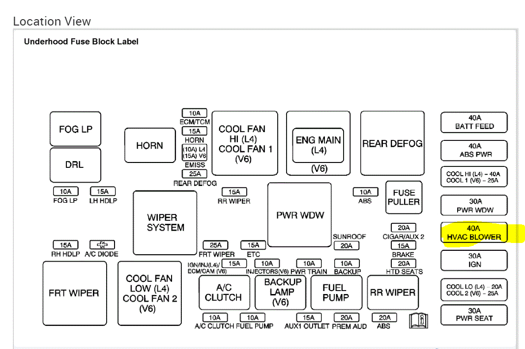

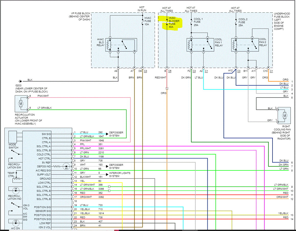

First, if you haven't, check the HVAC blower fuse under the hood. Confirm it is good and there is power to and from it. If you look at pic 3 below, I highlighted the fuse to check.

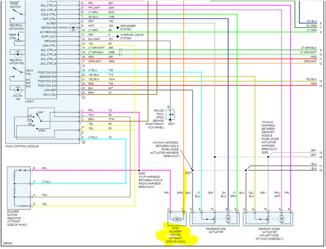

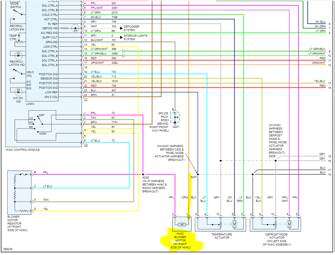

Now, if that fuses is good, either the blower motor is bad, or the blower motor resistor has failed. So, I need you to go to the blower motor under the dash on the passenger side. At the motor, there will be a plug with two wires. One of the wires is orange. Check to see if that wire has 12v.
If it does, use a jumper wire at the purple wire and run it to any grounding location. The fan should turn on at high speed. If that doesn't happen, the motor is bad.
Pics 1 and 2 are the wiring schematic for the blower motor. I'm attaching it for your reference.
Let me know what you find or if you have questions.
