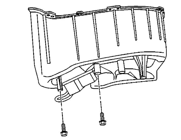

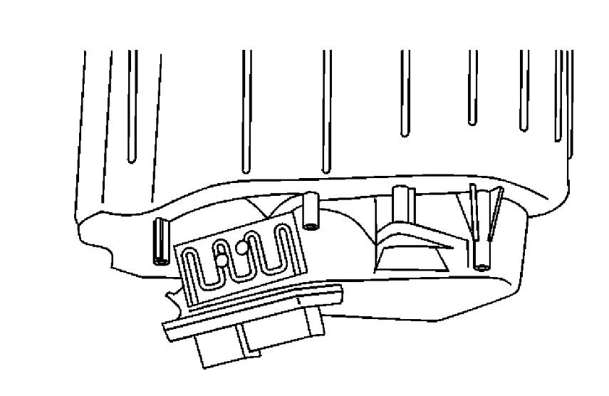

The air inside the truck won’t turn off even if you take out the keys. air is on high and won’t turn off unless you disconnect the battery.
Feb 26, 2019 at 11:11 AM
Good morning,
It sounds like you have a blower resistor shorted to power and will not stop the blower motor.
It is under the passenger side of the dash right next to the blower motor.
