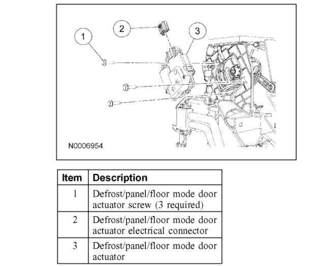

AC blows warm air when stopped.
So it is winter now and no AC running, i feel warm air on my legs when the AC and system is not on, no blower. I read the article on blend door replacement, took mine apart and it is working.
Are there other actuators that might cause warm air to be coming in?

no the blower works, i meant i can feel warm air coming from the under the dash, even when nothing is on. there is cool air when the AC is on, but when i stop at a red light it blows warm air. I had the AC Freon checked last fall and the mechanic said the Freon levels were okay. recommended a new compressor, since it is winter and I have not been running the air. the other day i felt warm air coming from under the dash.
so my question thinking, are there other blend doors that might be stuck open letting in warm air from the heater part of the system?

As far as the modes. there is a mode door actuator that controls the direction of flow.

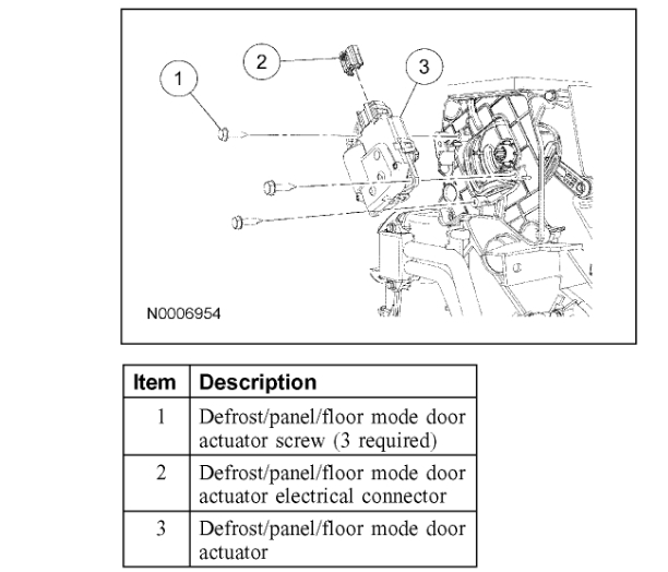

Okay, got a diagram of the mode door actuator. It is under the left side of the dash above the gas pedal toward the center.
