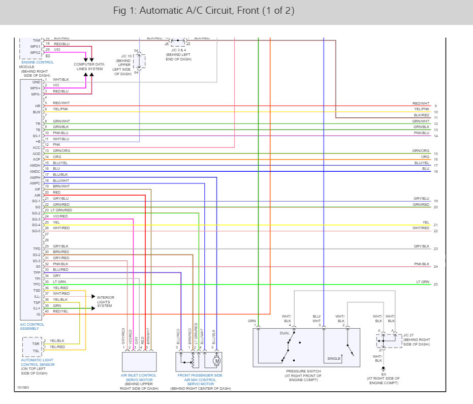

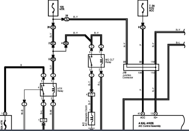

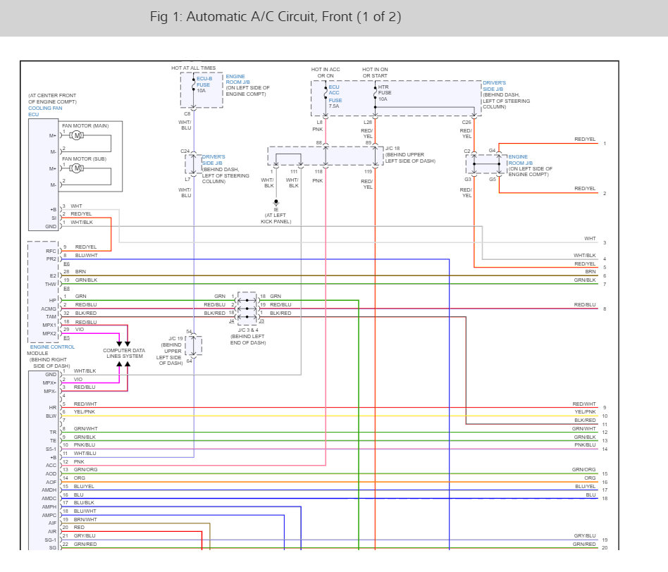

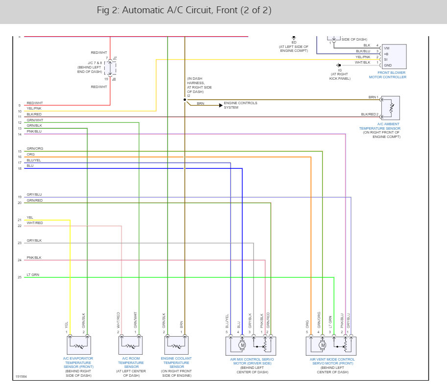

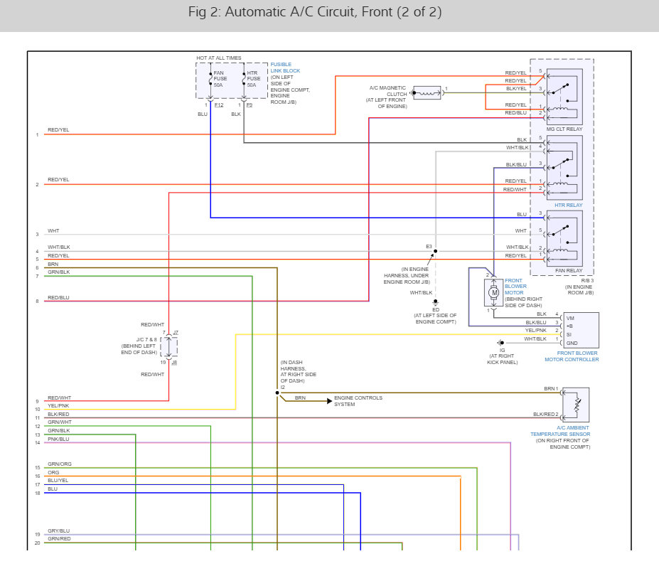

It sounds like the compressor is defective but to be sure lets test for power at the compressor. This guide will show you how wit the AC wiring diagrams below so you can see how the system works. Also check all fuses

did you check for power at the compressor?? check the 10 amp heater fuse in the fuse block.
