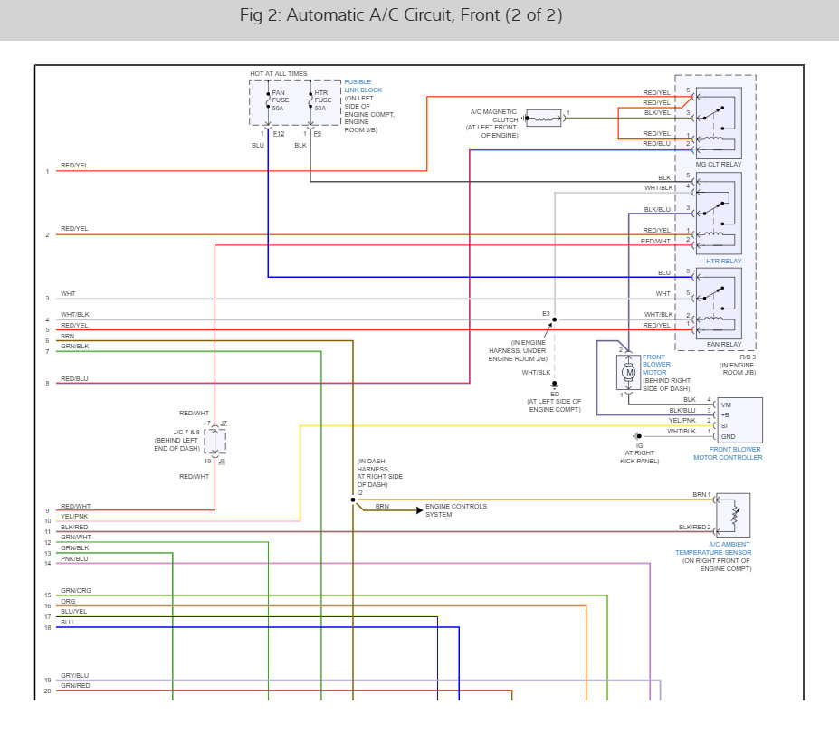

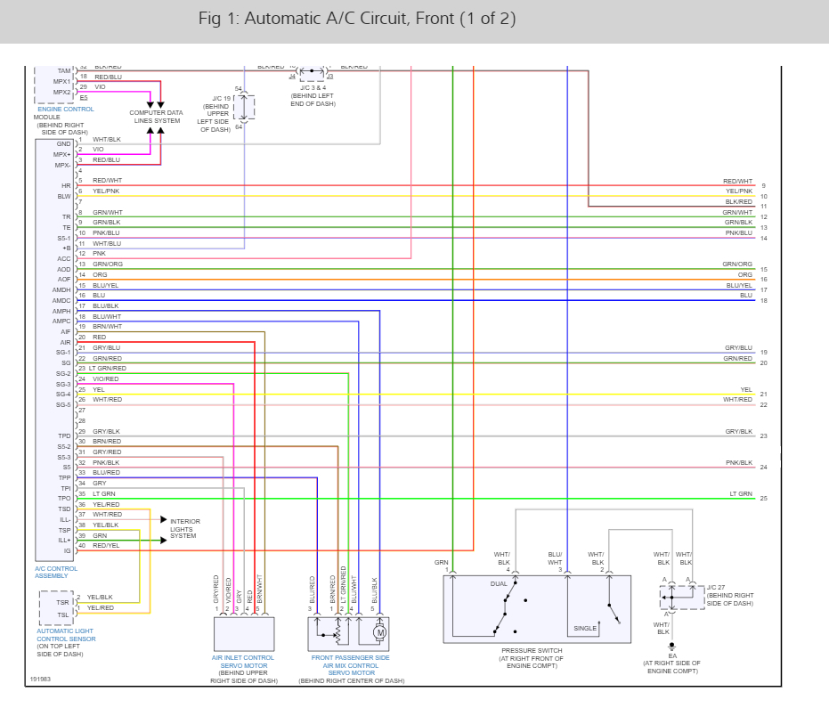

I have replaced the compressor but it still will not kick on to pull in the Freon to make it blow cold. fuses look good. what could be causing the new compressor to not kick on like the old one did?

It sounds like the compressor is defective but to be sure lets test for power at the compressor. This guide will show you how wit the AC wiring diagrams below so you can see how the system works. Also check all fuses

I have replaced the compressor, the resistor switch. all fuses and relays good. compressor holding 70-80 pressure but yet the compressor still will not kick on. cleaned out air flow and sensor replaced but still will not kick on. i am at out of ideas. please help.

Did you check the fuses to be sure there is no blown fuse??

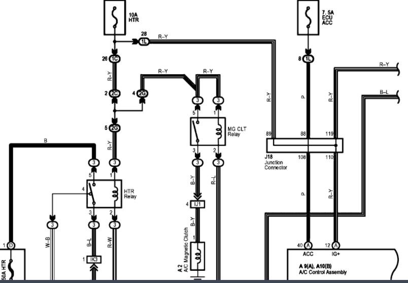

did you check for power at the compressor?? check the 10 amp heater fuse in the fuse block.
