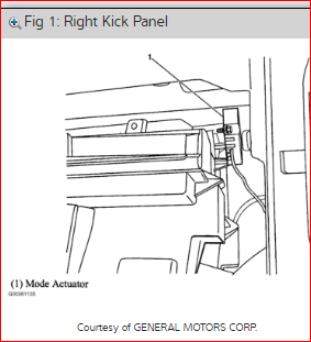

Hot air blowing in driver side air conditioner.

Question. Just blowing hot air on driver side? What is the temperature like in the rest of the vents?

Passenger side is cold.

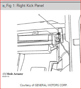

It sounds like you are having a problem with the mode actuator in your A/C system. It is an electric motor that moves doors around inside the heater/A/C box to route airflow through the air ducts.The mode actuator is located on the HVAC box under the dashboard on the passenger side. I have attached a tutorial to make you familiar of the repair and a picture of the mode actuator. Hope this helps and let me know if you have any further questions. Danny-
